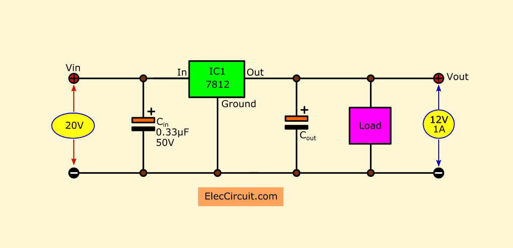

I would use a 7812 instead of the zener... It's not much different in cost and it'll just work better.
