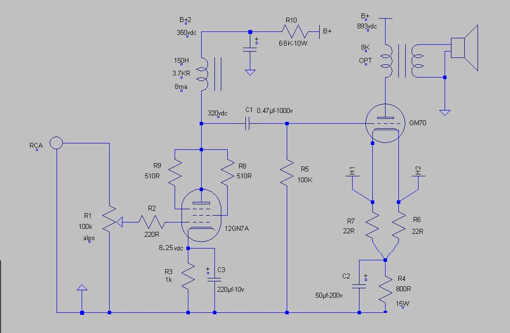

Can I use 1.1 instead of .47
Would these work??? I assume I would need higher than the B+ voltage (Gut feel only).

These are quite good caps (AVX brand, these caps are manufactured for industrial use) . If your driver stage runs at B++ of 350V DC and the cap is used to couple the driver to the (ground referenced) grid of the output tube, the cap will see 350V DC max. So your 1000V rating is more than safe.
Here is the schematic I am using. I don't know if it is a Ground Referenced grid. I can build anything but don't understand the lingo very well....sorry.
PS, I now see the final B+ is 841v

Yes, the grid of the GM70 is referenced to ground via R5. As the B+2 of 350 V DC is derived from the B+, you need a 1000V capacitor. During start up when all filaments are cold the full B+ of more than 800V may appear on the capacitor. It is also very important that the HT is coming up slowly to ensure that the GM70 filaments are fully heated up before the HT starts rising. Otherwise there would be an overshoot on the HT rising up well above 1000V. With the damper diodes as rectifiers you should be safe (the dampers heat up very slowly leading to a very smooth rising of the HT)
THanks guys. Yes, the warm up time on the 6D22S is 30 seconds. I just noticed I have not included the B++ leg on the PSU Designer II graphic. I have to figure that out....which I "think" will cause some heat build up somewhere to reduce the Vs from 841v to 350v.
I'm a bit worried about the high voltage aspect of the design since you are a bit inexperienced. Do you understand the hazards involved? At 900V you are entering the realm of corona discharge and other random discharge phenomena. Insulation requirements are much greater at these voltages than for an amplifier operating at 400V..
How do you plan to trouble shoot in the event it does not work correctly, how will you measure the HV plate supply or will you? Are you equipped to measure things safely and understand how to do that?
What sort of components have you selected for the HV supply, and have you chosen an output transformer that is rated for continuous operation with combined 1500Vdc + Vac? (The driver will not provide sufficient grid current to get you more than about 1kVpp swing)
Sorry for all the questions, I just want to make sure you get to enjoy the amps beyond the first moments you turn them on to start troubleshooting.
I strongly recommend you not do this, and use a second transformer instead and associated supply, it's much safer and will allow for some basic trouble shooting without the high voltage B+ being present. (This is what I did in my GM70 amps, noting that I have never directly measured the 1kV+ supply - I don't even operate them with the covers removed.)
