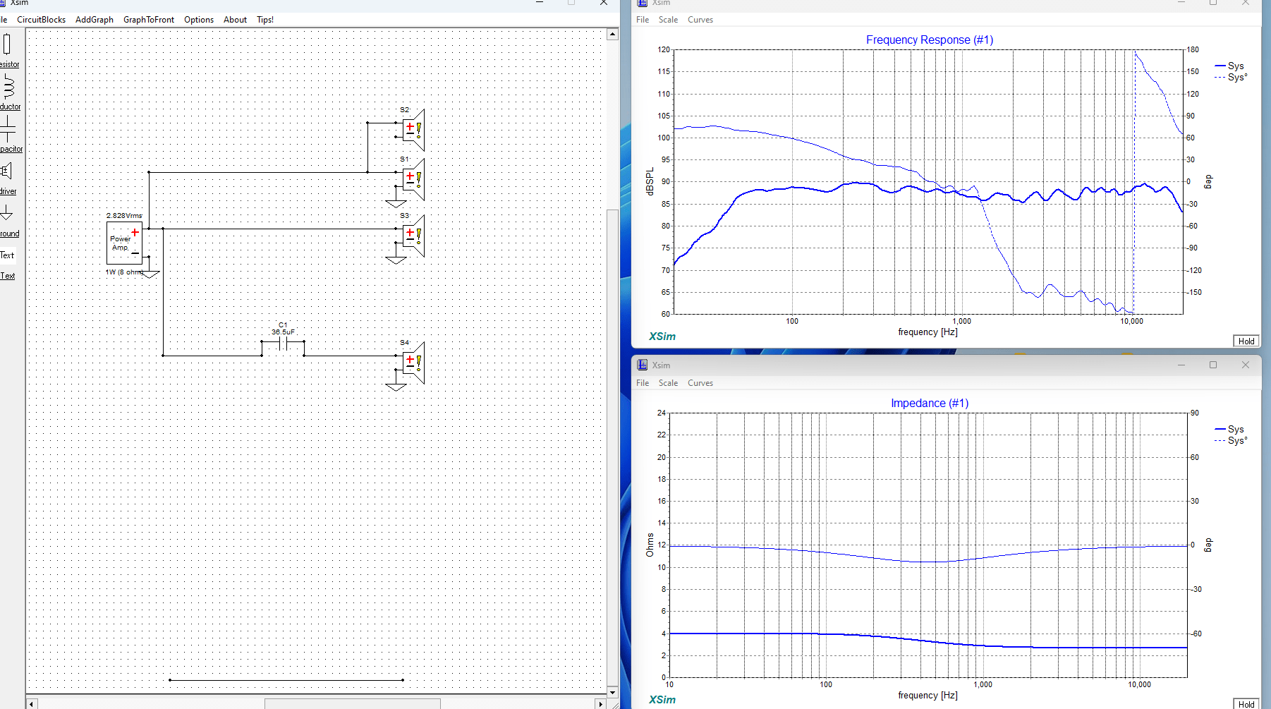

That would depend on a couple of factors. Since you will now have a "crossover" (even if it is a single cap) your system sum may change. When you make the cap very large then it is only blocking low frequencies.What cap do you suggest I toss in there for the tweeter?
Put the driver info into the modeler, add a capacitor, and see what happens. Try 22uf to start.
What impedance data are you using?
Have you put a mod offset on any of the drivers to allow for voice coil offset? This will affect relative phase response and therefore how well or not the drivers frequency responses blend
Did you use manufacturer frequency response curves? If so ideally you'd apply baffle step and diffraction to get a realistic in box response

Why is the capacitor too big? I can make it smaller but it flattens the Fr best right at that size. Is there a limit?

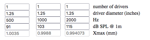

An important specification for loudspeakers is Xmax, linear excursion- how much one-way movement the cone/diaphragm/membrane can move before the voice coil starts leaving the magnetic gap. Past Xmax, distortion goes up rapidly.
Most low frequency drivers list Xmax, unfortunately few high frequency drivers do. A HF driver like yours probably has only about 1mm Xmax.
SPL (sound pressure level) must drop at 12dB per octave to have similar excursion:
A 12dB per octave crossover is a minimum requirement when running tweeters at higher levels.
I am a mechanical engineer, I have spent my entire working life with engineers of various professions, but no offense, I do not see an engineering approach in this work. 🙄
Not everyone appreciates what "constant acceleration" means. Ideal direct-radiators (no horns) are constant-acceleration devices.
What this means, in practical terms, is excursion increases at a rate of 12 dB/octave as frequency is lowered. It's unusual for any tweeter to move more than a millimeter before gross distortion sets in, followed by destruction. That's why a highpass filter is required, and 12 dB/octave is about the minimum slope that does the job.

In image you put here:
https://www.diyaudio.com/community/attachments/xsim-3-way-dual-woofer-png.1243244/
The speaker symbols appear with an exclamation mark, which means that their specific files were not loaded and the simulation was made with the models idealized for them and not with the real models.
I think I don't have to explain what the consequences are. The simulation result is completely wrong. **** in, **** out.
