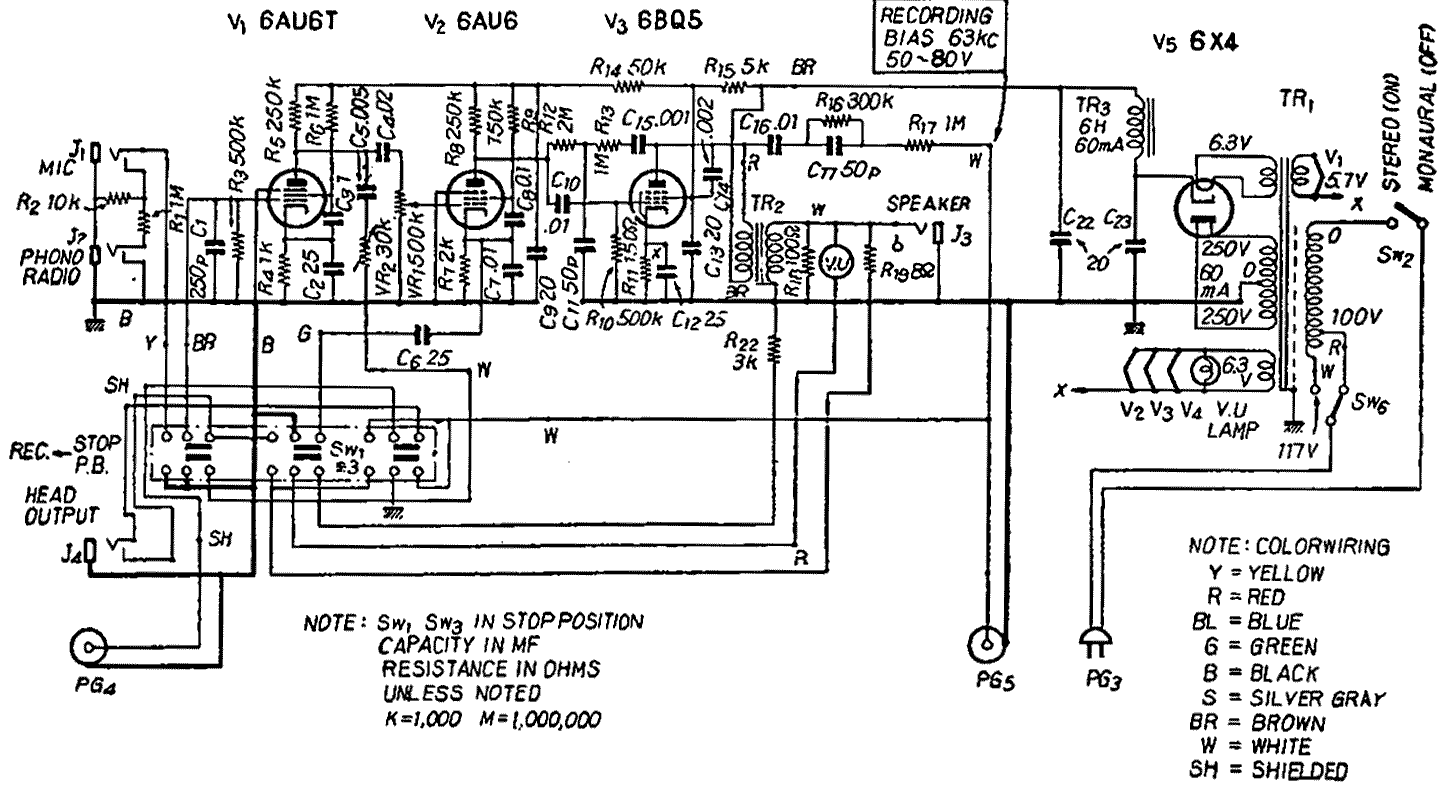

I have 6 of these modules, i will never use them all.
Yes these can be made into any number of EL84 SE amps. There are extra tube/tube sockets that you won’t need. The PS trafo is nice and the layout makes for a tidy build once you have stripped it down.
A schade-style amp (like RH84) would be my 1st choice.
attachment.php
There is also an EF86 mic pre.

I also have two complete Akai M8 machines that I've been hanging on to just for the electronics. The transports are garbage. A single motor deck that's a mechanical monstrosity with functions driven by rubber drive wheels which are positioned by pot metal cams that are known to break. The hold back tension is done with a cheap plastic & felt friction clutch that, over time, will cause flutter as it begins to cog. Yes, there are folks that like older tape machines including myself. But not those Akai's or Roberts.
FWIW, I have some somewhat zany thoughts on repurposing the electronics.
6267 = EF86
12AD7 = 12AX7
1 twin triode section as voltage amplifier feeding a SE full pentode mode final.
1 twin triode section as 1st gain block in a RCA style phono section.
EF86/6267 as 2nd gain block of phono section. A nice tube, but gm is low. Quiet enough?
Switch to SS rectified B+ to free a 6.3 VAC winding up for DC heater PSU feed.
Wire O/P tube socket for Russian 6Π15Π (6p15p) and 0A2 regulate g2 B+.
0A2 in 6AR5 socket. Sockets wired for the 6Π15Π accept EL84s. "Rolling" time?
