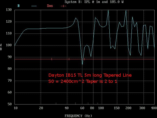

M mashaffer Member Joined 2004 tubiespad.angelfire.com/index.html 2006-09-12 12:53 am #21 2006-09-12 12:53 am #21 I am getting in kinda late on this but I did model the Dayton IB 15 in a TL and it looked pretty good (though large). mike Attachments daytonib15.jpg 50.4 KB · Views: 73
