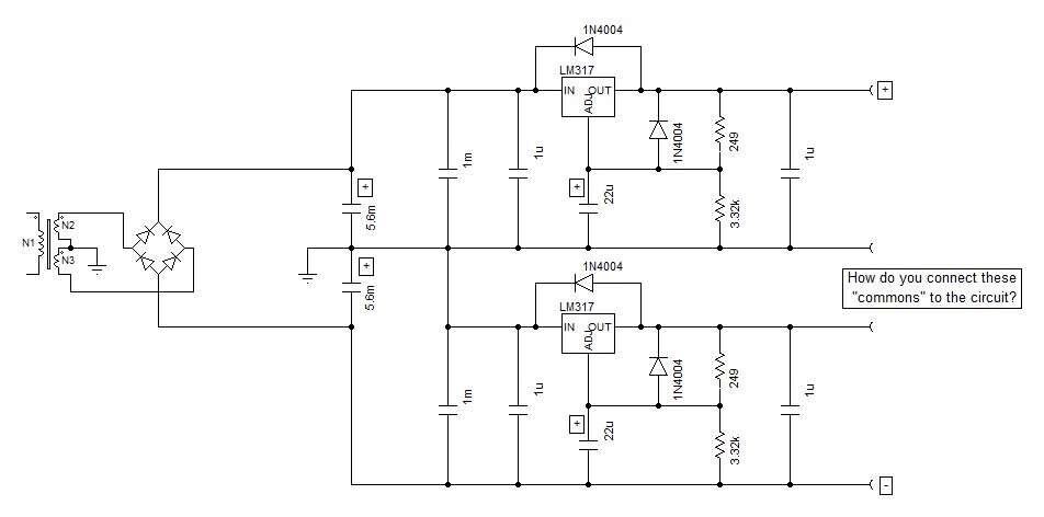

Can I connect 2 LM317 regulators to dual supply rail?
If I understand you correctly, this is what you mean?

The +48 and +24 will work from a single winding as long as the current out from the +24 doesn't go negative. With DC load we can make it happen. With audio equipment, not possible.
Stick to dual isolated secondaries or SMPS or etc.
