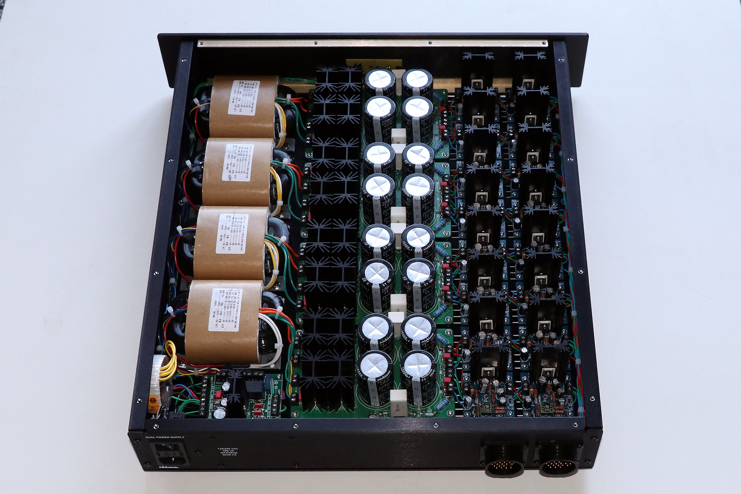

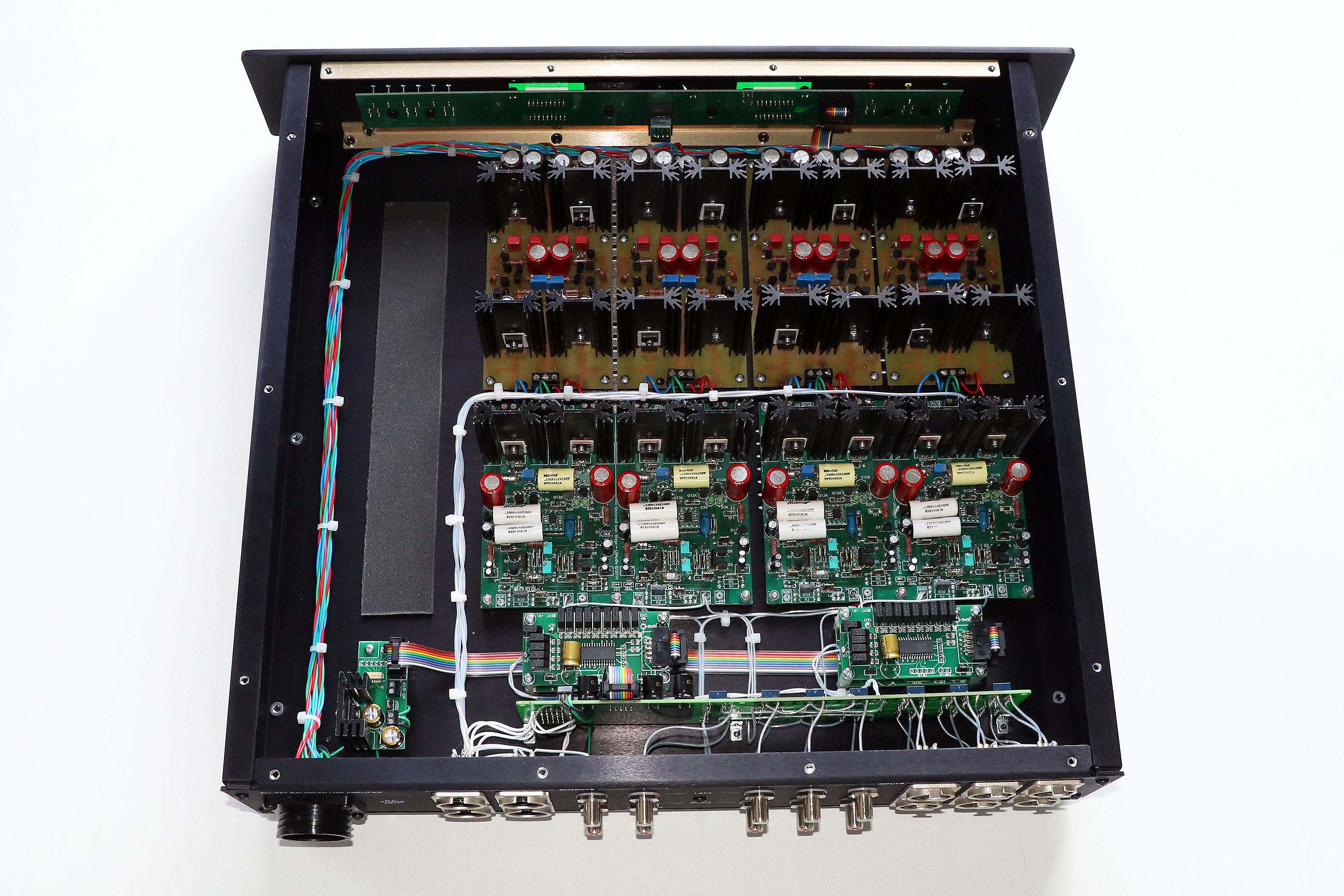

Balanced line stage and attenuators and seperate power supply chassis, diy not to save money, but to build it the way I want it. R core transformers, CRC power supply 240,000 uf, Jung regulators as pre regulators, fet shunt regulators, discrete jfet/fet line amp designed by Erno Borbely

That is an excellent preamp (I have heard it on many occasions). Very nicely built and looks commercial in addition to performing better.
This is an example of what a hobbyist can do that does kill a lot of commercial products costing thousands.

I hate say it, but it cost thousands too, i just got to do it “ my way” (@ copyright Frank Sinatra) .................
