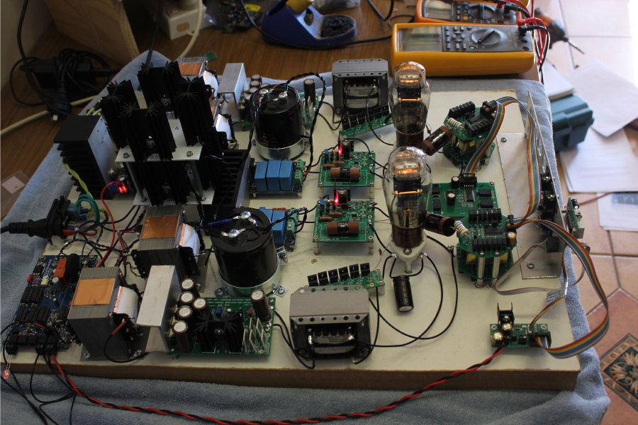

To beat a Commercial Preamp is very easy:
1. Know what you are driving downstream. Do you need to drive fully balanced lines to distant equipment, or just Single Ended RCA. If fully balanced, do you want transformer coupling or cap coupling. Your preamp needs to drive whatever impedance is downstream.
2. How do you want to Attenuate and Switch Inputs? Are hand controls sufficient, or do you want IR Remote with relay switching. Do you want fancier switching (i.e. over TCP/IP)?
3. Choose your Class A line stage topology. Discrete semi or tube
4. Do you need Gain? In today's era, probably not much. Let your Phono Preamp give you gain. Plan on 2Vp-p input from a DAC or other Line device.
One you answer those questions, you can find solutions to all 4 questions with existing PCBs and developed/proven modules. The rest is planning the fancy case!
Great points. The significant advantage that a DIYer has is that they are designing/compiling for ONE application, ONE room, and ONE (or two) sets of ears. Suitability is the most important aspect of quality!
Going through these pages looking at the DIY designs, it seems that most DIYers probably do not have the time and skills to design proper circuits, then having to perform layout to PCB designs. And given most designs probably will not be optimal the first time, you have to go through a few iterations which is beyond what most DIYers can tolerate.
Some probably can, but not most.
