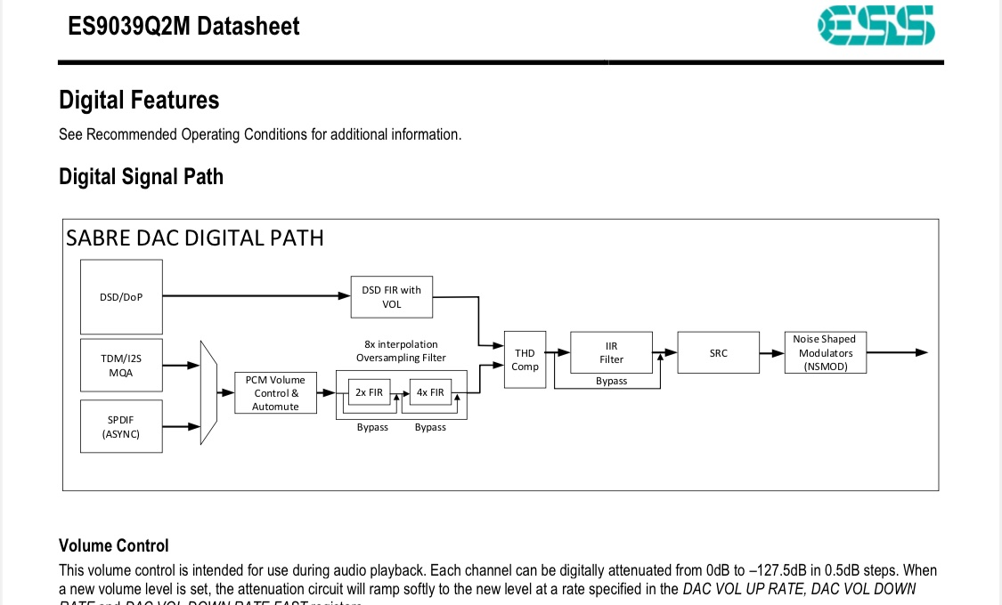

DACs regularly clip on music, which they should not do in my opinion.
To check whether it is audible on music requires an extensive double-blind test with carefully selected music and carefully selected listeners, which test no one has done as far as I know. It would not surprise me if it were audible on some recordings, but I simply don't know as no one has done that test.
I think this concern is more with other type of DACs. DACs built around this chip with digital vol adj happening before filters at normal listening levels not affected and no further tests needed
