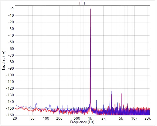

Good measurements ≠ good sound. Look at this for example, do you like those graphs ? But this is just measurements and this is not a representive of how this sounds. And I know and I hear how the same DAC chip can sounds much better than in that realisation.good measurements
https://www.audiosciencereview.com/forum/index.php?threads/smsl-su-1-stereo-dac-review.44029/
