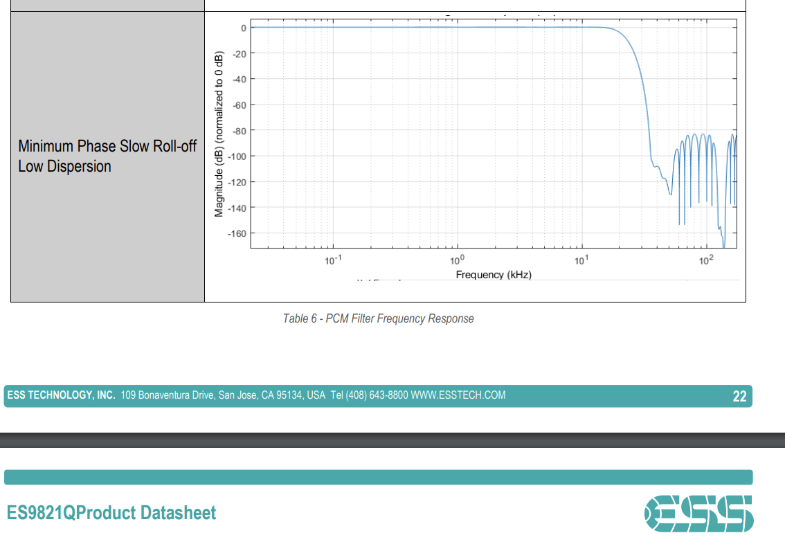

IIRC, SRC4392 ASRC chip uses a half-band filter.
That said, modern dac and ADC chips from AKM and ESS usually have selectable filters, some of which roll-off pretty fast in the transition band. Don't know what ESS uses for its internal ASRC though.
