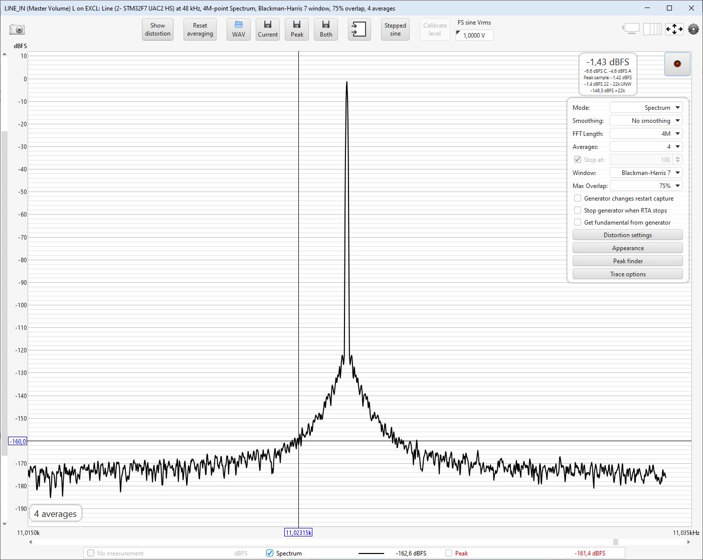

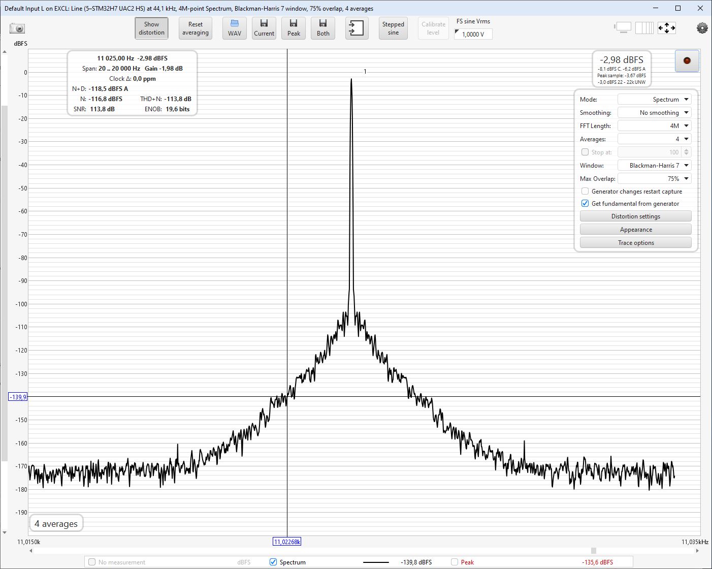

These things have been discussed before, but here goes again. Every dac needs two analog reference signals: (1) a voltage reference, and (2) a time reference.You keep saying there are dynamic noise effects, but don't provide much detail.
In the frequency domain the reference signals are convolved with the audio signal. Noise on the voltage reference is amplitude noise; noise in the time reference is phase noise (and yes, its RF). If there is noise on either reference it becomes intermodulated with the audio signal. There are also noise sidebands produced as part of the intermodulation process. Amplitude noise on the voltage reference and phase noise on the time reference are now embedded as part of the audio signal.
Say, for example, the audio signal consists of a large amplitude signal with some low level details signals riding on the large signal. Noise that has now become embedded in the large audio signal may blot out and obscure the low level audio signals that were riding on the large signal. The noise sidebands from many large level audio signals at once (an orchestra playing loud, for example), may spray all over the audio band covering low level frequencies far from the loud level signals.
Dac chip manufacturers know all about these kinds of effects, and there are some common techniques for measuring some effects. Other effects are harder to measure. Since there is no fix for some of these things and since an AP analyzer can't measure them quantitatively, the dac manufacturers think there is nothing to be gained by admitting that such problems exist. Their business is to sell dac chips today. They will tout the measurements that will help sell more chips. Nobody feels obligated to tell you about shortcomings of their products. They need to sell stuff, not tell you why you shouldn't buy their stuff.
The noise products, BTW, are not really noise. They are complex constantly changing intermodulation products, but they look like spectral line noise skirts on a very hi res FFT (because their power is spread over multiple bins in the time it takes to acquire and FFT), so we loosely refer to them as noise.

Nothing top secret about my dac. I have presented it quite thoroughly at DAC gallery. Even given details to people asking about it in PMs.Its why some people say they care more about SQ than measurements. Its because of overfocusing on making the spectrum look pretty can lead to not such good sound. And that's not because people like distortion either. One can have a nice looking FFT and a collapsed sound stage. There is no guarantee the sound stage will be great. Now if the noise skirts that can be viewed are optimized then that may help some. Only one person here might know whether that's the case or not, the guy with the top secret dac, Bohrok2610. And I not sure he would know it if he heard it.
https://www.diyaudio.com/community/threads/dac-gallery.166807/post-7761366
Regarding the sound stage only thing I can say is that soundwise it is not different from RTZ dac. Noise skirts are quite a bit lower indeed.

Thanks!Ordinary dacs, both better than -120db for thd+ noise and imd 32 tone. So competent.
Mine has a similar spec, so that gives me some ammunition against upgrading!
