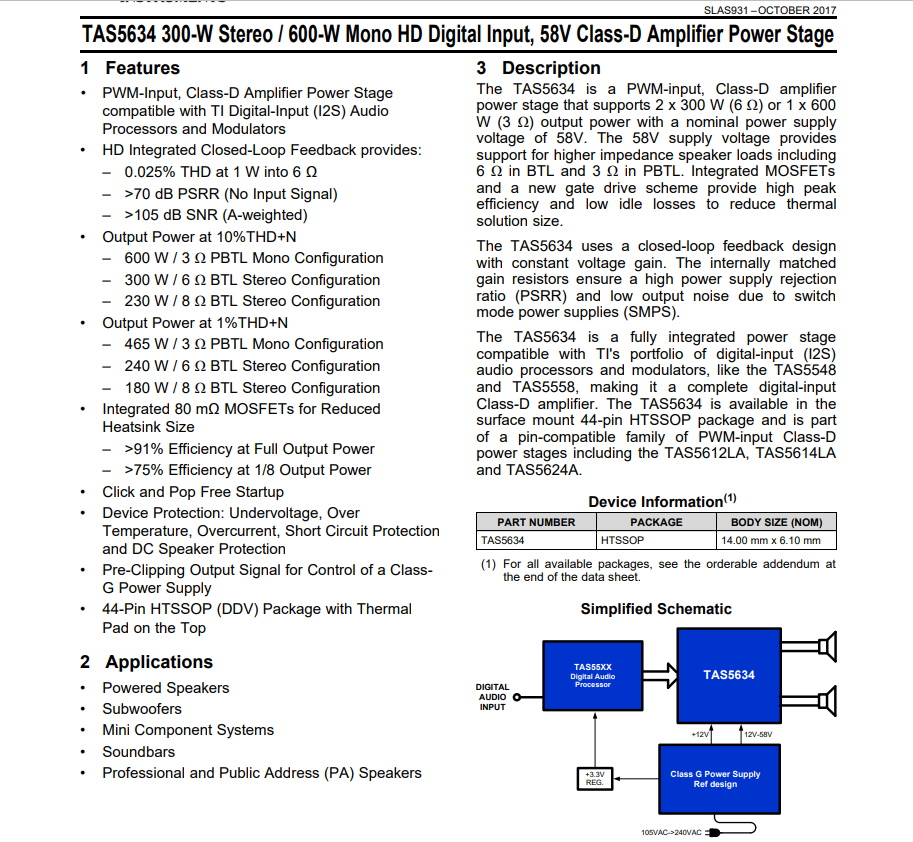

Check out the TAS 5634. It may be just what you're looking for, but in an integrated form. I'd post the pdf, but dont want to cause anyone trouble.
The TAS5634 seems to be equivalent to the output part of a TPA3255, and requires a TAS55xx to drive it. But TI's pages on most of the TAS55xx chips are "locked" and the available TAS55xx chips are 8 channels and may not support analog input. I suspect that TPA3255 has replaced TAS5634 for new designs.

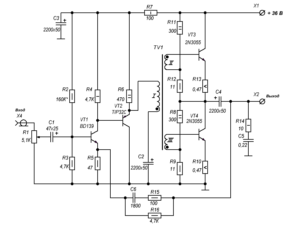

OldDIY, there is a strange problem with your link. It only works from the notification email and not from the web page. TPA3116 is capable of 2x50W by itself so you would need a lot of 2N3055s to make a bigger amplifier. This 2x2n3055 amplifier is about 20 Watts. Here is that circuit:
