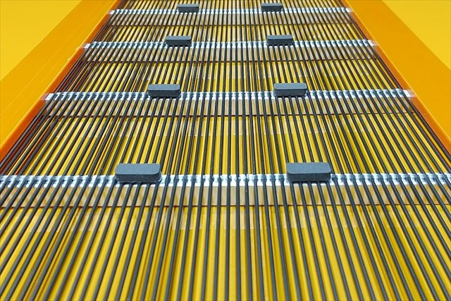

Currently, I am trying to build a full-range speaker. Compared to others, I thought the UL1061 (AWG16), which has a thinner sheath, would be a good choice.

In the photo, I used "E6000" to bond polyethylene wires.

And what is the point of this wire insulation, what does it give?
From my point of view, it is much better to put wires as thick as a wire with insulation, then the rigidity of the stators will increase and there will be less distortion.
In the case of thinner wires + insulation, this will be a harp, thin wires will bend in any case during active operation of the membrane, and will also steal the total area of the electrode.
The rigidity of the stators, in my opinion, is one of the fundamental rules for constructing an ESL. Where the stator is an anvil, and the membrane is a hammer that should fly off the anvil.

Asking that Q when it´d be potentially lethal to touch the wires ... which is always a accident waiting to happen with DIY or laboratory setups. 🙄
Stator rigidity certainly is a valid design point, but the more so is user safety ... especialy when starting the esl-route as a noob.
@Chace: epsilon-R is the dielectric constant which describes how many times higher the capacitance becomes compared to vaccuum, resp. air (epsilon-R=1).
PVC typically ranges around a epsilon-R of 4 and a volume resistance around 10exp12Ohm-cm
Now between Membrane surface and stator conductor lies the airgap and the counductor´s insulation.
These two series connected layers form a capacitive voltage divider under ac-conditions and a resistive divider under dc-conditons.
To achieve as small losses as possible and as much voltage across the airgap, the insulation capacitance should be high, hence a high epsilon-R.
Similar under dc-conditions the resistance of the insulation should be smaller than the airgap resistance to achieve a high field density in the airgap.
