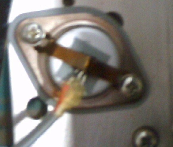

I have attached a picture of the Vbe multiplier mounted in one of my Lifeforce 55 amps.
I always prefer to use a TO126 rather than a TO92 because only the former has a metal base directly attached to the transistor die. This means that thermal conductivity to the sensing chip is FAR higher, and therefore bias tracking with temperature changes should be superior. Furthermore, unless a hole is drilled into the heatsink and the TO92 inserted with metallic glue, attachment is rather more difficult than use of a simple hole!

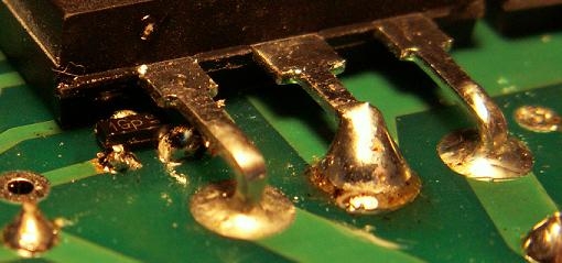

For bias compensation, I took the tack that I wanted the sensor to track one of the main power transistor die temperatures as quickly and closely as possible. This is the same approach used by On in the Themaltrak transistors where the diode and tansistor die are co-packaged. In my case, the SOT23 transistor has a very low thermal mass (so it responds to ambient temperature changes quickly). The idea of the thermal grease was to couple the collector lead which is the part of the leadframe on which the die sits in the transistor package to the whole sot23 device to ensure good coupling.
However, since the delta Vbe of th e sensing device is not the same as the output devices (I ignore the pre-drivers and drivers in this simplified explanation), you do not get exact tracking. If I had used a diode string to do the sensing, then one trick is to adjust the diode current and this allows some delta Vbe slope control. In my case, a little experimentation led to the conclusion that removing the thermal grease got the compensation just right. Without the thermal grease, the response is a little bit slower, but I have not measured it specifically - but I can detect it when I set the bias current up.
There is no one perfect way to do this - every set up has to be trimmed empirically because there are many variables brought about by the mechanical construction of the amp - size of heatsink, type of sensing, Output device delta Vbe charactersitics, etc. So, although I like 'my' approach because its very simple and mechanically easy to implement but this may well not be ideal for another type of mechanical design or layout.
