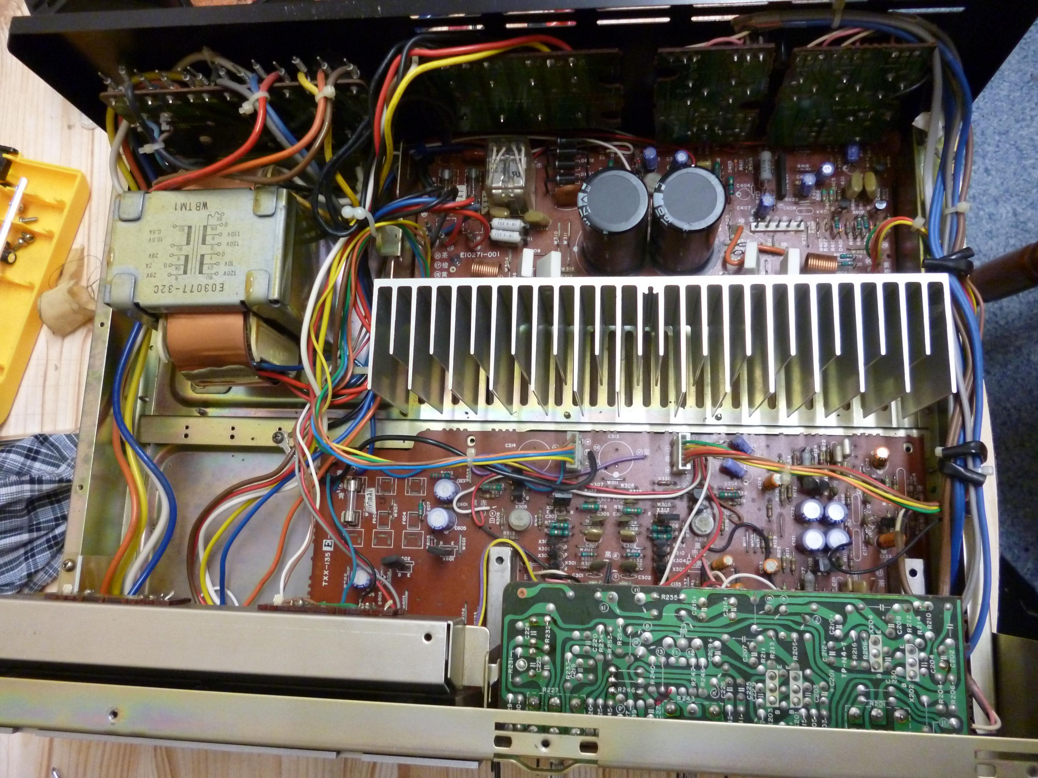

Thanks Ian, I do have a meter and will get back to you on those readings. It all has been cleaned thoroughly (see pic) and every connection the whole thing striped down and put back together all caps ESR readings are good if not excellent including their values. Both main boards where even switched from a donor unit and it was still doing it? I will get back to with those readings when I have time Thank you again.

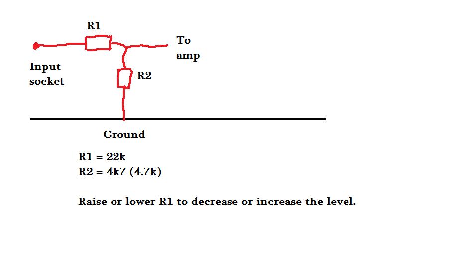

I suspect both the volume and "distortion" problem is nothing more than the unit having essentially DIN levels of input sensitivity (quoted as 160mv rms). A modern digital source such as a CD player is around 2 to 2.5 volts rms, thats more than 10 to 15 times too much. It should be easy to add permanent attenuators to the line inputs, either at the sockets if they are hard wired or by nicking the PCB print if they are directly soldered and adding a two resistor attenuator (two resistors per socket, one in series and one to ground).
Thanks mooly so I have been round and round for nothing? please can you give me details as to a way I can plug one into the phone inputs so I do not have to change the amp. Thanks.
You can either make them to fit externally like these,
Attenuators
or add them internally as a permanent fixture which is what I would do.
This shows one channels input (eg tuner left channel).

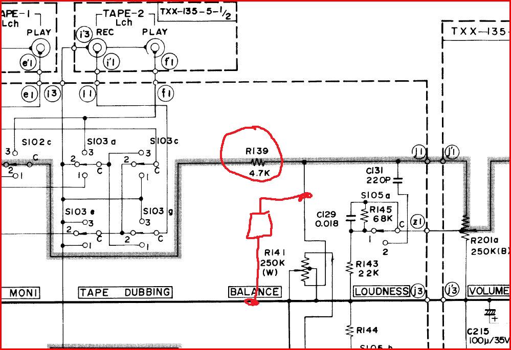

Also, if you dont use the phono stage then you could add a single attenuator to cover all inputs as shown. Change the value of R139 to say 22k and add a series resistor to ground, say 4k7). That would attenuate all inputs.

Thank you Mooly that is very helpful, so basically i can tag that first circuit in the end of a phono lead input and it will drop the voltage from the output player?
Yes, its just a simple resistive divider.
You could use a preset pot to experiment and get the values spot on (so the volume control feels right with level vs rotation) and then get the nearest fixed resistors to the setting.
Hi mooly just to let you know I tried that first circuit with a trimmer pot, I could adjust the volume with it but unfortunately it made no difference to the problem I was having, strangely enough my jvc s77 does the same thing but at a lesser degree?
