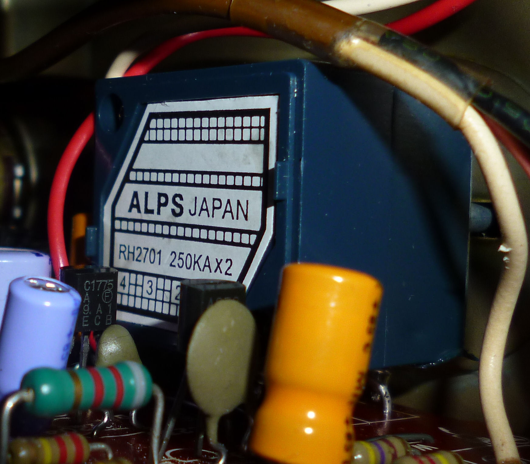

Thanks Ian I went ahead and ordered that pot, when it finally arrived I had to adapt all the pins just to get it to fit, but that's ok I expected that. I ohms tested both channels on the pot before putting it in, fully open, one side read 4.5 the other 2.5 odd? It also has a step feel to the control, not a smooth movement like the original. It did seem to sort of work but now I have to turn it up twice as far to get the same volume.

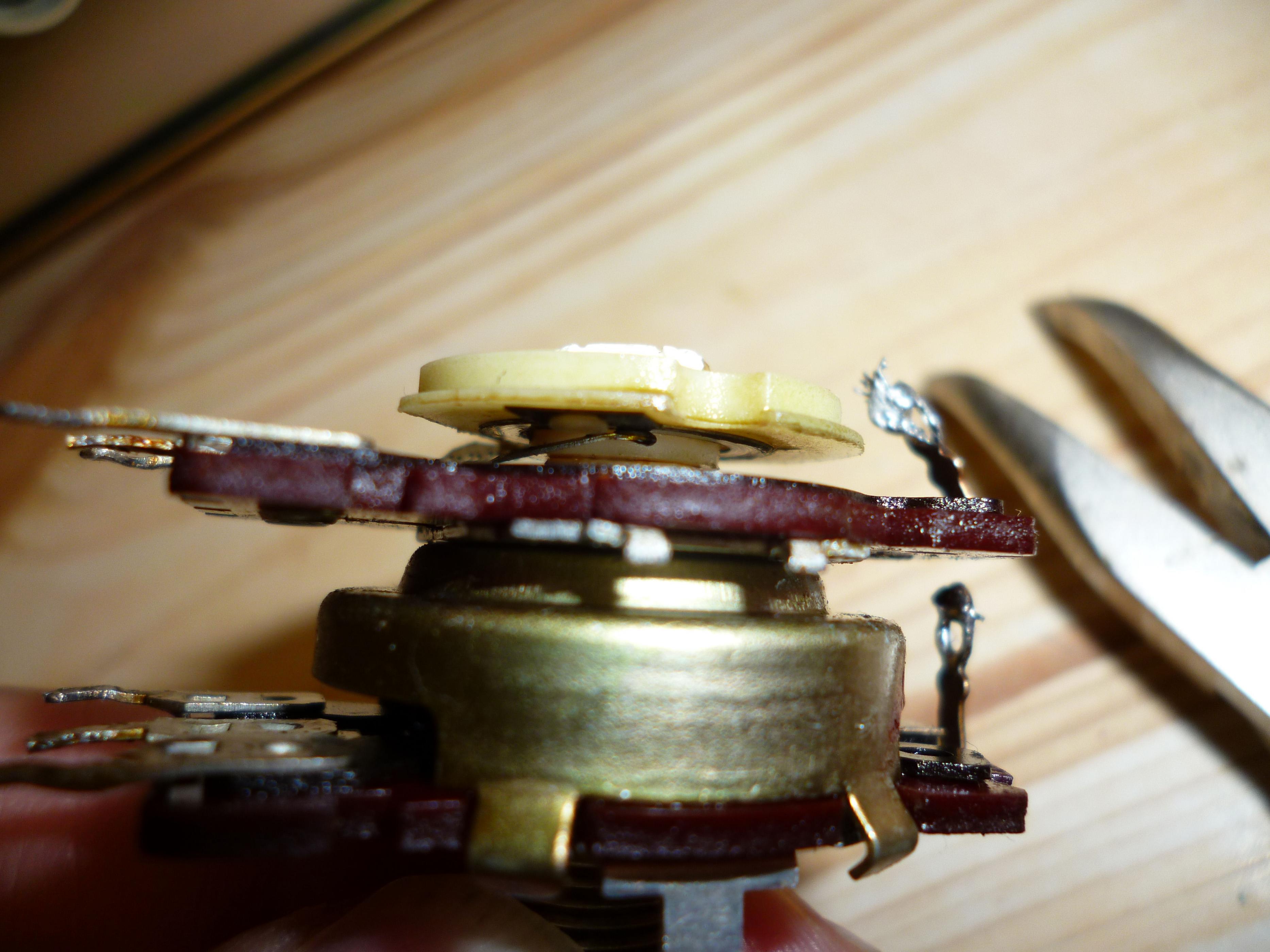

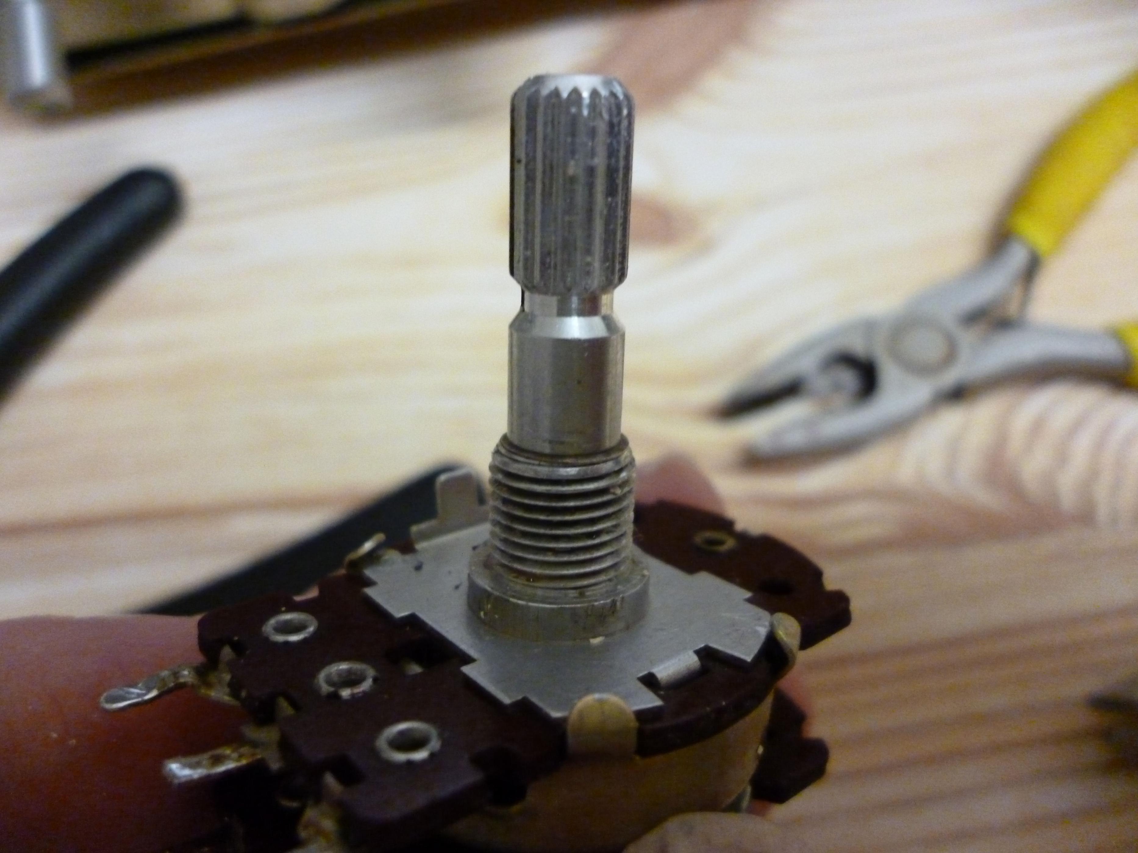

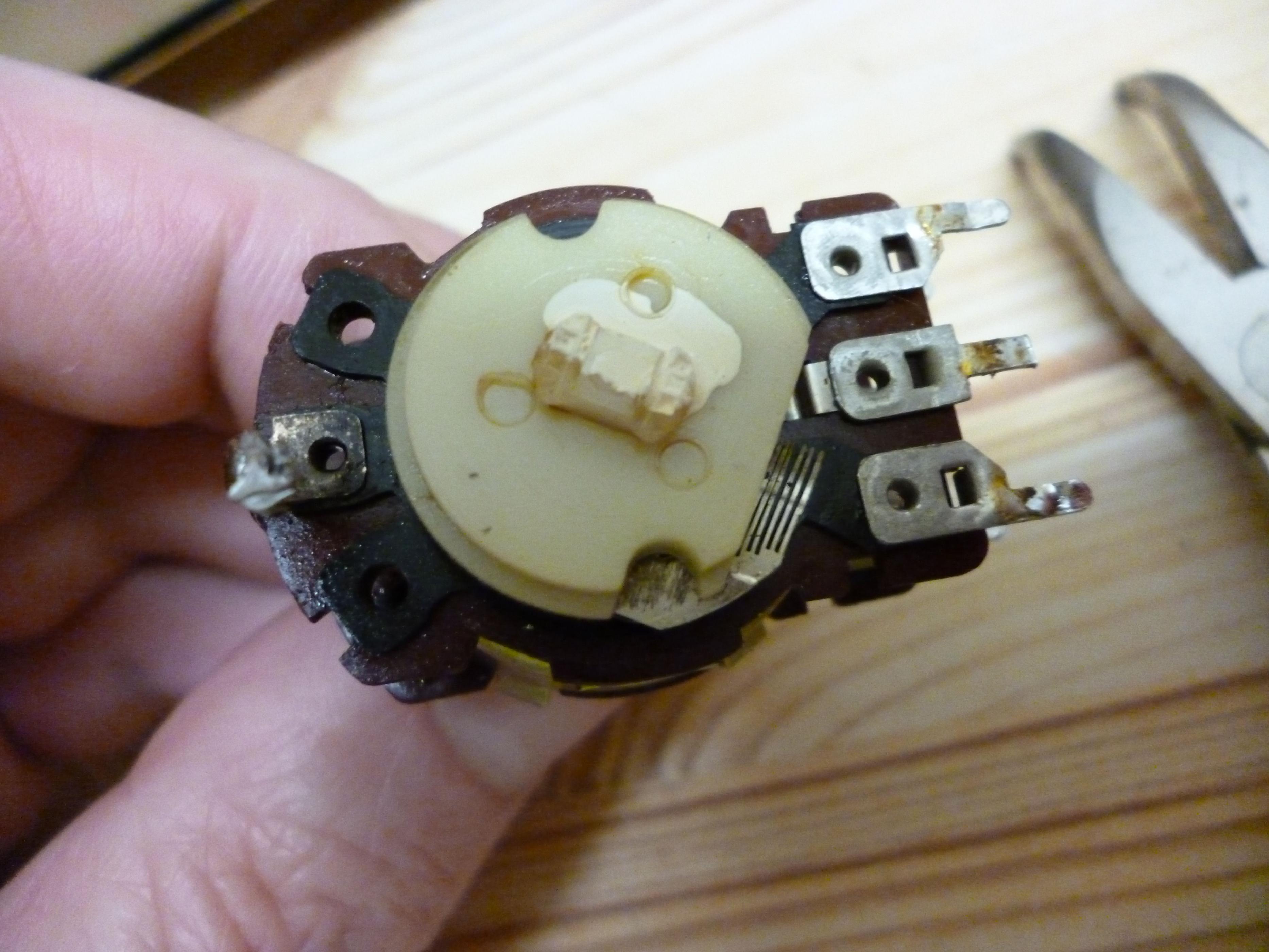

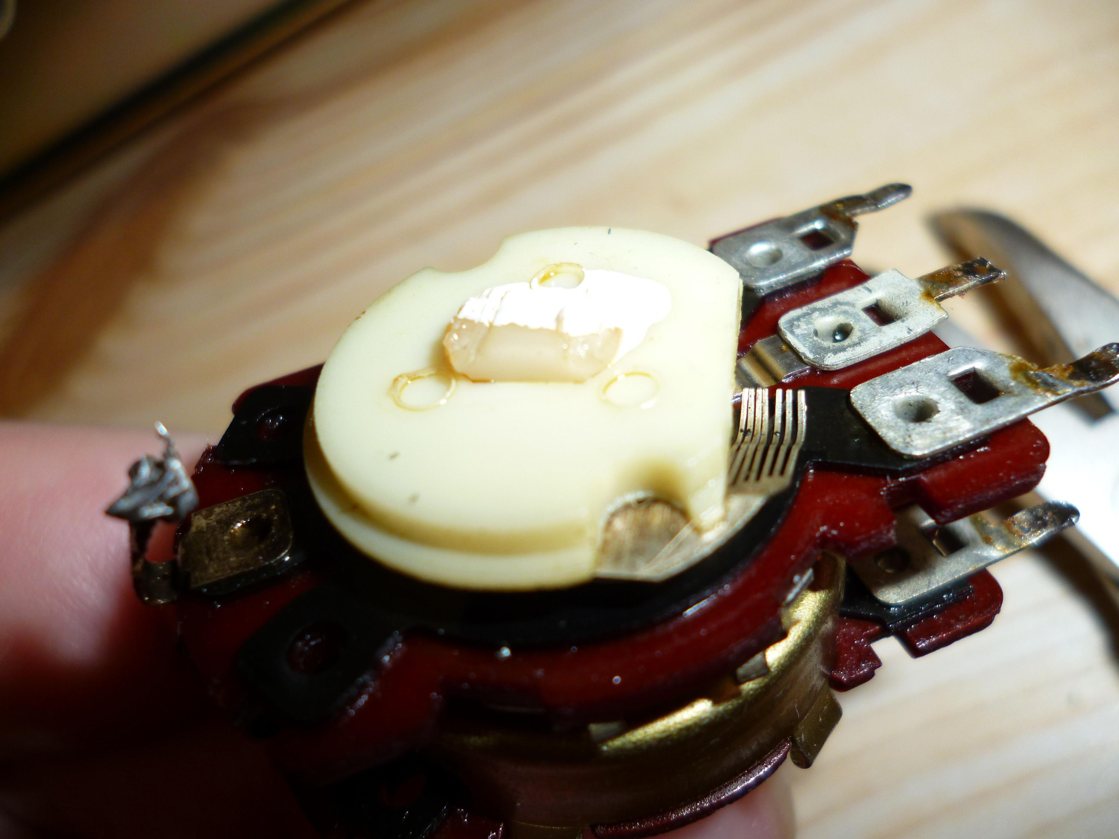

I did try taking the original pot apart, but this is as far as I got the thing will not disassemble any more than this. The picture of the mettle shaft shows a little washer that is not a split locking washer that must have been put on first, and then the rest of the assembly slid into place until finally glued at the back.
Disassembling the old one was definitely worth a shot.

Having looked up the details of ALPS pots a few times, when you read the label, there is a part number which follows the series part prefix RK27112..... Together with the specific part reference, that should be useful to search with Google for a datasheet saying precisely what it is.
Also, there is a descriptive code like 10KAX2, which means a dual 10K log pot.
In this series, B does mean linear, so 10KBX2 would be a 10K linear pot. That isn't the case for all Japanese pots though.

I'm not sure what you have there tbh. I can't find anything in the ALPS catalogue that has that number. They list one that has a 31 "detent", your clicky action but its not 270k. In fact they don't seem to list any over 100k these days (unless I'm looking in the wrong place).

I had a good look too it is a made up number. Also with the volume at it's lowest setting I can still hear some sound, you don't think I wired this up wrong do you? after all if I did it would not work at all would it?
Wouldn't have thought you wired it wrong. Middle pin is the output on them all, so as long as that is OK and wired the same as the orginal then the only other effect of getting the outer two pins mixed is that the control would work back to front.
Are we saying its a fake part then ?

YES it's fake but we knew this before hand, did we not? £5 from china, but i did think it would be a close copy of the original or at least a fair approximation, i don't think Alps even make a 250k pot with a knurled shaft.

Uh-huh. Well as you find, RH27... isn't an ALPS series that shows on the web. Mouser have this ALPS part number coding document in their catalogue for genuine parts but I don't know the scope of it, i.e. how far back it goes in reference to earlier products or deleted codes.
I suggest you simply grab your multimeter and measure the resistance from wiper to ground as you rotate it and draw yourself a little graph of rotation angle or even clicks per ohm. Note that there will be the balance control in parallel with this, putting 125k across each volume pot. at mid setting. It seems you can isolate the volume pot at points 11 and 12, according to the schematic, to test it in circuit. When there are no other pure resistances in parallel with the pot, only a linear pot. or a balance pot. will show half DC resistance at its midpoint. Log pots follow some form of logarithmic progression of resistance to approximate our hearing sensitivity. How this is interpreted and achieved in production by different manufacturers and for different applications, such as when a loudness tap is added, seems to vary widely so don't expect precise log. character - check the graph in the link and an earlier post.
