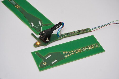

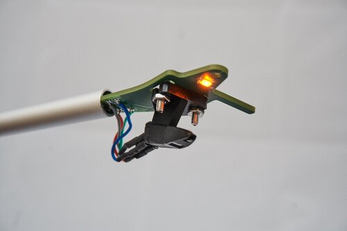

Use of remote headshell JFET's suggestion by @Preamp
https://www.diyaudio.com/community/threads/diy-tonearm-from-pcb-material.393271/post-7216422
