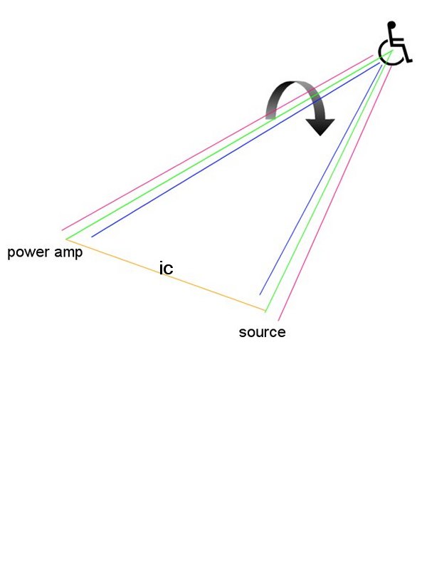

Nice....
The wiring is good, and correct..
It is inductively coupled..
Here's a pic..(don't even think of dissin the draw..my scanner is down, so my pencil is useless)
Wheelchair guy is 3 prong outlet.
red is hot,blue is neutral, green is ground.
brown/yellow is the ic ground.
The power amp draws current, hence the flux field arrow around it..Yes, it is twisted, but humor me for a sec.
The power cord makes a field that changes with time, and some of that goes between the amp ground and the source ground. IOW, it is trapped by the ground loop formed here,currents will flow through the ic shield. Those currents will be proportional to the rate of change of the field through the loop, and proportional to the frequency of the changing field..
It is this loop that can cause hum pickup..but I'm not talking about hum.
It is the haversine currents I am talking about.. from the amp draw..
If the pc for the amp is truly an integral number of turns, 1..2..3, etc., then the sum of the changing field within this loop will be zero..nada, zilch..and, nothing should happen..
But, what if the amp pc is only twisted 1.5, 2.5, 3.5 times? The total flux will not cancel, but will integrate out to one half loop contribution...which, I do not know if it is significant (yet).
The total voltage presented to the amp ground as a result of this current will be the total drop of the loop current and the ic shield resistance. That is the amp reference ground...
The inner conductor of the ic also forms the exact same loop, with one exception...the total loop resistance of the ic loop is 10K ohms (or whatever the amp input resistance is)..And, all the loop voltage for the signal loop will present at the amplifier input load resistance.
So, if this scenario is correct, then some power cords can induct a haversine voltage into the ic center conductor loop, showing up at the amp, pretending to be an input..
Notice that my pic and explanation does not have anything to do with earth ground (the wheelchair guy). I am saying that the loop to the outlet can be bounced by the amp haversines...
Cheers, John

tom1356 said:
I think with the introduction of "wheelchair man" it is obvious this thread has to be put out of it's misery.
Reminicent of Ol' Yeller...just put a bullet in it.
You made my day...I'm rolling on the floor.....I figgered Steve Eddy would jump on that first with his no-ac picture...
I put the graphic together using psp 7, and they are rudimentary when it comes to canned symbols.. and I have an old visio that I can paste symbols, but the two programs don't talk well to each other....I end up doing an alt-print screen and store the actual screen shot on clipboard, then paste into a jpeg..
I couldn't even put together a twisted pair drawing, or a helically rotating dipole field of the line cord.. Sometimes, the pencil is best..
Guess I'm gonna hafta put my home computer back together again, just to get rid of wheelchair man..:smash: :smash:
Does anybody have any technical comments??
Cheers, John
Aha. You seem to have worked out the problem of earth loops from first principles...
If a system has an earth loop (essentially, if signal ground is connected to mains ground at more than one point), then all bets are off - changing your mains cord, gold plating your mains plugs, leaving the freezer door ajar (after you put your photograph in it :xeye: ) will all now be significant.
Earth loops are so humungously evil that they must be avoided at all costs! If safety considerations prevent breaking the link between mains and signal grounds, you'll have to ask Steve Eddy for one of his transformer isolation boxes...
Cheers
IH

What I find most interesting is that the coupled flux induced currents will occur regardless of the thickness of the wires..you can use #2 welding wire for all the power and ground connections..but that loop voltage will still happen..
So my hypothesis and diagram are my attempts to try to understand the issues, so that power cord differences can be addressed in a scientific fashion, rather than the random one I see being used by the audiophile community.
