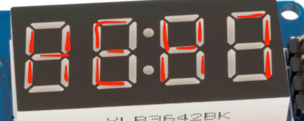

CamillaDSP on Pi remote control

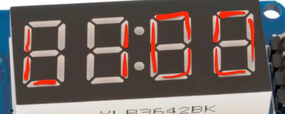

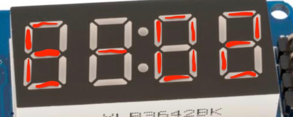

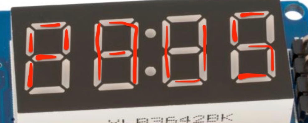

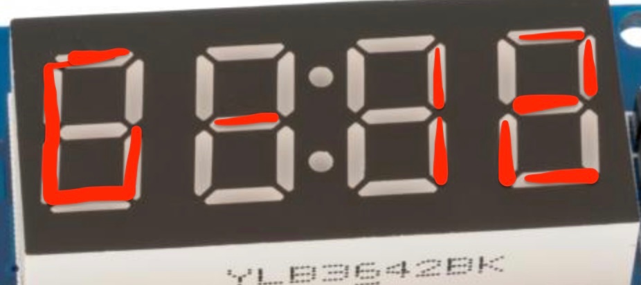

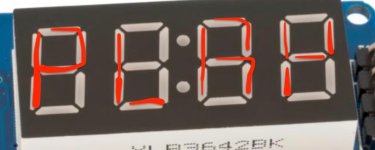

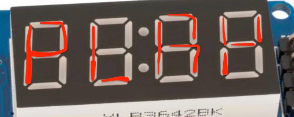

Serial display 7-segment 4 digit TM1637:
Stop (for 2 sec, back to level)
Play (for 2 sec, back to level)
Next (for 2 sec, back to level)
Paus (alternating every 2 sec to Level until play or stop)
Mute (blinking?)
Level 100% (showing default)
EQ -02 (.. -10) (goto EQ mode - use up down arrow to change "level" (-10...0..10) EQ is like the good ol' Quad 44 tilt control.... 😉
EQ 02 (.. 10)
Level: 60%
Config 04
