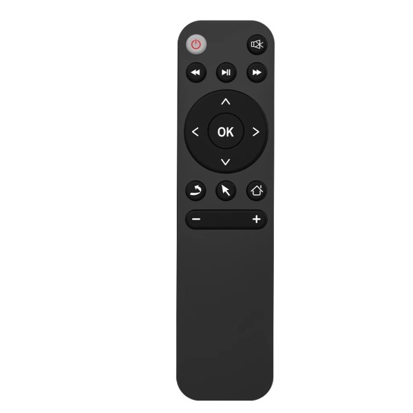

the script use this remote, you can find it on aliexpress, but it is easy to use all remote acting as a keyboard ( flirc, bluetooth or usb 2.4ghz)

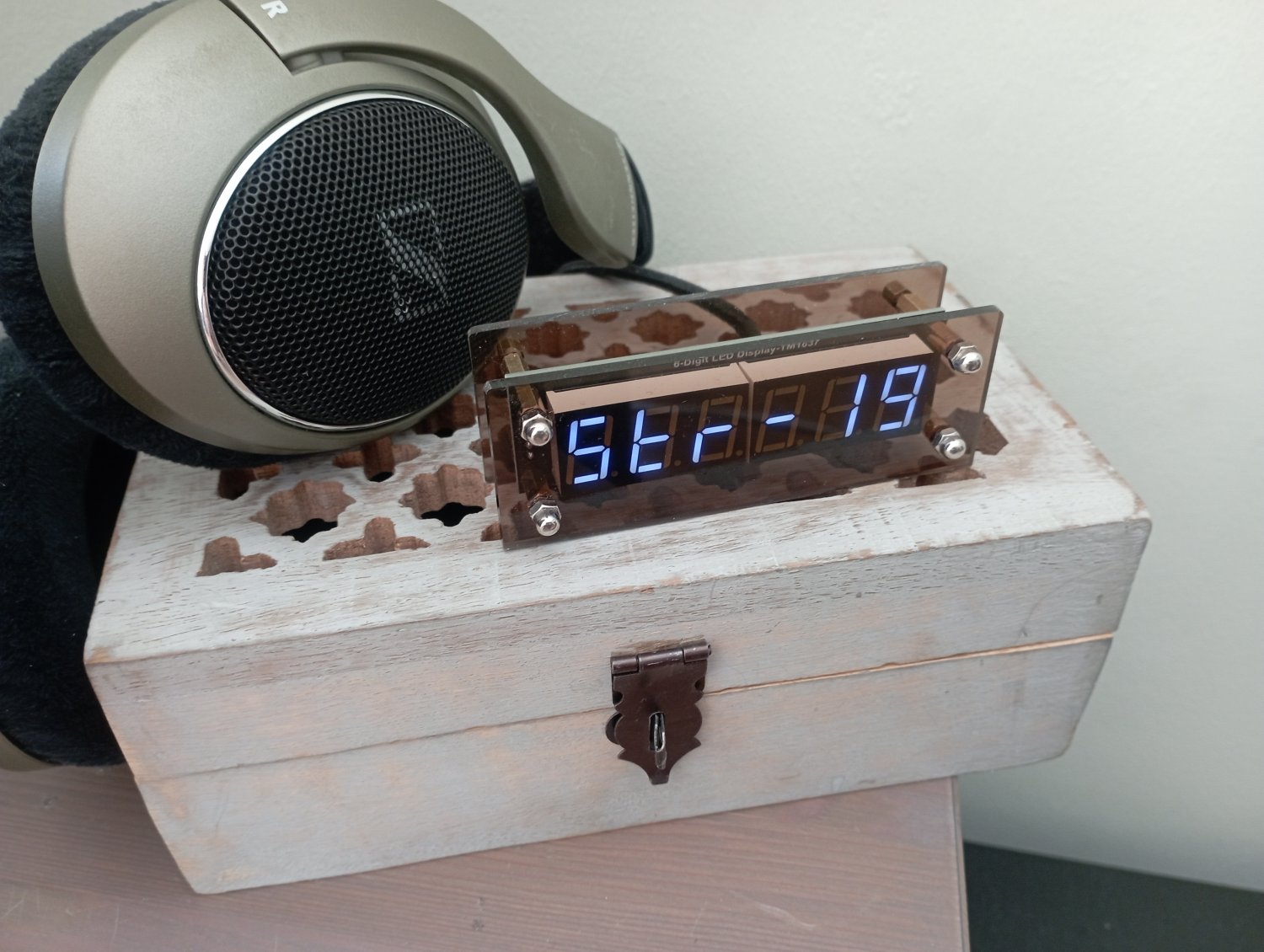

use this for display:

For the display

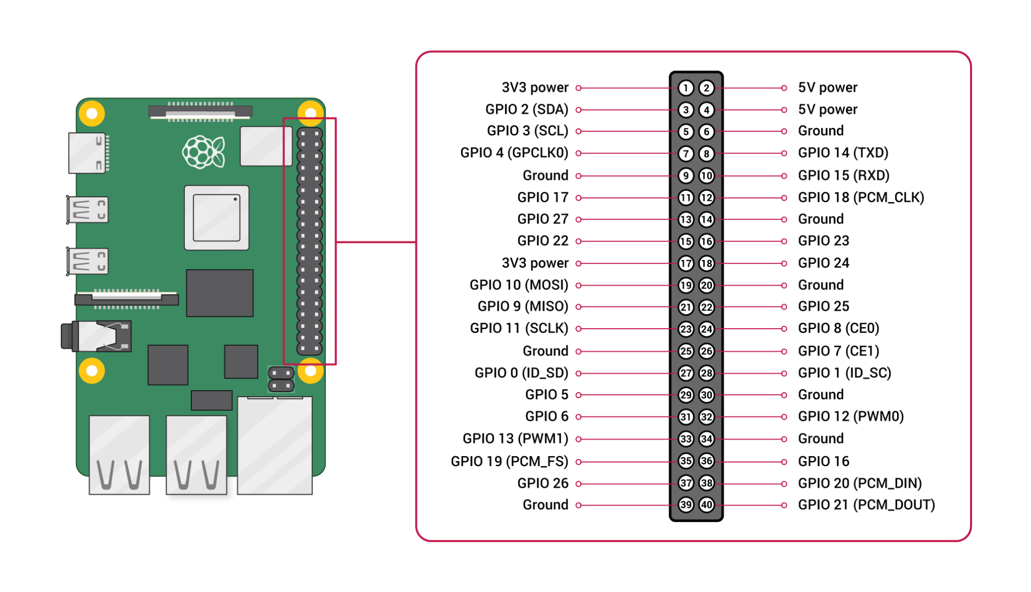

Connect red wire to VCC, black to GND, green to DIO , white to CLK on the display.
Connect red wire to 3,3 or 5V ( brightness - + ) black wire to ground, green gpio 24 , white to gpio 23 on the RPI.
and for the relay, connect RPI gpio 4 to "in" pin of relay, dc + to 5v , dc - to ground.
