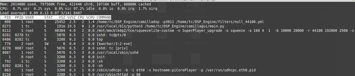

I attached a "top" picture of it running on a RPI 3, so i guess running it on a RPI 4 it will be much better?

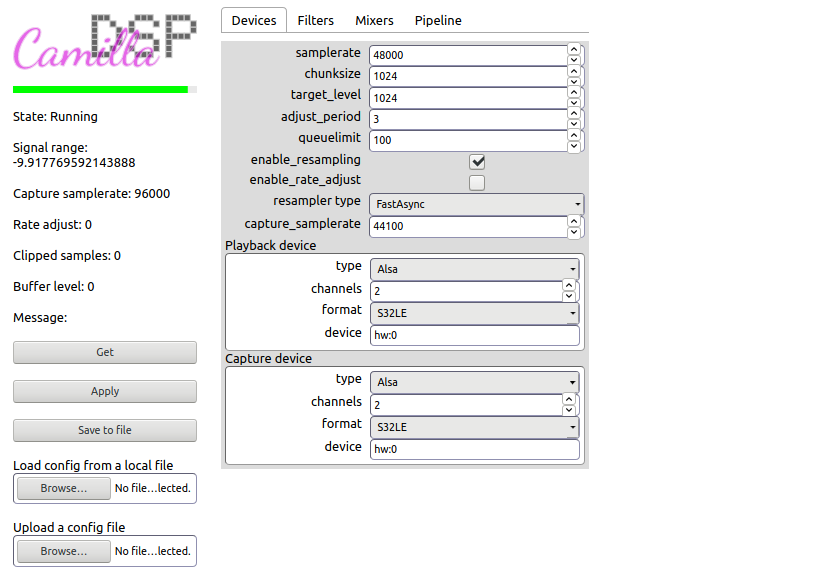

Playing a 44,1 ksps track (CD rip) I experience slip (ticks, pops, micro short stutters) while playing say every 10-30 seconds. I use VLC as player but also on other sources.
Also, the first 100 ms of each tracks seem to not play out.
If you use an asynchronous USB DAC, you should probably set the "enable_rate_adjust", or else you risk buffer under/over-run due to small differences of the source and DAC clocks.

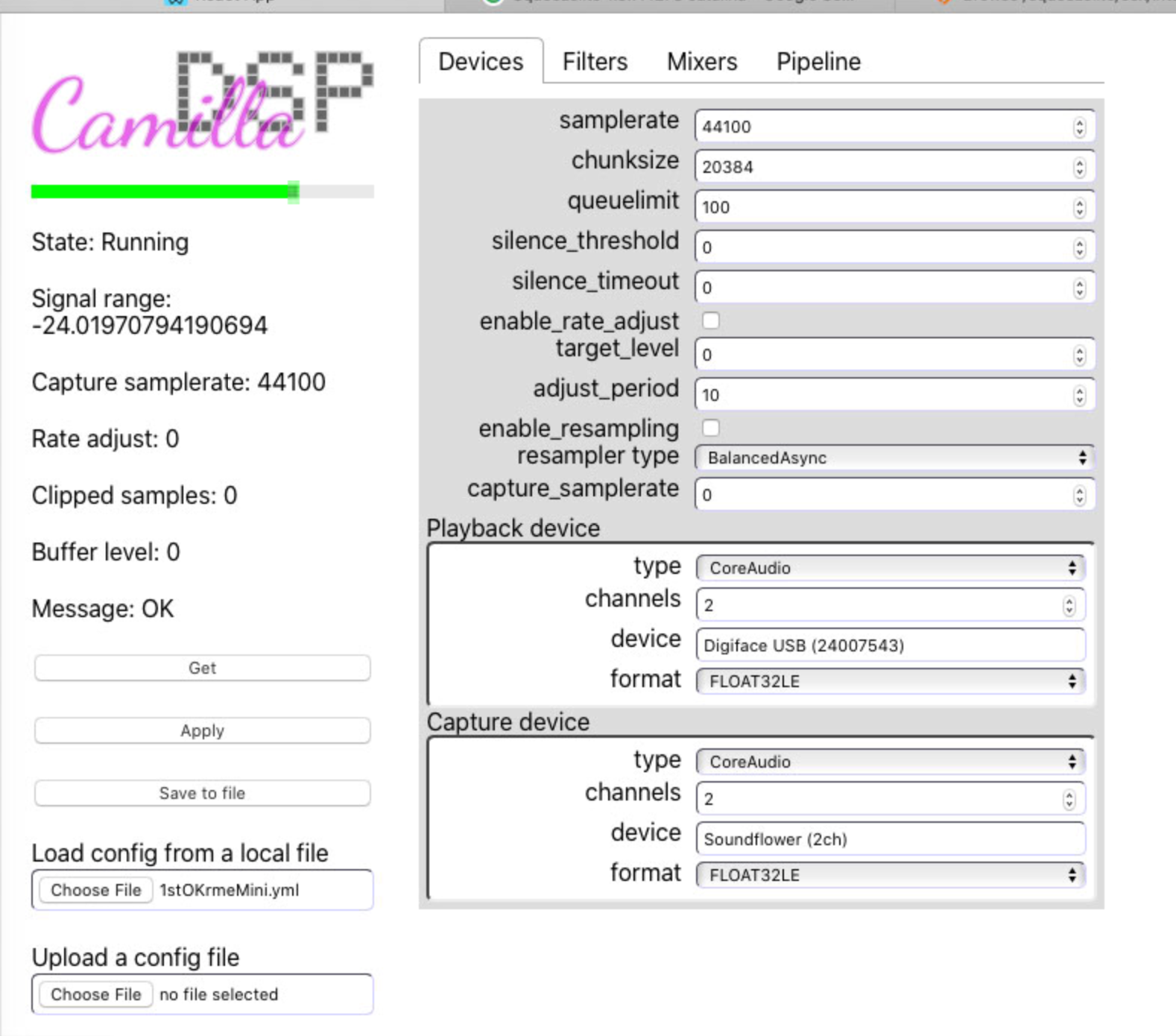

And set the "target_level" to about half of "chunksize"...
It's a synchronous s/pdif (toslink) DAC. Now I run it with rate_adj and chunk size as your suggestion - seem ok.
What does adjust_period do? Will that not be given by itself?
Synchronous, asynchronous... It's so confusing.
Asynchronous USB means that the DAC has its own master clock, and "calls" for more data over USB as needed. The source has to adapt, and that is what "enable_rate_adjust" activates. "adjust_period" is how often (seconds) the rate is adjusted to keep the buffer at "target_level".
s/pdif is the opposite. The source has the master clock, and sends data at fixed rate. So "enable_rate_adjust" shouldn't be needed..? 😕

No confusion here 🙂 I use an USB->toslink RME interface so my answer was correct - my DAC is still synchronous but the interfaces that Camilla sees on the computer it is executing on is indeed asynchronous as it is USB 🙂

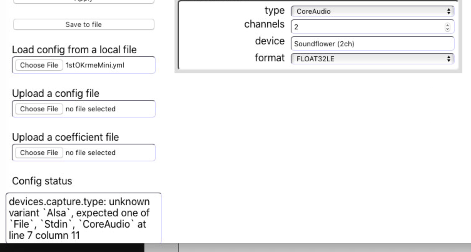

Thanks, yest I have seen this too. It has been working before, not sure how I broke it. It's on my growing todo-list...GUI config status - old status remains... even if new file is loaded I still see this old message..

The rate adjust actually doesn't have anything to do with sync/async. The problem is that you may have two clock sources, one for the device that CamillaDSP captures audio from, and one for the device it sends it to. It doesn't matter what these devices are (a USB DAC, a virtual soundcard, a dac connected to a soundcard via spdif etc).Synchronous, asynchronous... It's so confusing.
Here is Henrik's doc on the settings:
GitHub - HEnquist/camilladsp: A flexible linux IIR and FIR engine for crossovers, room correction etc.
A virtual sound card like SoundFlower, och ALSA loopback emulates a sample clock with timers. This wil be close to the exact rate you ask for, but never exactly. The same goes for any physical card.
Let's make a really simple example, say we run on a mac with the SoundFlower virtual sound card as source. We have it running at 48kHz. SoundFlower sets up some timers to generate a 48kHz rate, but the result is always a little off. Lets say it's 47990 Hz.
We are using an asynchronous USB dac. That means the hardware clock of the dac sets the playback rate. This will also be a little off. Let's say 48010 Hz.
Now what happens is that every second, CamillaDSP gets 47990 frames from SoundFlower, while the dac wants 48010. So every second we receive 20 frames less than we send out. If we start with 1000 frames in the buffer, in 50 seconds the buffer will be empty, and we will get an underrun (with a click or pop).
We want to keep the buffer level constant, so we can either
a) Adjust the rate of one of the devices.
or
b) Use resampling to stretch the 47990 samples into 48010.
Both ways get the job done, but a) is the preferred solution. Unfortunately this only works with devices that allow the rate to be adjusted. For now that list contains only the linux Alsa loopback capture device, not SoundFlower on mac or VB cable on windows as these AFAIK don't allow the rate to be adjusted. At some point it will work with the USB Audio Gadget mode too.
b) uses the asynchronous resampler to stretch or compress the audio as needed. This works on all supported systems with all devices.
Both approaches use the setting "adjust_period". This is the time between adjustments and defaults to 10 seconds if it's left out. This means the rate is adjusted approximately once every 10 seconds. The rate difference is measured by monitoring the fill level of the output device buffer.
