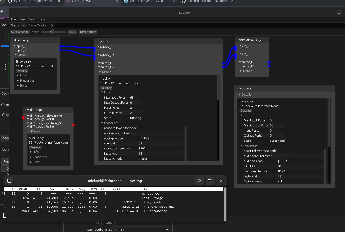

If installing latest Fedora 39 and keeping pipewire and wireplumber completly vanilla, I have no luck in using the camilladsp pulseaudio backend to connect to either monitor outputs of a virtual pipewire sink, or to a "coupled stream" (Virtual Devices) where virtual sink input is forward to a virtual source, then used as capture device in camilladsp. Nothing pipewire related seems to work with the pulseaudio backend in camilladsp, log -v serves lemons:
2024-03-22 14:24:15.832269 ERROR [src/bin.rs:307] Capture error: PulseAudio error: Connection refused, code: 6
2024-03-22 14:24:15.832293 DEBUG [src/bin.rs:309] Error while starting, release barrier
This also happens with an entirely newly created, unused basic virtual sink via pactl load-module, no connection on monitor. Gnome sound settings will connect to the monitor outputs to said sink (for showing output on the simpel spl meter). Can be visualized with coppwr.
Anybody have had any luck using pulseaudio backend in camilladsp (2.0 onward) with vanilla pipewire, bypassing alsa loopback method? I may have confused myself by now!

That looks as if it can't connect to pipewire at all. Is it possible that camilladsp started before pipewire? Do you start it with systemd or manually?Capture error: PulseAudio error: Connection refused, code: 6
I will, once I figure out a way to do it that doesn't become horrible to implement and maintain. No luck so far..Please add naming to channels that is consistent between Mixer and Pipeline
Hi HenrikThat looks as if it can't connect to pipewire at all. Is it possible that camilladsp started before pipewire? Do you start it with systemd or manually?
I start it with systemd, I tried using "ExecStartPre=/bin/sleep 10", but makes no difference. I also start and stop the service via systemctl manually.

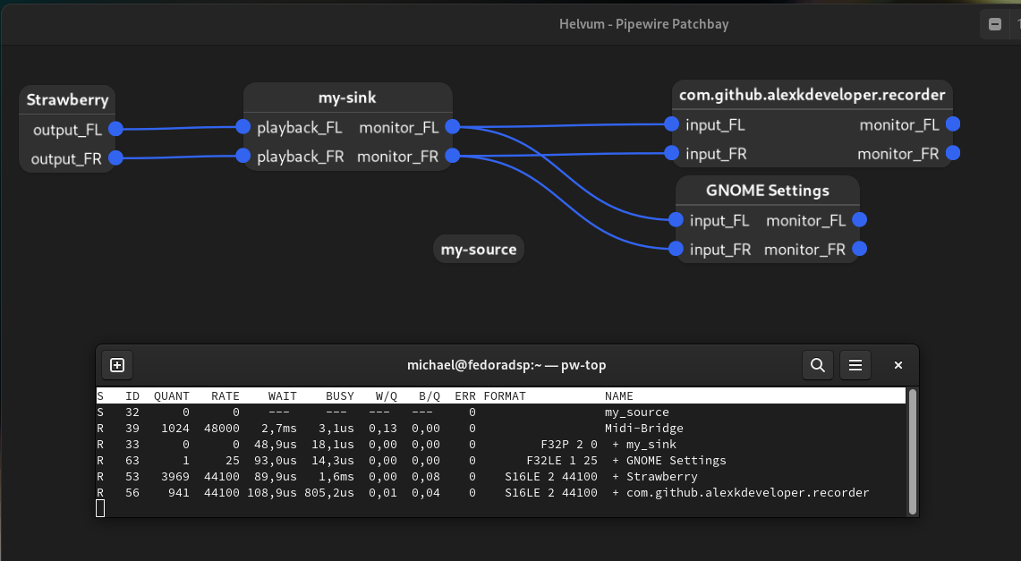

If I change the capture device in camilladsp to alsa and use the null provided, camilladsp will start running. When I change back to pulse audio backend and use any entry I can imagine usable, including manually created sinks via pactl or pw-cli (or a source but not using monitor ports), camilladsp will not proceed from "Starting" and give connection refused, code 6 in its log.
I am not sure the .monitor syntax is still valid with pipewire, I assume so (So one can do "my-sink.monitor" as entry in Capture device for camilladsp. I use "node.name" from pipewire, not "media.name" or "node.description"). Monitor ports seem avaliable as Gnome Sound Settings will attach to those for input for its visual dbfs meter, seen in coppwr or helvum.
Some kind of permission error possibly? Something wireplumber related?
You can see on attached screenshots that gnome settings and a random audio application will attach to the sinks monitor ports (That sink is created with coupled stream Virtual Device - Coupled stream), but I currently cannot get camilladsp to do the same.
So then CamillaDSP probably runs as root. Pipewire and Pulseaudio are user services, root is probably not allowed to to connect. Try starting CamillaDSP manually from your normal user account. If that works, then you can modify the service file so that CamillaDSP runs as that user.I start it with systemd
