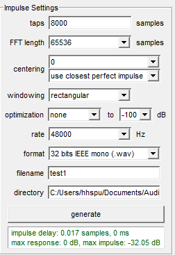

Mikey, how many taps have you specified in rePhase and where in the CamillaDSP config is the .wav file ?just generating a low-pass Butterworth filter in rePhase on the "Minimum Phase Fitlers" tab, then using the .wav file in CamillaDSP.

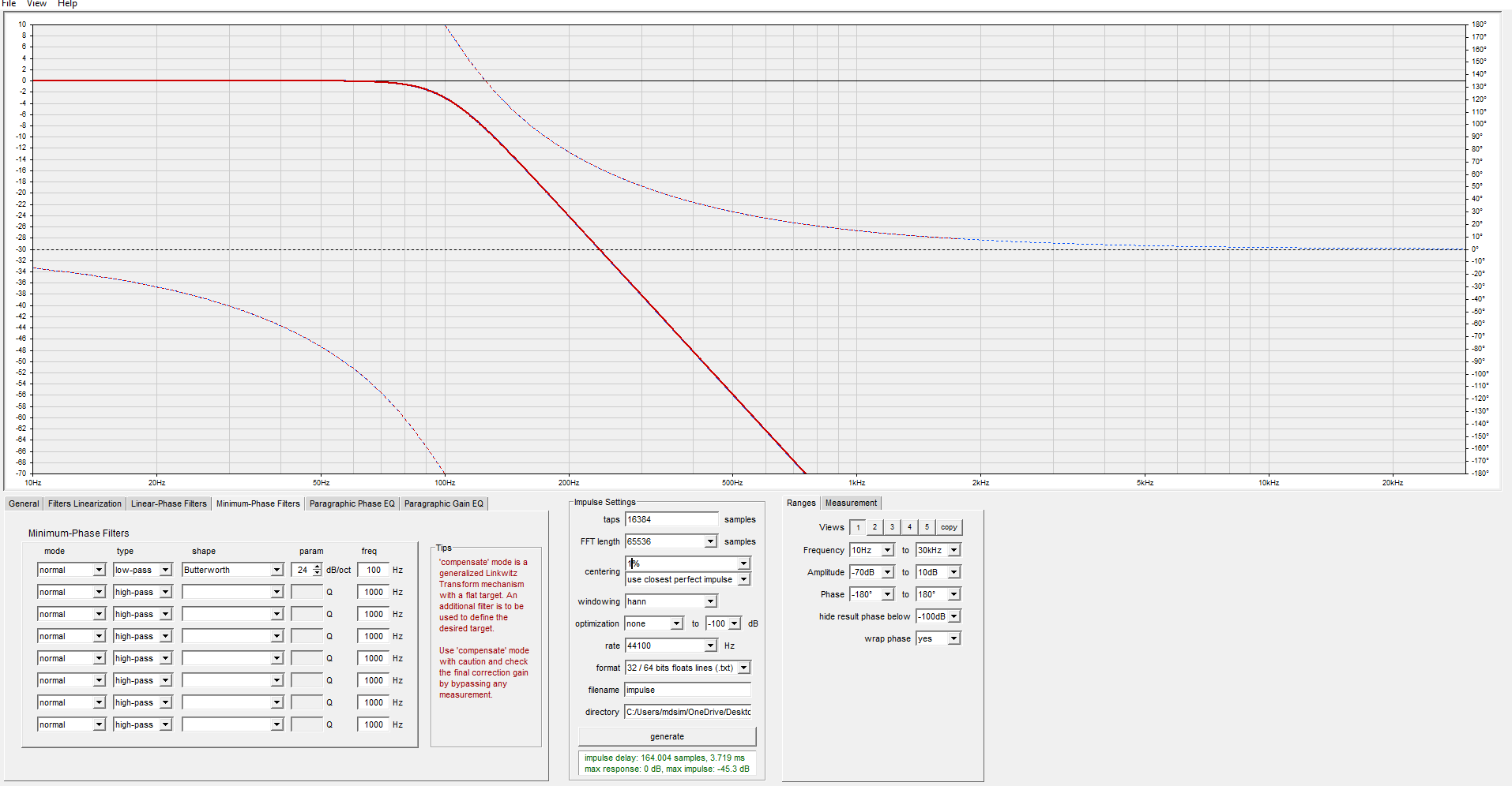

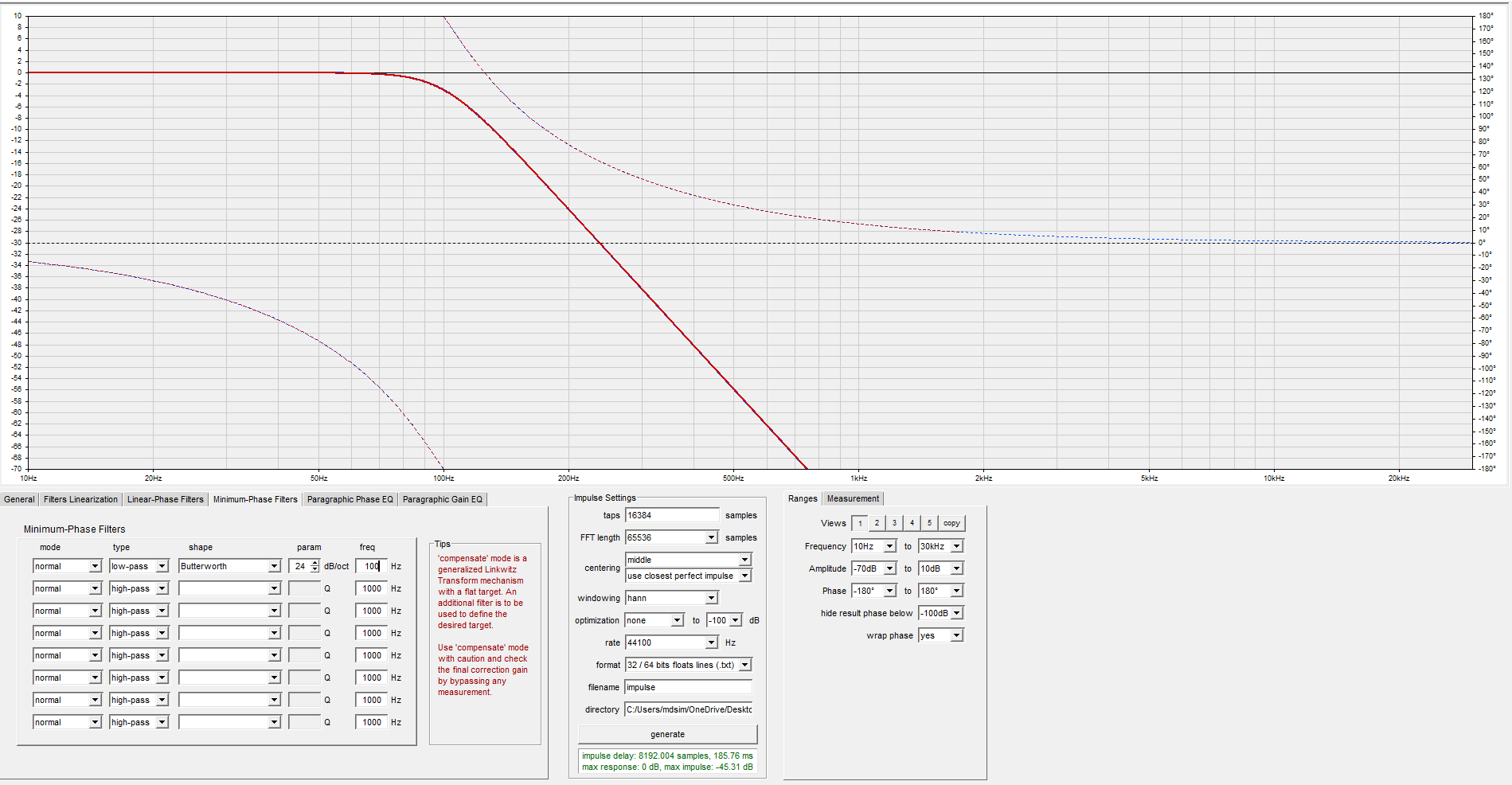

How do you have your centering set in rePhase? The default is middle which will give you a lot of unnecessary latency for minimum phase filters. rePhase should tell you the latency, what does it report?
Here is an example of a minimum phase BW4 100 Hz LPF using 16K taps at 44.1K with middle centering. The rePhase report delay is 186 ms.
Using 1% centering gives 4 ms delay. It should be 0 ms if you use 0% centering.

@Wirrunna a lot, but I though minimum-phase wouldn’t introduce a delay. Looking at the wav file though showed a ton of leading zeros, probably due to the “middle” setting I was using in rePhase.
@mdsimon2 I was using middle centered, which is giving a huge string of leading zeros with a ton of taps and a simple filter. Going to trim those zeros and see what happens.

Okay, thanks to @fluid in the rePhase thread, my delay was my user error in rePhase. When creating the filter I was using middle centering in the settings, I changed to "0" and "use closest perfect impulse" and now no more delay.
EDIT: one more quick test, 131k taps with a 15kHz low-pass, doesn't seem to introduce any perceptible delay. Applied to left channel only and listened to someone clap on a youtube video and there doesn't seem to be any "double-tap" or anything like that 🙂

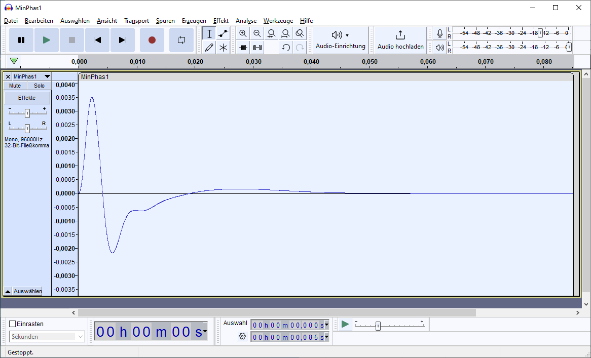

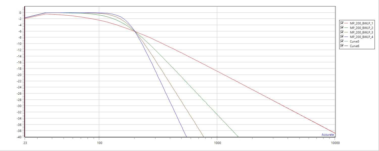

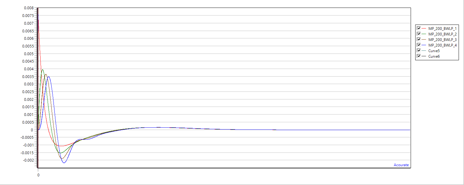

Better control once again your filter after having generated it once again. Hopefully with the correct settings.Yep, here's a 200Hz low-pass generated in rePhase, exactly in the middle of the file. What should I do?
As is, the graph you showed with it's irrgular shape and it's null interval is nothing but a weird mess, regardless of any leading zeros and/or so. If such a filter would unexpectedly produce something like a BW 200Hz LP amplitude characteristic at all, then it's phase certainly will be cruelly misbehaving. Instead, a correct 8k BW LP 200Hz minphase looks like this:
You cannot have an adequate resolution at low frequencies with short FIR filters like this 8k filter. This is why the continuity if flawed below some 50H in this example. Better go for 64k or 128k. A minphase filter will not introduce any substantial delay anyway, independently from it's length.
CamillaDSP, as any other convolver, can only be as functional as the FIR filters set up. If you are in doubt of the FIR's filters quality, then you better may resort to the inbuilt and therefore always precise IIR filters of CamillaDSP where suitable.
Yes sure there are use cases for dithering at > 16 bits, but since most people use delta-sigma DACs I would not give a general recommendation to use dithering. Some people yes, most people no.On R2R DACs distortion can lowered handsomely even by dithering

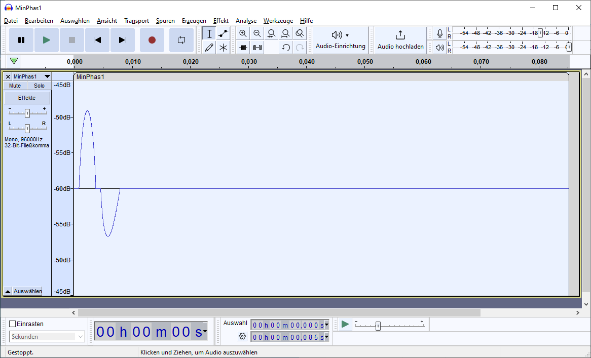

It's probably fine. The vertical scale in that graph is set to dB which makes it look completely weird. But it wouldn't hurt to also look at it on a normal linear scale, it should look similar to the one from @Daihedz.As is, the graph you showed with it's irrgular shape and it's null interval is nothing but a weird mess
It is fine! You were right. Not only probably. Right straight away!
I generated a 32Bit WAV of the BW4 200Hz LP and exported it to Audacity, to control how "my" filter looks like there . In linear graph mode everything looks more or less as in Acourate. Instead, in Log/DB mode the graph looks as weird as I mentionned it in my post. Therefore both filters, the one generated by RePhase, and the one by Acourate visually seem more or less identic. And probably they will be.
