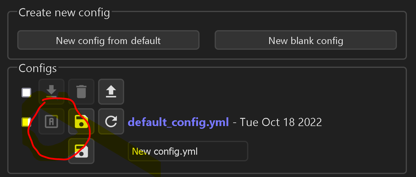

With both settings enabled which method is actualy used on Linux?
Backend 1.0.0 on RPi-OS (Debian)

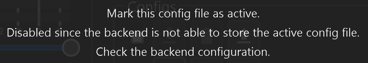

Only enabling 'update_config_symlink' button on the GUI won't let us select an active config.
To enable the button 'update_config_txt' need to be active.
When I'm on this topic. Text below had me check file permission on the config directory. Reason being the wording: "not able to" rather than deactivated. With my interpretation implying there is something wrong with the setup. With manual saying symlink are preferd on linux and I already had it activated it I had me spinning the wheel for some time 😉
Code:
pi@RPi:~/camilladsp/gui/config $ nano camillagui.yml
update_config_symlink: true
update_config_txt: false
sudo systemctl restart camillagui
Code:
update_config_txt: true

If both are enabled, it will update both symlink and text file. When reading it will go for the symlink.When I'm on this topic. Text below had me check file permission on the config directory. Reason being the wording: "not able to" rather than deactivated. With my interpretation implying there is something wrong with the setup. With manual saying symlink are preferd on linux and I already had it activated it I had me spinning the wheel for some time 😉
The message means that there is something wrong with the symlink setting. Is there perhaps already a regular file with the same name? The backend should print a warning with more info when it starts.
Thank you! Yes I can confirm this where true at some point 😉 Had it sortet already but didn't check the hover text after.The message means that there is something wrong with the symlink setting. Is there perhaps already a regular file with the same name?
When I figured out the logic my script now create a symlink that CDSP can write over. And camilladsp.service now use this symlink at statup.

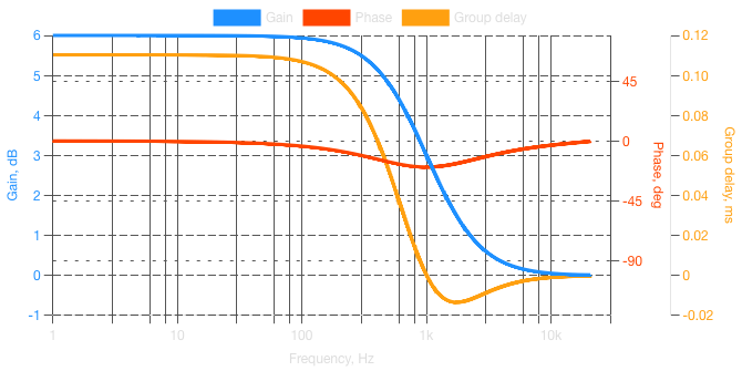

Henrik, please explain which frequencies the lines represent. It looks logarithmic but I cant figure it out...
So its: 10 Hz, x Hz, y Hz, z Hz and 100 Hz - solve x, y, and z 🙂
Sounds like a potential bug, I'll take a look. I modified the code behind that quite a bit before the release.I've noticed some odd behavior with the Quick Config Switch in the GUI.
The lines are made automatically by the plotting library. It seems that generating good tick marks for every possible zoom level is really tricky. I have tried different ways but none worked better than the default. So I went back to using the default, but then I look at what it came up with and hide some labels (because there isn't space for displaying all of them nicely).Henrik, please explain which frequencies the lines represent. It looks logarithmic but I cant figure it out...
I think the ones without labels between 10 and 100 are 25, 50 and 75. But I'll have to check to be certain.
Writing them out I understand will be messy. Hoovering->display would be nice... trying... 🙂
Hoovering gave: 30, 60 and 80 🙂
If one hoover at an intersection between a scale and a trace, the frequency is revealed.
Thats usable.
