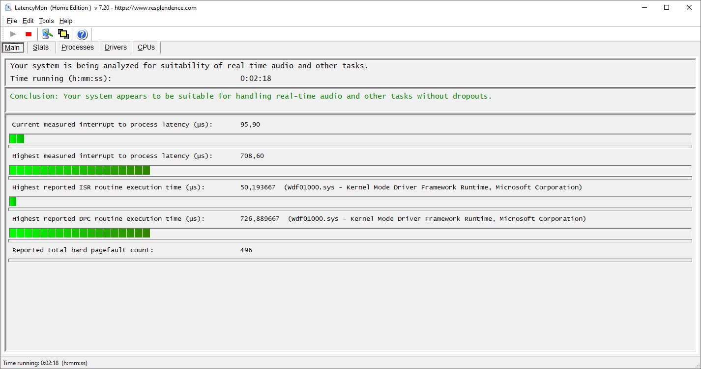

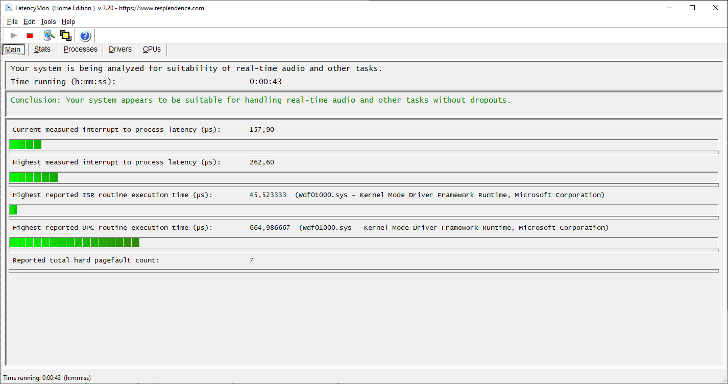

Attached are config and the two debug logs (zip file). On the first run I just first waited with Spotify playing and nothing else going on. Got tired of waiting, tried opening diyaudio on Chrome and almost immediately buffer underrun. Playback never recovered.
At this time I also noticed the post related to LatencyMon and installed it. First image is with the playback restarted and everything playing nicely.
On the second run I did not wait but opened the diyaudio web page again and got buffer underrun. LatencyMon did not seem to indicate any problems during the playback or at the failure (second image).
Normally the buffer underruns have occurred during background playback with no user interaction taking place. But of course Windows could be doing whatever it thinks is important at any time.

The longest latency in the 2nd run did triple over the 1st run. You might want to let LatencyMon run for a few minutes (across multiple runs) to catch distributed transients. Latencies don't always get caught on a single short run. With extended runs on my Windows laptop, the Microsoft i8042 Port Driver and the Microsoft TCP/IP driver causes undesirable issues.
If changing the priority fixes the problem, it is most likely a scheduling related issue.
