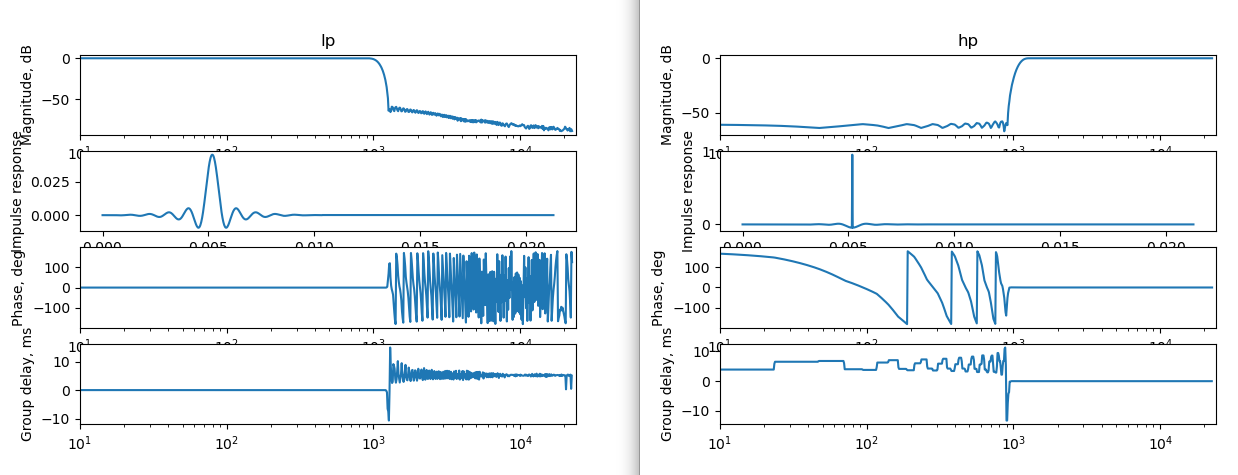

I have a question about importing FIR filters from e.g. RePhase.
I'm trying to generate a relatively simple lowpass filter for a crossover. The curve looks like you'd expect it to look in RePhase.
There is a ported enclosure phase adjustment but the phase is fine otherwise. This shows the original filter and generated filter.
But when I import it into CamillaDSP, no matter what format I use, it shows the filter and impulse looking OK but the phase looks worse than the actual speaker measurement.
Settings for this particular export are:
Note that biquad frequency reponse plots look exactly as I'd expect.
Is this normal or am I missing something to get the proper results?

mdsimon2 is right. The phase includes the delay of the FIR filter, which means at wraps around a lot. Just ignore it! I tried making it smart to plot it nicely, but that turned out to be really (really!) challenging. I could never get it reliable.
Ok phew.
I did load the impulse response into REW and it looked good.
Maybe the right course while it isn't showing properly is tonight it and add a user-friendly notice that it is omitted deliberately?
Thanks guys.
Yeah REW is dong some clever stuff to get the phase right. I think I just need to spend more time on it. When I do that I will also finish the group delay plot (which also relies on a well-behaved phase). That one is nearly finished.
Something like this?
For now it just looks for the largest peak in the impulse response and uses that position as delay zero. I also added a group delay plot, which seems to work fine for all filters. Both phase and groupdelay become quite strange in the stopband of brickwall filters, but that's kindof expected as it mainly depends on numerical noise there.
It can be argued if it's really correct to remove the delay of the FIR filters for the phase plot. But when not removing it, then even if the plot is techically correct, it's still completely useless to look at...
