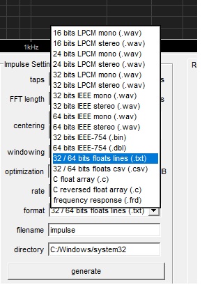

Brutefir takes the .bin files and sounds good.
The latest "rawfiles" should work with .bin, .dbl and .txt. Just set the format to FLOAT32, FLOAT64 or TEXT.
Could you attach the filter you tried?
Works. FLOATt32LE, BIN files.

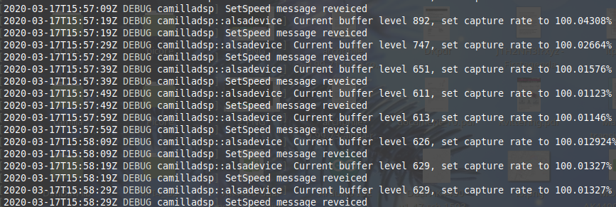

Hello... So i finally made it home today 😱
I build the new rawfiles with 32bit.
Everything seems to work now !
I will report back when i have testes/tried it for a while about glitches, but so far it's looking good regarding this too :xfingers:

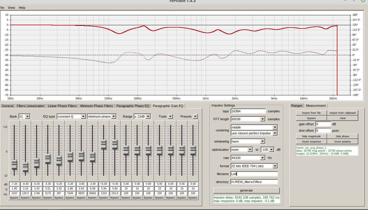

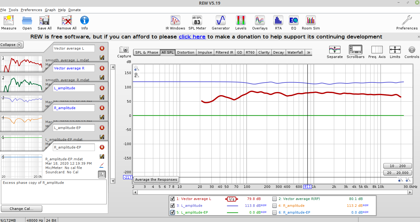

Hi...
So i found this link http://forums.melaudia.net/attachment.php?aid=22240
And took some measurements at my shop/office, and followed the guide (well i think i screewed small parts of it up, but it's my first time😛)
I loaded the filter in the camilladsp config :

Really worked 1. shoot 🙂

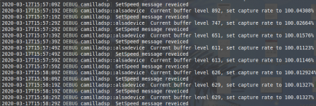

I really have to adjust the rate settings, as i still have some glitches (could be the crappy dac through)
[2020-03-18T12:39:33Z WARN camilladsp::conversions] Clipping detected, 14 samples clipped, peak 104.11042%
[2020-03-18T12:39:34Z WARN camilladsp::conversions] Clipping detected, 2 samples clipped, peak 100.31446%
[2020-03-18T12:39:34Z DEBUG camilladsp::alsadevice] Current buffer level 697, set capture rate to 100.02098%
[2020-03-18T12:39:34Z DEBUG camilladsp] SetSpeed message reveiced
[2020-03-18T12:39:36Z WARN camilladsp::conversions] Clipping detected, 1 samples clipped, peak 100.34209%
[2020-03-18T12:39:36Z WARN camilladsp::conversions] Clipping detected, 3 samples clipped, peak 104.145256%
[2020-03-18T12:39:38Z WARN camilladsp::conversions] Clipping detected, 1 samples clipped, peak 100.73582%
[2020-03-18T12:39:39Z WARN camilladsp::conversions] Clipping detected, 7 samples clipped, peak 104.35543%
[2020-03-18T12:39:40Z WARN camilladsp::conversions] Clipping detected, 2 samples clipped, peak 101.6496%
[2020-03-18T12:39:41Z WARN camilladsp::conversions] Clipping detected, 1 samples clipped, peak 101.32773%
[2020-03-18T12:39:44Z DEBUG camilladsp::alsadevice] Current buffer level 629, set capture rate to 100.01327%
[2020-03-18T12:39:44Z DEBUG camilladsp] SetSpeed message reveiced
I have attached the filters in .bin / .txt & .wav (I missed some "real" files along my way to test, therefore i attach them here for othe newbies to look at)
Jesper.
