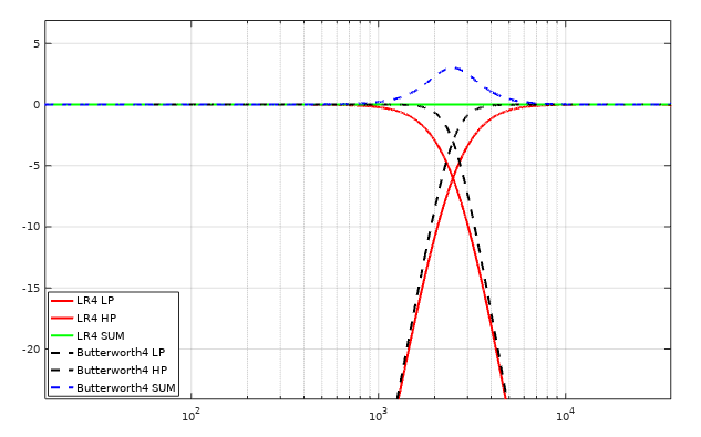

BTW, looked the sources and (if I got it right) looks like you use Butterworth type LP/HP filters for IIR type filtering ... which does maybe not produce the best possible response as shown in attached comparison plot.
Here's Octave/Matlab code for the LR4 vs 4th order Butterworth response comparison I made (these are 4th order filters but one can transfer those to 2nd order sets):

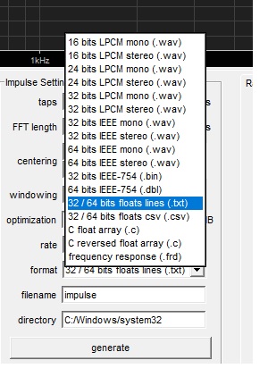

What does the plot script show for your Rephase filters? What format are they in?
There is a new version that can handle raw files in a bunch of formats, just check out the "rawfiles" branch.
Mono filters should not cause any trouble at all. The cofficients file should anyway only contain coefficients for one channel.
Running new version from the RAW branch files.

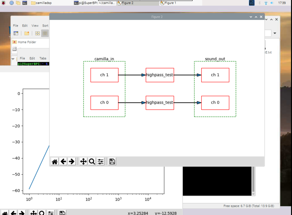

I've got this crappy new cheap dac working, but only with S16_LE, but nevermind that now, this is just for testing.
So all my "Alsa" configs are working, also when showing the .py script.
The playback are full of glitches, and perhaps i have to adjust the dac/squeezelite settings, BUT i would also like to try the output rate control, what do i have to "git" for trying that ?

I installed this version allready, how do you make it write out the buffer, like this you posted a while ago ?
Current buffer level 752, set capture rate to 100.027214%
I am not sure it's working with my .yml file?

I created the Fir filters in Rephase. In Brutefir I used .bin filters and those worked.
Probably the culprit is I need mono filters. Right?
Forgot to note that LR4_HP4 filter implementation presented in quoted post has bad LF issue when value of fc is set to less than 1/63 * fs/2 (i.e. 350Hz @ 44.1kHz) ....

Config file error:
Could not open config file!
pi@SuperBPI:~/Cfilters $
Playback are working, but not flags.
Jesper.

Still the sound with Repahse generated filter (opposed to your IIR filters) is not the way it should.
What filter in Rephase should work best in Camilladsp ?
Brutefir takes the .bin files and sounds good.
