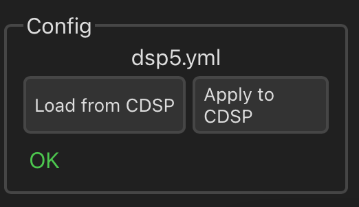

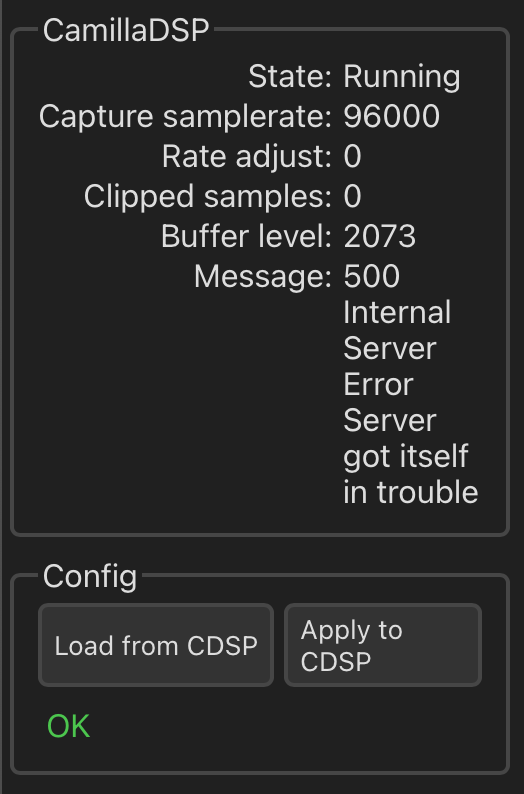

First wanted to say thank you to Henrik, I've switched all of my multichannel DSP systems from miniDSP to RPis running CamillaDSP and I am very happy.
I just started using the web interface as I wanted a more real time way to update configurations and visualize the results. It mostly works very well but I think I may not fully understand how the configuration is updated.
My CamilladDSP script and my active_config in camillagui.yml both point to the same .yml configuration file. When I go to the web interface it seems to correctly read this configuration file however there is no specific .yml file name shown in the lower left. As a result when I make a change in the web interface and click "Apply to CDSP" to apply it I get an error stating "Internal Server Error Server got itself in trouble".
If I go to the Files tab and either load or save the configuration it will be shown in the lower left and I am able to make changes in the web interface and apply them by clicking "Apply to CDSP". This works well but if I refresh the web interface I need to load / save the configuration again to be able to make updates.
Is this expected behavior? Is there a way to make it so that I can always make changes in the web interface and apply them without saving / loading the configuration?

You need to "get" the config from the DSP after a page reload...
I don't refresh the page when doing EQ sessions - thats makes it OK... there is no need really.
I'm afraid I have to say that the new GUI has not improved the user friendliness for me. Its (still) somewhat confusing to me...
Thank you for the info.
By "get" the config I assume you mean the load / save procedure that I described? Or are you referring to the "Load from CDSP" button in the lower left?
I agree that I found the manual configuration file much easier to understand than the GUI, although another motivation for pursuing the GUI was to play around with volume control in CamillaDSP (which seems to work very well).
Michael
There is a way to fetch whats is currently active in the DSP and populate the GUI with that indo. In this way, you can actually develop new/other filters while your system is playing and save that work to file and come back to tweak whats playing by do (I think) Load from CDSP.

There are four places where a configuration can be:
a) In a file in any folder on your computer (the where you run the browser)
b) In a file in the folder where the backend stores configs (a specific folder on the machine that runs the backend)
c) Loaded in the CamillaDSP engine (in ram of the machine that runs camilladsp)
d) Loaded in the Gui (in ram of the machine that runs the browser)
Browser, backend and camilladsp can all be running on the same machine, or the camilladsp+backend can be on one while the browser runs on another.
The Config box on the lower left lets you transfer configs between c and d (Load from CDSP, Apply to CDSP).
The Files tab in the gui lets you transfer files between a and b (Upload, Download, Save to somename.yml), as well as between b and d (Load somename.yml).
I guess some of the confusion comes when running everything on the same machine. Then upload, download etc isn't very intuitive. But think of it as if CamillaDSP was running on a separate server somewhere, then I think it makes more sense.
If you have any suggestions for improvements, please let me know. Just remember that things must make sense in all the different ways the gui can be used. This is where it gets difficult. And I won't make separate versions for running locally and remotely.
There is a live mode planned, that will (optionally) apply changes directly. This will then keep c and d in sync.

CDSP is already a abbreviation. Problem us that it conisides with the "product" name so it is hard to know what it really is...
Would it help to skip the "C" and write just "Load from DSP" & "Apply to DSP"?
And also update the tooltips to something like this:
"Get active config from the running CamillaDSP process"
and
"Apply config to the running CamillaDSP process, and save to somefile.yml"
