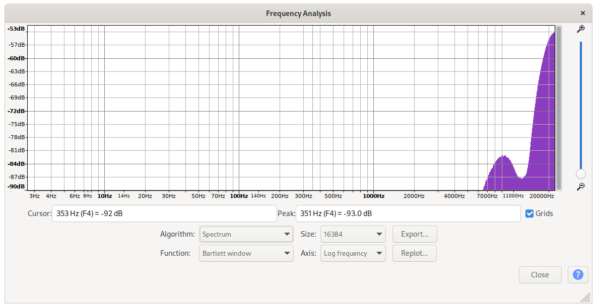

What could cause this:
clippedsamples
0
state
Paused
capturesignalrms
[-1000.0, -1000.0]
playbacksignalrms
[-78.15968, -77.54676]
capturerate
44100
rateadjust
0.0
bufferlevel
0
clippedsamples
0
state
... and it seems to flicker a tiny bit...
My player is stopped. Still, ther seem to some playback.. but I cant hear any noise etc... but it is low - 77dB so.. but still - should this not be much lower?

This is the source if the noise you are seeing!
The shaped dither types put most of the dither noise in a limited frequency range at the top. The sum of the needed noise energy is constant, if you compress it in a narrow range, the amplitude gets larger.
This is what the noise spectrum looks like (after boosting it by 50 dB):
All the energy is up close to 20 kHz. In summary, everything is as it's supposed to be
