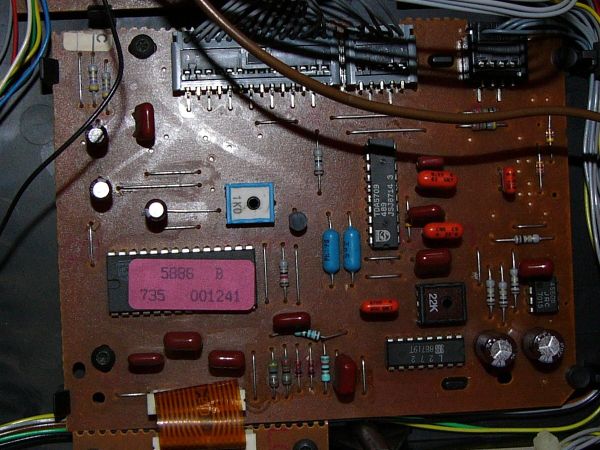

Hello Anton
The CD 3 has the same servo board as the Arcam 70.2 I have the schematic for this but it does not show the values of the small value surface mount capacitors or resistors which I wish to replace with better quality ones to see if it can improve on things , I did so with a CD 63 and it did a world of good but that was easier because of the normal capacitors on it's servo board .
Having trouble with the old sight these days hence the want of an entire CD3 service manual to make it easier.
The CD2 is virtually the same except it has a 1k trim pot instead of the 4.7k and a few minute other things , but I have heard this may vary as some Cambridge CD2's had CDM2 mech's and some had CDM4 mech's with equivalent servo boards ?

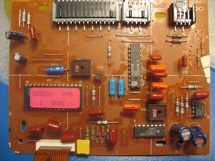

That board is pure stock Philips, I suspected as much. It's a 5886 non-uP servo board, one of the last ones before the servo was integrated into the mainboard. Unlike most of the other servo boards, this one doesn't have any major bug fixes, which is nice.
I actually have one of these, in a Philips CD670 I own. I'm not sure how many other players used it. See the photo below.
Anyway, the zipped .PDF I have attached should answer all your questions. It includes the artwork and schematic of the 5886 board.
I've also added the page that shows what adaptions are made to allow this board to drive a CDM-4. It involves changing some passive components to alter the bandwidth of the radial drive (I think that's all). The CDM-2 and CDM-4 are actually very similar servo-wise.
If you find out the number for the CD2 servo board, I may have similar info for it too.
Anton

The five electrolytic caps are the ones you should be replacing, as you can see I have replaced them on mine. If you still have problem with the board, the four tantalum caps are the next ones to look at. I would be surprised to find any problems with the surface mount ceramic caps or resistors.
Tantalum caps
Sorry you must of mistaken me , my cd player works I need a schematic to modify my player .
Though it would be nice to know the values of those Tantalum caps ?
