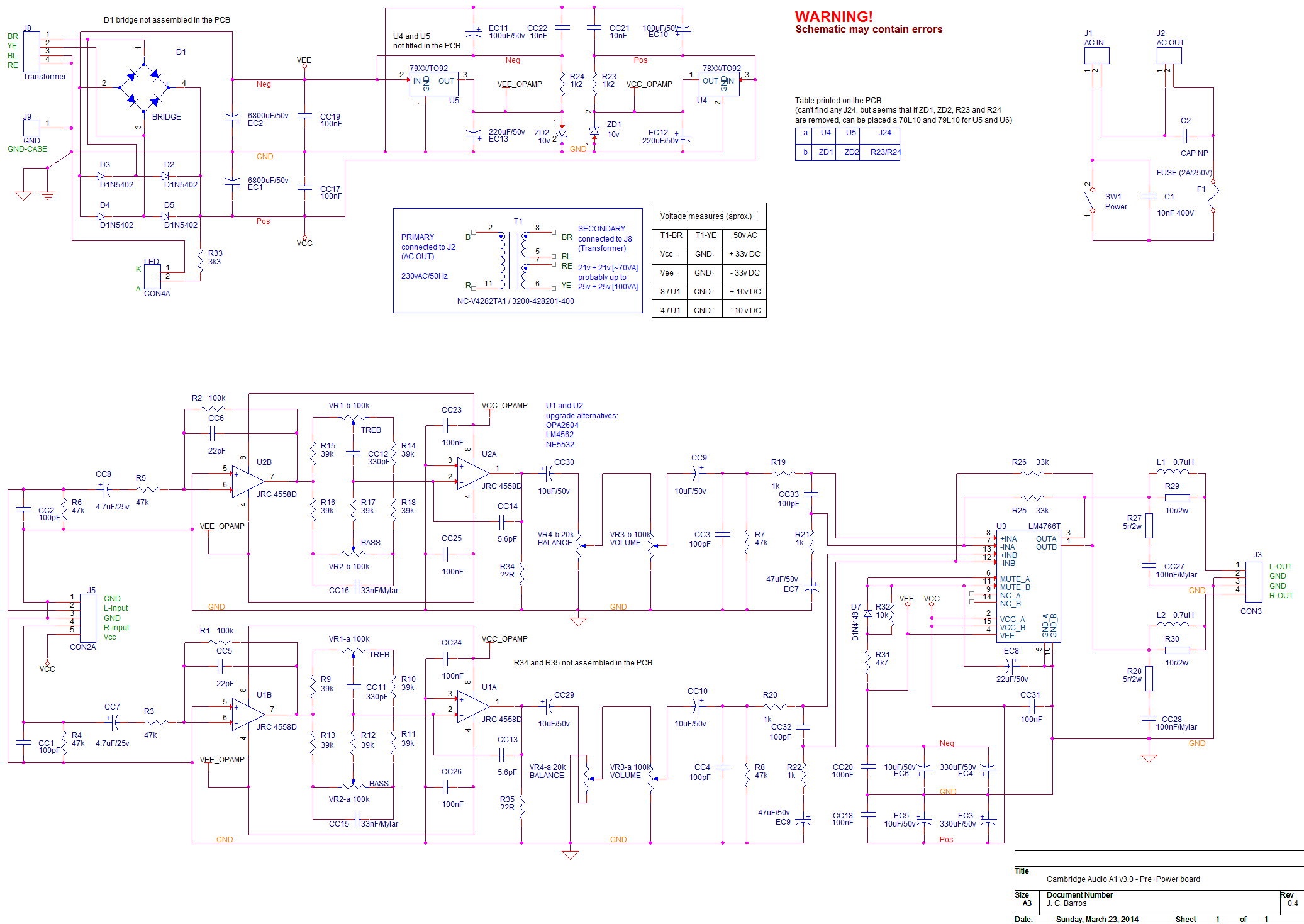

Cambridge Audio A1 Schematic
rev 0.4
Redone the schematic, hopefully in a more comprehensive way.
Goes attached in PDF and GIF.
Any corrections or suggestions are welcome.

I am restoring an amplifier A1, replacement capacitors, some resistors, and voltage offset adjustment. The unit is like new, and I'll use it as a monitor for my CD player upgrades.
I need the scheme to facilitate my work :wrench:.

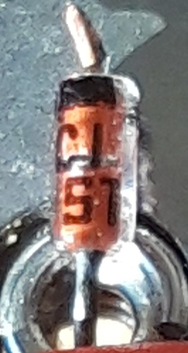

Hi All,
I am trying to identify zener diodes ZD1 and ZD2 (A1 mk3, LM4766 version).
Mine have been corroded by the glue around the capacitors.
I need to know the voltage and wattage so I can order replacements. I have attached a picture of one of them - it seems to have "C151" (or maybe "C157") marked on it, but I can't find what that code means.
Judging by the size (4.2mm x 1.8mm) it looks like its 500mW but I'm not sure.
The brilliant schematic posted by Mortymore rates these as 10v, but on the circuit board next to U2 (4558 opamp) it says "15v", which makes me wonder if the zeners are 15v?
Can anyone help?
Hot melt gunk, the thinking might have been to seal these from airborne moisture and contaminants. I live in a valley area where mist is common in winter after it rains. You can use silica get packs to absorb residual kitchen, laundry and bathroom moisture that gets around the home. I put some inside my equipment.

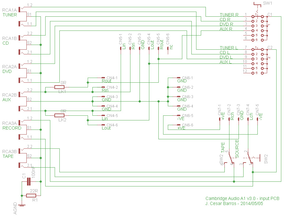

A1 mk3 phono module
OK, having got my A1 cleaned up and working, I am thinking of affordable ways to add a phono stage module. Either making one, or salvaging from a broken amp from eBay.
I'm confused though - The pins on the input board that feed the phono preamp module include a +ve and -ve power connection which is taken via connector "CON2A" from the main board to the input board.
However on my A1 mk3, CON2A has only 5 pins - 4 pins for the audio signal (two shielded cables) and 1 pin for +ve (orange wire).
This means there is no -ve power on the input board and the -ve pin seems to be shorted to ground.
The A1 mk3 SE, A1 mk1, and the equivalent Ariston AX-900/910 all seem to have 6 wires from the main board to the input board and include a blue wire that is presumably -ve.
Does this mean that a phono module board taken from a mk3 SE, mk1 or Ariston amp, will not work with my A1 mk3?
An update for anyone who is interested: I bought an Ariston AX-900 which had the Cambridge Audio phono module fitted, and transferred it to my A1 mk3.
It works fine. It looks like the -V rail present on the input boards of some amps is not used in the phono amp and it only requires +V. 🙂

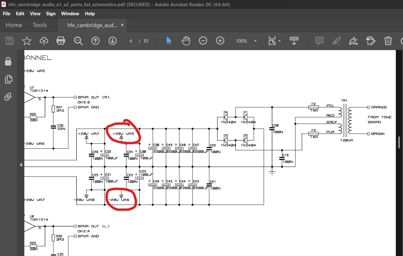

This is where I got the 28 volts from:
and working back from that gives 28/1.414 giving 20 volts AC.
