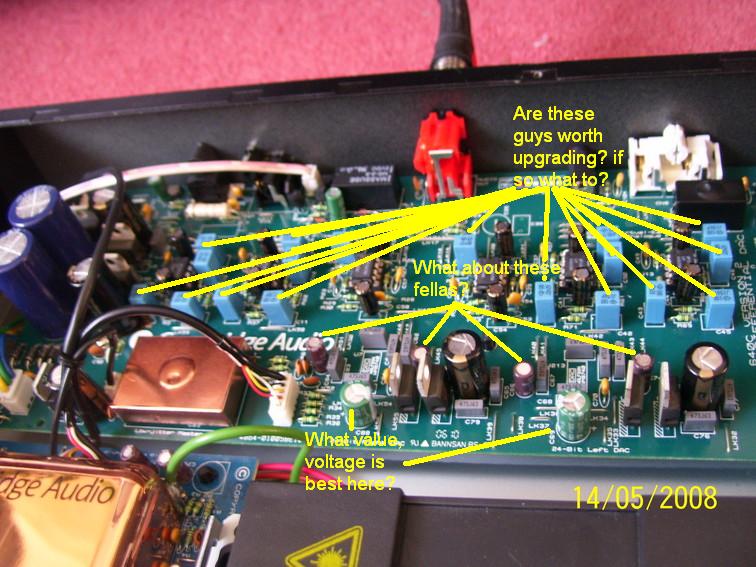

I run the regs on the V2 @ 15V as the heat generated was too high @ 12V.

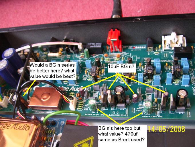

The green caps are on the output of the regs for the dac digital 5V. I uses ZLH caps here, FC would probs be ok too.

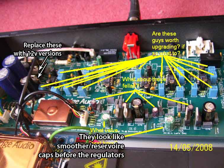

C84 C63 C66 C74 are non polar decoupling caps for the 2 V refs on each dac chip. It would be a good idea to change these for something like a BG N (10uF 16V).

rowemeister said:I run the regs on the V2 @ 15V as the heat generated was too high @ 12V.

Oops, I forgot that my ca draws less current because only two opamps. BG Nx are the best caps to use on digital rails, no doubt.
Lee
So ulimately the above caps should be Blackgate N/Nx? Had a look on theHiFiCollective site and couldnt find 10uF 16v, only 10uF 50v? Any ideas where I can get them?

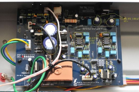

Please see pic attatched:

1)What frequency should I chose for the C1 Master Clock?
2)If I change the opamp to LM4562na, do I change the grey caps to BG 10uf 16v just like you did on your 604c v2 for my 604c v1?
3)What values of BG caps should I get to replace the two big caps rated 2200uf 35v?
4)How many S-power regulators do I need to change for my 604c v1 to have a noticeable difference and should I chose 5v?
