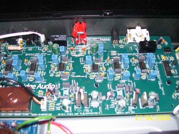

Can anyone confirm that the opamps circled in the picture below, are the correct ones to change. (Brent, I will do the rest later) Also are the little grey caps either end of the opamp the ones that need changing to Blackgates? Finally the caps circled nearest the phonos: are these the coupling caps? Am I ok to remove them if im only changing 2 opamps?

The final two opamps you will be changing are the middle two. The outer pairs are the filters. Yep remove the grey and green caps. Try them bypassed first and see if there are any strange noises when changing tracks etc. It should be ok as there is a relay for main muting.

Here are the caps to change. C21 C91 are the main smoothers but are small and too far away from most of the opamps. Changing the small 47n for the 10uF BG brings big gains.
Best bet for you is to change the relevent 47n on the opamps you are changing first and also the two main smoothers.
C21 25V 1000uF XUNDA with 470uF 16v Black Gate STD
C91 25V 1000uF XUNDA with 470uF 16v Black Gate STD
C54 47n Mylar with 16V 10uF BLACK GATE STD
C38 47n Mylar with 16V 10uF BLACK GATE STD
C10 47n Mylar with 16V 10uF BLACK GATE STD
C14 47n Mylar with 16V 10uF BLACK GATE STD
C41 47n Mylar with 16V 10uF BLACK GATE STD
C52 47n Mylar with 16V 10uF BLACK GATE STD
C44 47n Mylar with 16V 10uF BLACK GATE STD
C48 47n Mylar with 16V 10uF BLACK GATE STD
C18 47n Mylar with 16V 10uF BLACK GATE STD
C93 47n Mylar with 16V 10uF BLACK GATE STD
C103 47n Mylar with 16V 10uF BLACK GATE STD
C59 47n Mylar with 16V 10uF BLACK GATE STD
