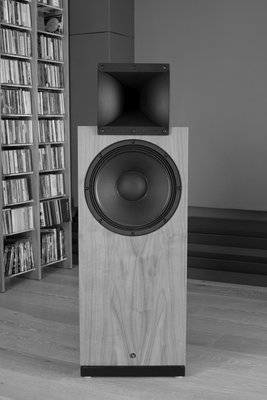

Tony Gee's Mezzo Calpamos is nearing completion. A smaller version of the Calpamos with a 12". They'll be on demo at the Dutch Audio Event in two weeks.
No clue about their weight though...
