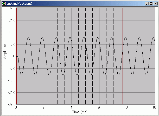

another one 🙂
on page 51 (step 34 point vi) if the instructions have been followed then there will in fact be 10 sine wave cycles, as the X maximum was set to 10ms not 4ms as in the fig on page 50.
Oh I just thought of another thing that would be usefull. Putting figure numbers on all screen shots would make referencing them much easier 🙂
also if the instructions have been followed properly the waveform should be no where near 32K.... as the levels have been set to a low level to avoid frying the sound card
screen shot below:
Tony.
edit: submitted better screen shot.
