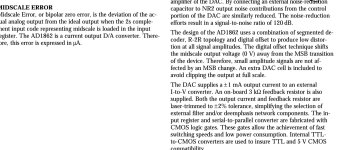

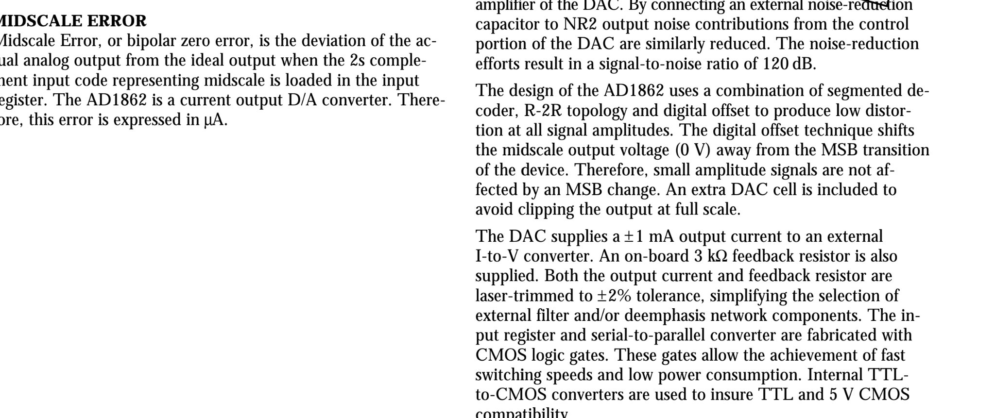

? It does have 2 dacs... I think they switch the signal to negative for one one them called BTC , and it is a negative dac which reverse the output,Guess your PCM63 chips were designed by a different Burr Brown.
Its basically a bit inverter and both signals are placed together at output, which guarantee when the digital says to augment the signal volume there is a guarantee augmentation of current, this is not true for when the signal says go down, because that topology is only additive, it cannot subtract noise, it guarantee that noise will follow proportion of the signal, in one dac the noise increase monotonous to the signal decreasing intensity.
When doing this process of BTC one bit is switched to remove the difficult zero crossing poin in the code and down the ladder switches which are increasingly complicated at this point., and the dac lose one bit doing this, both converter are 19bit but the sum is the equivalent of 20 bit... I think..
Pcm63 also I think switches
There are more advanced papers on the dac , the datasheet is a simplification of what they really did.

I have the datasheet.? It does have 2 dacs... I think they switch the signal to negative for one one them called BTC , and it is a negative dac which reverse the output,
I have the actual chips.
I can build and confirm that it does what BB says it does.
So what is the point of posting such gibberish when the correct information is so readily available?

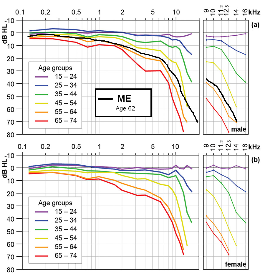

I understand that its comes not from academic couriuosity. but ist an interesting question. and a good one. and worth longer answer(just probably not in dac section)have you checked your hearing at the specialist recently? It would seem you are quite limited.
Last time i was on professional audiometry in 2019 autumn my hearing was normal. I was able to hear 16khz and 12.5khz in 25db levels(loudness curve added). during test I didnt like methods(no masking other ear, diferent headphones for 8khz and 8khz up+ which ddnt showed same results in lower frequencies (1-8khz) even its called professional it more for elderly people checking level of defness or some SSHL cases.
i test my and other people hearing(i need t for my job) quite often. I made calibrated and corected response source (from sb acoustic satori tweeter) better than headphones (which response greatly - + 5/12db depends on wearing position. tweeter when palced eaxact 1-1.5cm from ear frequency response is quite flat. its fed by Tascam US122mk2 so perfectly silent. this source provides 800hz - 20 000khz response flat up to +-1db with maimum devations +-2.5db
in very very silent room few younger people (30yo) was able to hear 3- 5db @ 1khz and up to 12khz@25db level and 16.5-17khz @60-70db levels.
mind that those are numbers without FM or ANSI loudnes curves(so you can reduce threshold by 7-10db in 8-11khz range)
any measurements below 500-800hz in levels lower than 25db would not be possible without chamber. but hering very rarely degrades on lowest fequencies (unless some rare cases like later stage Miniere disease)
in my 46 I still can hear 15.2khz at higher SPL and 8.8khz with 30db level ( would be around 20db if loudness corection included which are always included in audiometry tests)
older (50+)audiophiles can hear only from 25-30db@1khz and 8-10khz~ 50db which is quite loud. some i tested cant hear 9khz a 80db levels. one 60yo male still hear 8khz in 25db level (and 14.5khz at 70db level )whch is quite extraordinary to hear tones that high in that low treshold. and he visited and stll visiting lot of rock concerts so we are all diferent and genetic plays role, not only enviroment.
luckily our brain is perfect DSP, even persons who already have hughe drop in high frequencies need only 2.5db more level than young person who hear 10khz basicaly same level as 3khz The diference in hearing between those people is 10khz is more than 40db, yet only 2.5db elevation in speakers is needed subjectiively expierence same level of frequency response.
for academic purposes ataching average hearing of variuos ages .
