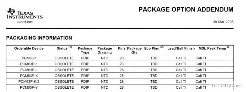

I have pcm63P-K, PCM63P-KY (16psc) and PCM63P-Y(24psc) I never realy compared AB them, but i think diferencies is not so big. I choosed Y ranking based on-I did a similar (but on a smaller scale) experiment during the previous 2-3 years. Completely identical environment, power supply and USB/SPDIF boards, I just changed the PCBs with those vintage DAC chips. PCM56, AD1856, AD1860, PCM1702, AD1865, AD1862 and PCM63. PCM63 is the best for me, you just need to pay attention to a fairly bright sound, and accordingly a suitable I/V stage. I have PCM63P-K and P-Y chips, but they don't sound identical. One complete PCM63 DAC is waiting in a cardboard box for me to build some tube I/V stage, and pack everything in a decent metal box.
1) user description of sound in 2008 I am audiophile and are sold on great lyrical expressions UNTILL i hear results
2)Burbrown datasheet rankings
In paralel with this 24psc I am working on 2psc PCM63P-KY DAC which is not lsited in burbrown datasheets (each dac 4 pcm63P-KY)- they already finished 90% and working/tested since 2024. each PCM6P-KY is MSB adjusted at factory.
comutation of digital front end is quite complicated and at the same time smple- with disconectng some power suplies and few tricks DAC works(without opening lid) with 3 digital filters ( SM5803, sm5842 and PMD100) and with 2 diferent spdif receivers- CS8412, yamaha 3436(not 3623) all those 5 parts can function in diferent conections which eatch other. I am also keen to repalce cs 8412 with sany or akm spdif receivers- I like sanyo spdif receivers but need micocontroller.
I have feeling that 4x PCM63KY with MSB adustement and active IV in some aeas can outperform 24x pcm63-Y in passive mode (which on top of that will have superior Denon digital filter comapring to ancient pmd100/sm5842) but we will see. my main goal is use fully passive IV. and unlike most sugestions in 2014 that it will not work it works . even 8x pcm56 8mA total have enought voltage for my amps (with 330ohm resitor). with pcm63 I will have 48mA per channel so resitor values will as as low as 5-10ohms- nearly as opamps and lower than discrete stages.there is not much price to pay in this implementation- except dac chips and pcb size price. buts its irevelant in this project.

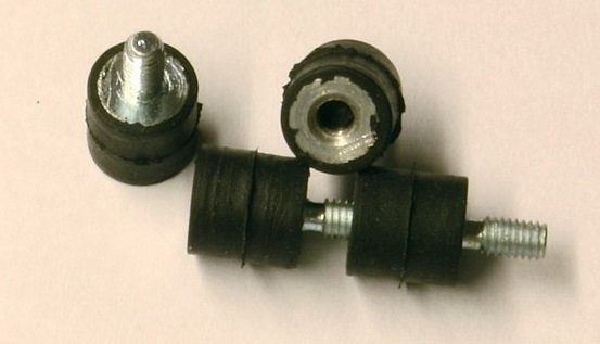

All DHT is better to use small silent-blocks to avoid microphony, I use Rod Coleman regs. for filaments + silent blocks = never problems!!!Indeed. There is always doing it proper, make it as best as possible regarding available technology, and in global it will be a better device. Now there is that subjective side, which just suits us as individuals and our pair of ears and little pink/gray mush sitting in between 😅 Best thing about diy is that we can tweak it to our liking.
