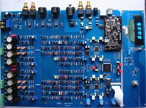

it is well engineered DAC, and quite good sonicaly (same level as Ayre qb-9 and better than hegel hd25) but I am looking for more interesting IV stage , something like this-
2x ess9018 dac(very poor power suply, but IV can be promising - not usual text book OPA design with es9018)

Why draw a schematic with the negative rail on the top? Just to make it harder to read.
The I/V resistors are referenced to the negative rail I believe, and after those you have a opamp-like discrete circuit. But I´m no expert to comment any further.
The boards you have shown have mostly small to-92 transistors, which are unsuitable for many paralleled dacs. You want big transistors and high bias current!
wel I belive,one of my dac's with 2x pcm1794A have "current steering IV" technology. is this we are talking about?-

OK , while we waiiting tam Lin answer I have just bought a new full discrete IV 2x es9018 dac PCB in picture above, for very reasonable price (arround 1K USD to doors) will see how it will sound..

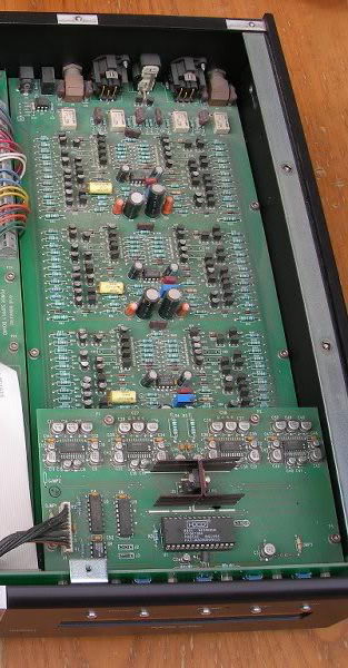

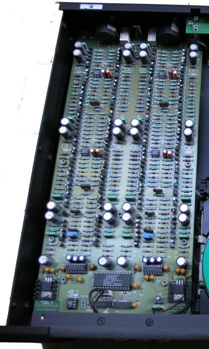

In my view, there can be no such thing as an NOS bitstream dac, regarding your PCM1794 comment. The d-s modulator is an oversampler itself, with an OS d.f. merely adding more OS. If you look at a sinewave output from an "NOS" PCM1794 versus the same from a ladder dac, it's pretty obvious one has little relationship to the other. Also, the d.f. within the PCM1794/etc. chips seems known to be markedly inferior to good d.f. chips like the DF1704 and SM5847.
I certainly agree with you on the sound of a stock or "conventionally upgraded" Accuphase DC-91. For god knows what reason, other than it was common practice at the time, each of the 32 pcm63 chips has it's own feedback i/v opamp, then into a common buffer, then into a HORRIBLE GIC filter, then output buffer and balanced driver amp. With single common passive i/v resistor per 16 dacs per channel, then my no-feedback voltage gain + line driver stages, plus way larger caps around each of the dacs(over 500 nice Nichicon caps I had to replace with larger nice Nichicon caps, exhausting), the resulting sound is absolutely spectacular, without even changing the ancient YM3436 input receiver or d/f arrangement.
Probably using Burr Browns linear phase GIC from their application notes. Here is a perfect example of something that you could have spent a bucket load of money compromised by the use of op-amps. Never could it compete with a PCM63 single DAC per channel discrete and/or tube designs. Forever compromised by the use of op-amps. What a waste of good PCM63s. Just goes to show that most stuff sells on marketing and not on sound.
