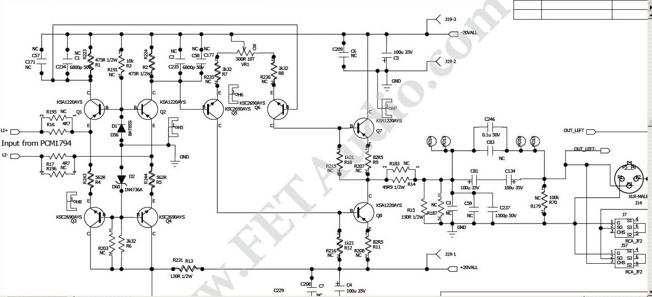

Yes I read them, but you must understand that i have never build dac from scratch, and it will be conected to at least three diferent systems) there is lot of thing to consider , which I can not know without actual digits. 6V rms(I assume its single ended mode -16 paraleld dac?) is good value, unfortunatley i have no such qty of pcm63p-y chips (16psc per whole DAC is my max limit) I may buy simple pcm63p-k even up to 100psc , but they are not the same as p-y versions sonicaly. my amps have average 24-26db gain with 15 to 30K ohms input impedance. I am not using any preamp. all this leads to using 16psc (or even less if there is no point for many chips in paralel) with some active stage i think.. 🙁
By the way, prior to posting here and asking for help I searched for few month any interesting dac with pcm 63 or pcm 1702/ 1704 which can be replaced with pcm63, and found basicaly nothing except this one in japaneese- http://easyaudiokit.hobby-web.net/kit-room2/DACManual/DAC63-4SManual.pdf which output stage is far away with what i consider (with my very limited knowledge) as exotic. I would gladly repeat someones project , but there is no such projects on the net.. So here is my only hope.
What will work though, and quite well I am told, is a common base or common gate transimpedance amplifier, also known as current-steering I/V. But you guys probably know this already. It´s basic form is already known to Elviukai for he has experience with a jfet variant of the D1. However, that jfet version is unsuitable for anything more than 4mA current, unless you parallel a lot of jfets (and there would be drawbacks). You´ll need a much beefier and higher bias circuit.
That will not work because it exceeds the output voltage compliance of the pcm63. It has internal protection diodes that will clip the signal with any load above 150 ohms or so.
wel I belive,one of my dac's with 2x pcm1794A have "current steering IV" technology. is this we are talking about?-
