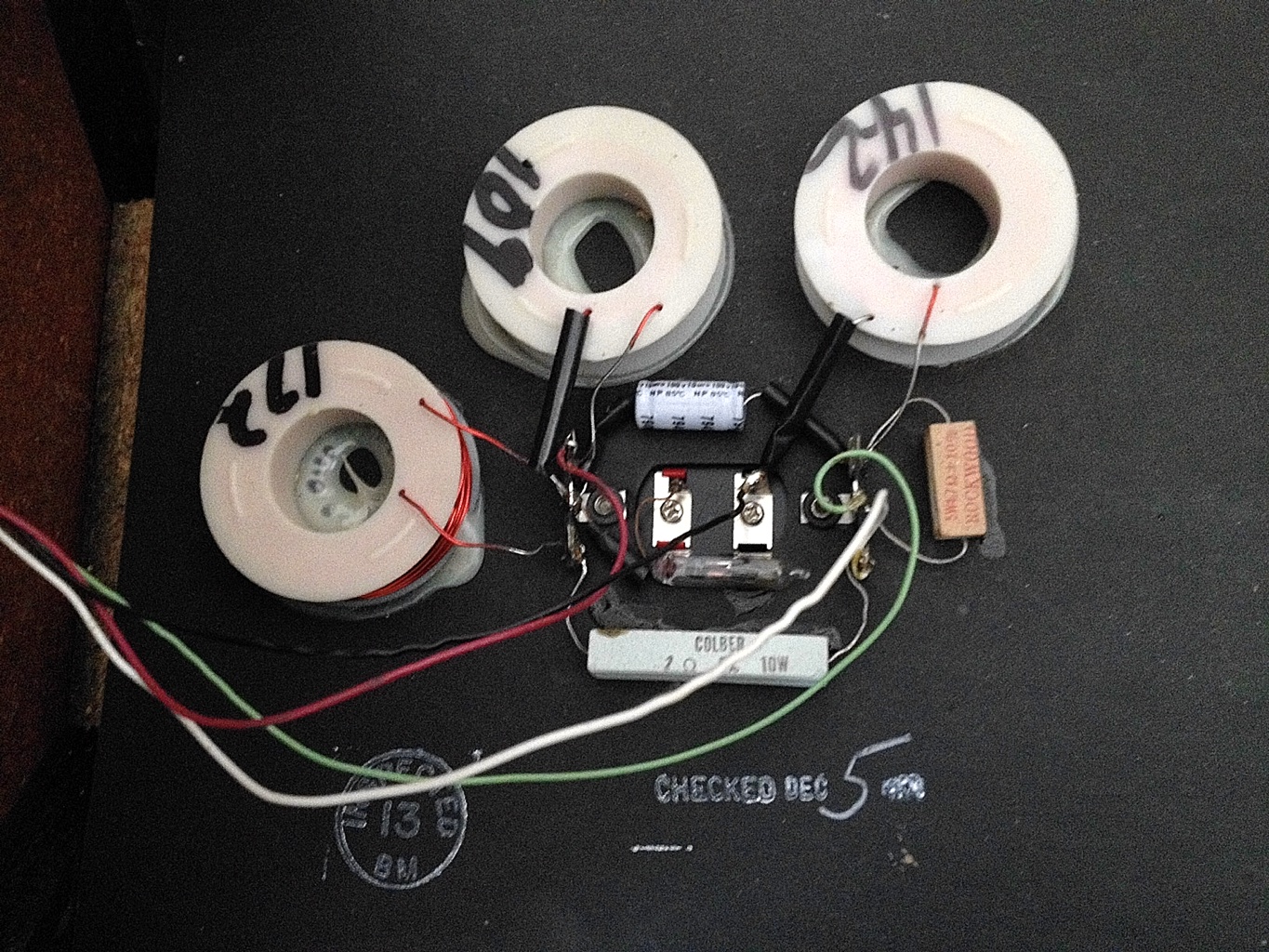

I got a pair of BIC SoundSpan TPR-600 that I got from a friend (who bought them new in the 70s). I was considering an XO upgrade or to go active, so I took a look at the original XO. But I can't wrap my head around it! Please take a look at the attached image. Red wire to woofer, green to mid and white to tweeter. They all share the black as the negative pole.
First of all, the markings on the coils; 109, 142 and 172? 109 can't be 10x10^9 so I'm a bit baffled. But what I find really puzzling is the fact that this 3-way XO only got one capacitor! The total amount of components and their values are; 1 capacitor 10uF, two resistors 2 and 4.7 Ohms, three coils marked 109, 142 and 172. I don't get it...

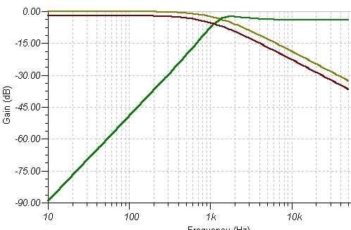

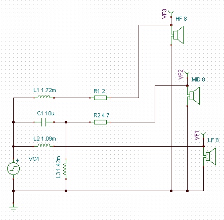

So I stuck the circuit with my assumptions into TINA-TI and ran a simulation. The circuit and the resulting graph are also attached. It sure didn't make me any wiser because it looks like the tweeter got a low-pass filter. What am I missing here? Has anyone ever seen a 3-way XO with only one cap? Or with a cap, two resistors and three coils in total?

I started to write something, but I don't know what the vf1 vf2 and vf3 points are on the circuit, bypass for active??
It certainly doesn't look like a crossover for a three way. Maybe a 2.5 way?? But even if it were a 2.5 way the cap would be on the tweeter not the mid (is that labeled incorrectly?)
If the mid and tweeter labels are swapped then I would say it is a 2.5 way with 1st order electrical on the woofer and mid and a second order electrical on the tweeter...

The VF# are voltage points used to generate the graphs in TINA-TI (has nothing to do with the XO).
I think I got it now. This thread and this page gave me what I needed to figure it out. And this thread is giving me what I need to move forward. Thanks anyway for taking the time.

Pure curiosity (someone labeled them and probably for a reason, I want to know more if possible).Why interpret something irrelevant, when you can measure directly the inductance.

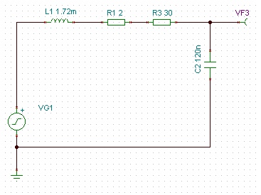

Ps. I have learnt that the tweeter is a piezo and that it would explain the lack of a cap but I still don't get the coil for the tweeter?
I recommend measuring the capacitance of the piezo tweeter (and checking whether the diaphragm is still in one piece or shattered).
In the old days the capacitance of piezo tweeters was an object of controversy since some old amplifiers could not drive it directly without misbehaving.
The inductor, the internal resistance of the inductor, and the resistor can be considered a series network to increase impedance of the system at HF, above 20Khz. The peaking produced by the resonance of the inductor and piezo capacitance could be used too as boost for response correction at 10Khz to 20Khz.
Thank you Eva (will measure). I came to pretty much the same conlusion about the coil simulating with some wildly guessed values.
Schema of simplified eqvivalence of the piezo (the Motorola piezo is supponera to have an internal 30 Ohms resistor), first graph with coil, last without.

This thread @ Audiokarma contains pretty much everything you need to know about the piezo. The ones in the SoundSpan look identical to the ones in KSN1001A and KSN1005, so lets assume it appears as a 0.13 uF capacitor. Lets further assume the coils are 1.09, 1.42 and 1.72 mH and we end up with something like the attached files (lots of assumptions and simplifications but I think you get the idea). A first order filter on the bass with f3 ≈ 1.16 kHz, a second order filter on the mid with f3 ≈ 1.03 kHz and a notch on the piezo with the peak ≈ 10.74 kHz.
