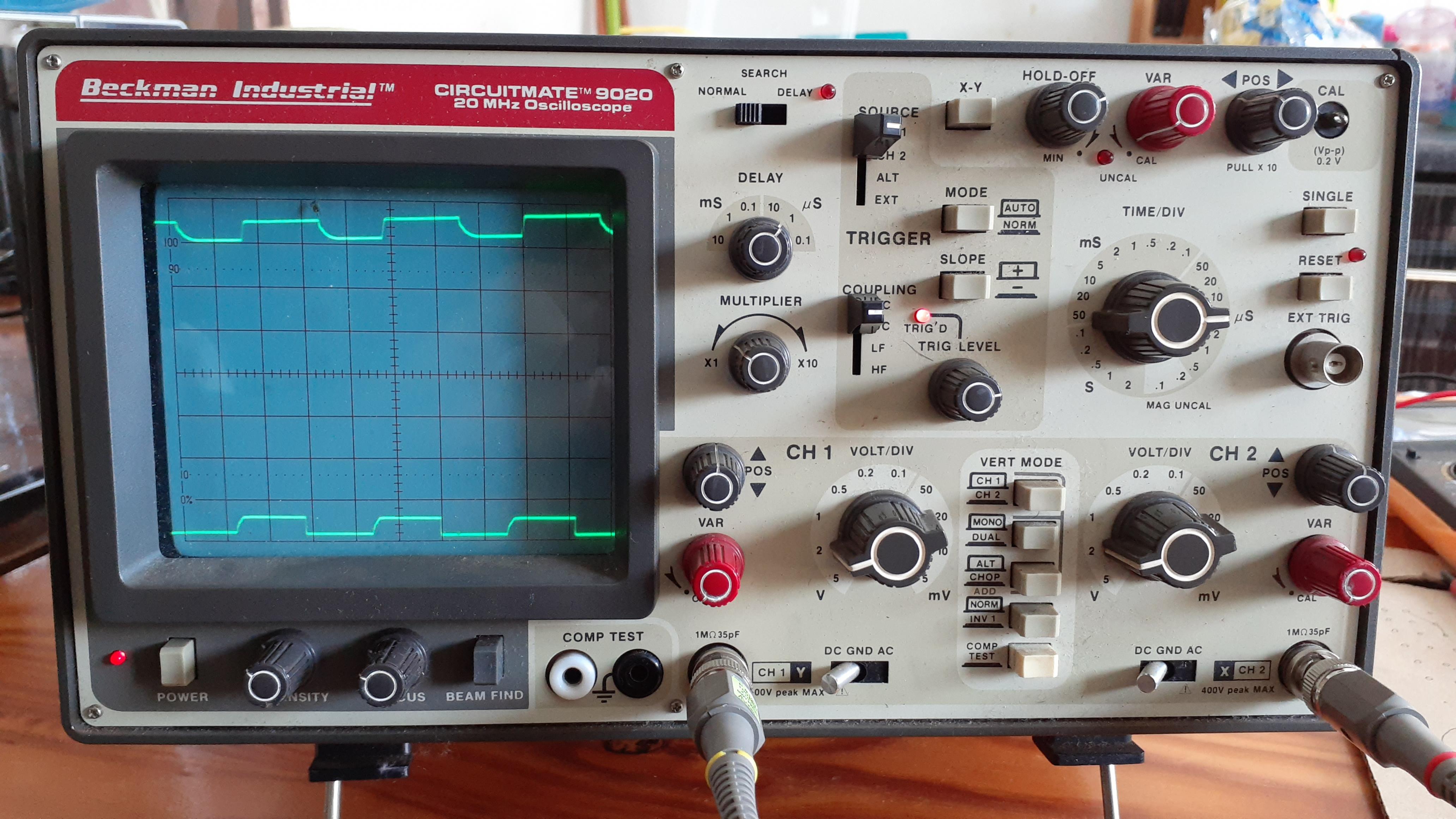

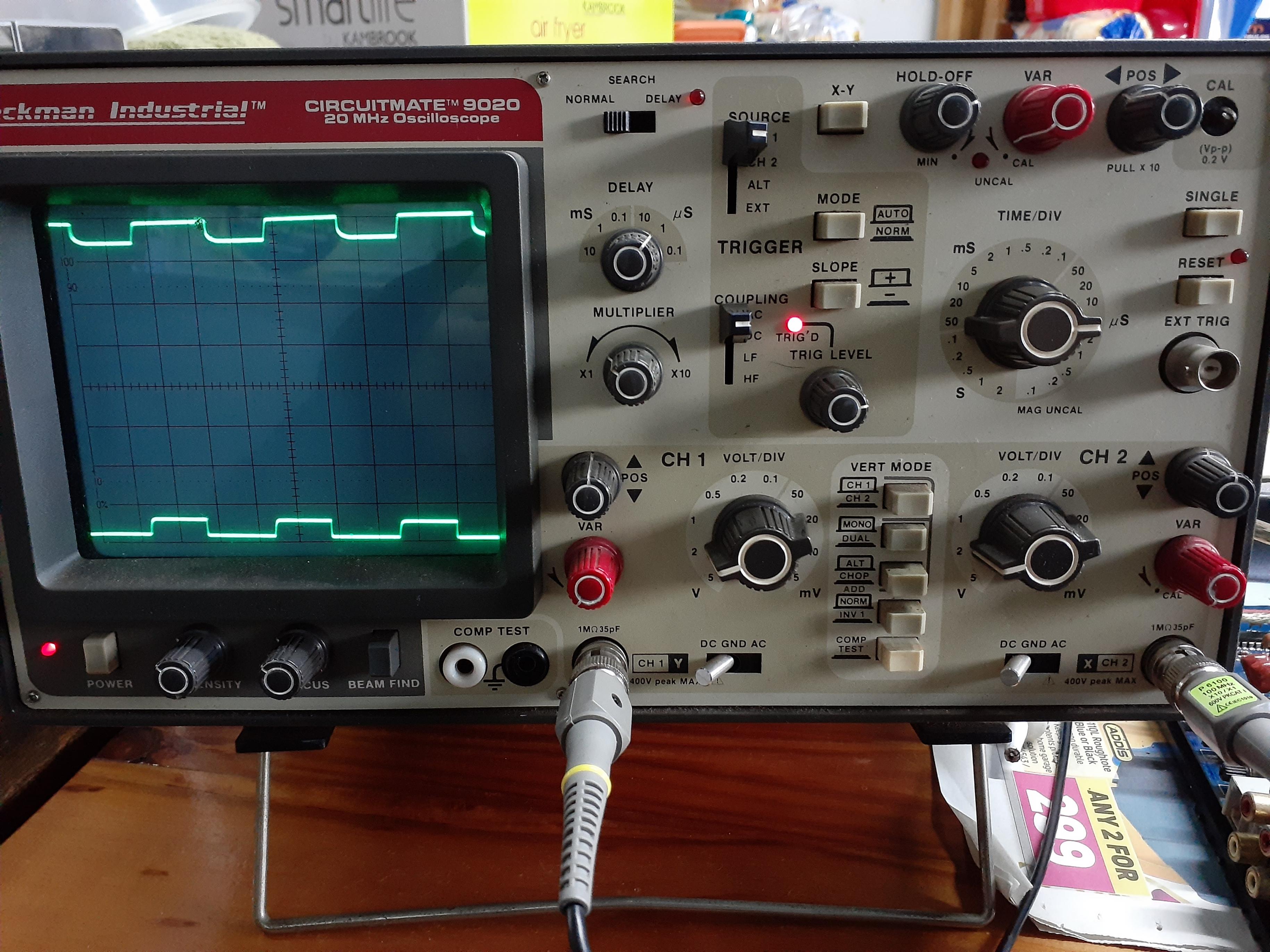

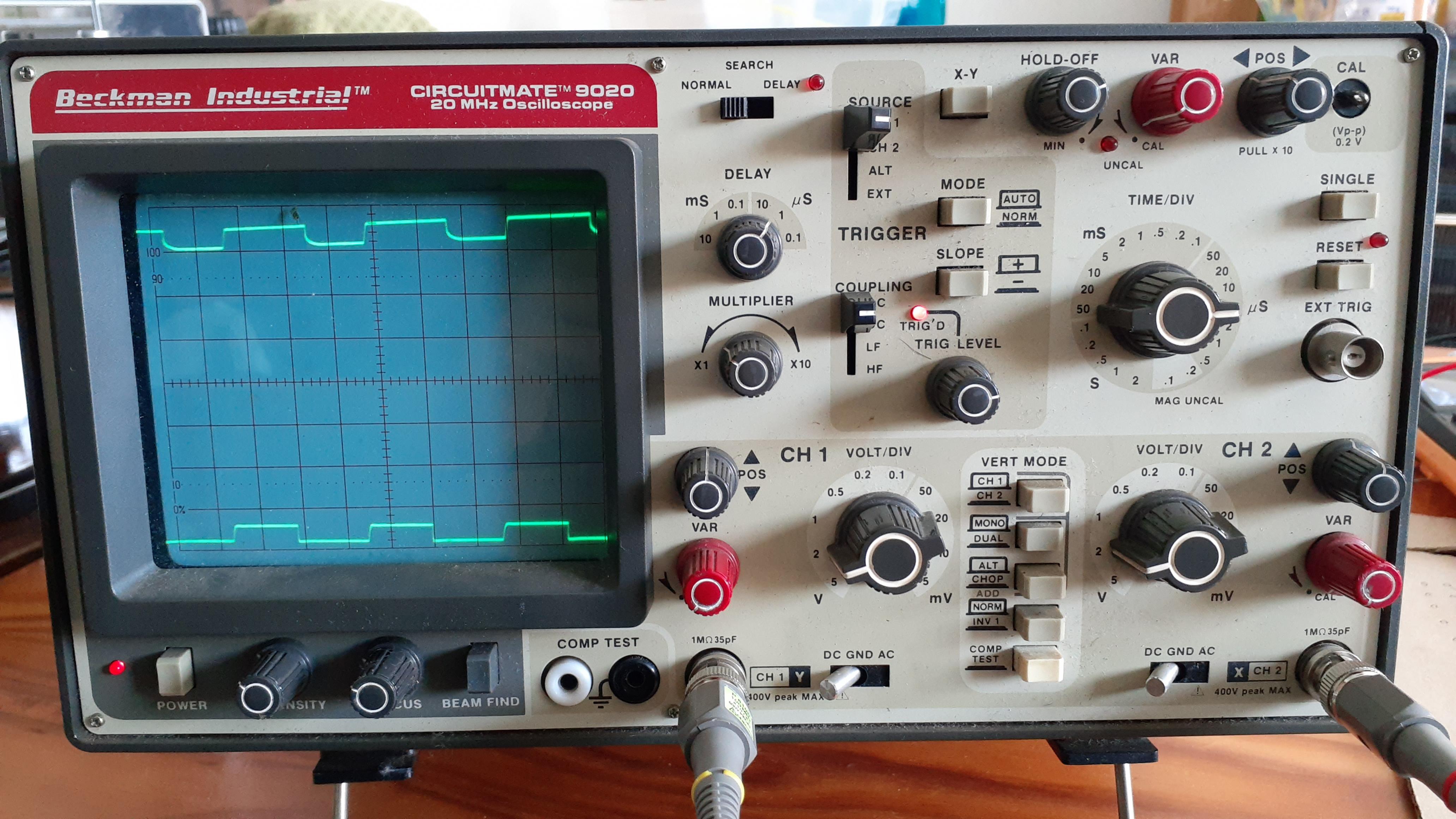

That looks a bit high but the multiplier may not be set precisely to 1.
I think this is basically the same as the following amp. I can't tell you if the driver components are right but you should be able to tell if they're the correct polarity (NPN/PNP) if this is indeed the same type of amp.
http://www.bcae1.com/temp/bp1200p1_sm.pdf
Without the DC component, the drive signals are essentially useless.
There is a trace rotate pot somewhere on the scope. The rotation can also be skewed by a magnet.
If there is no load, the low-side drive likely has problems.
If both channels on the scope work and you have 2 probes, use it in differential mode.

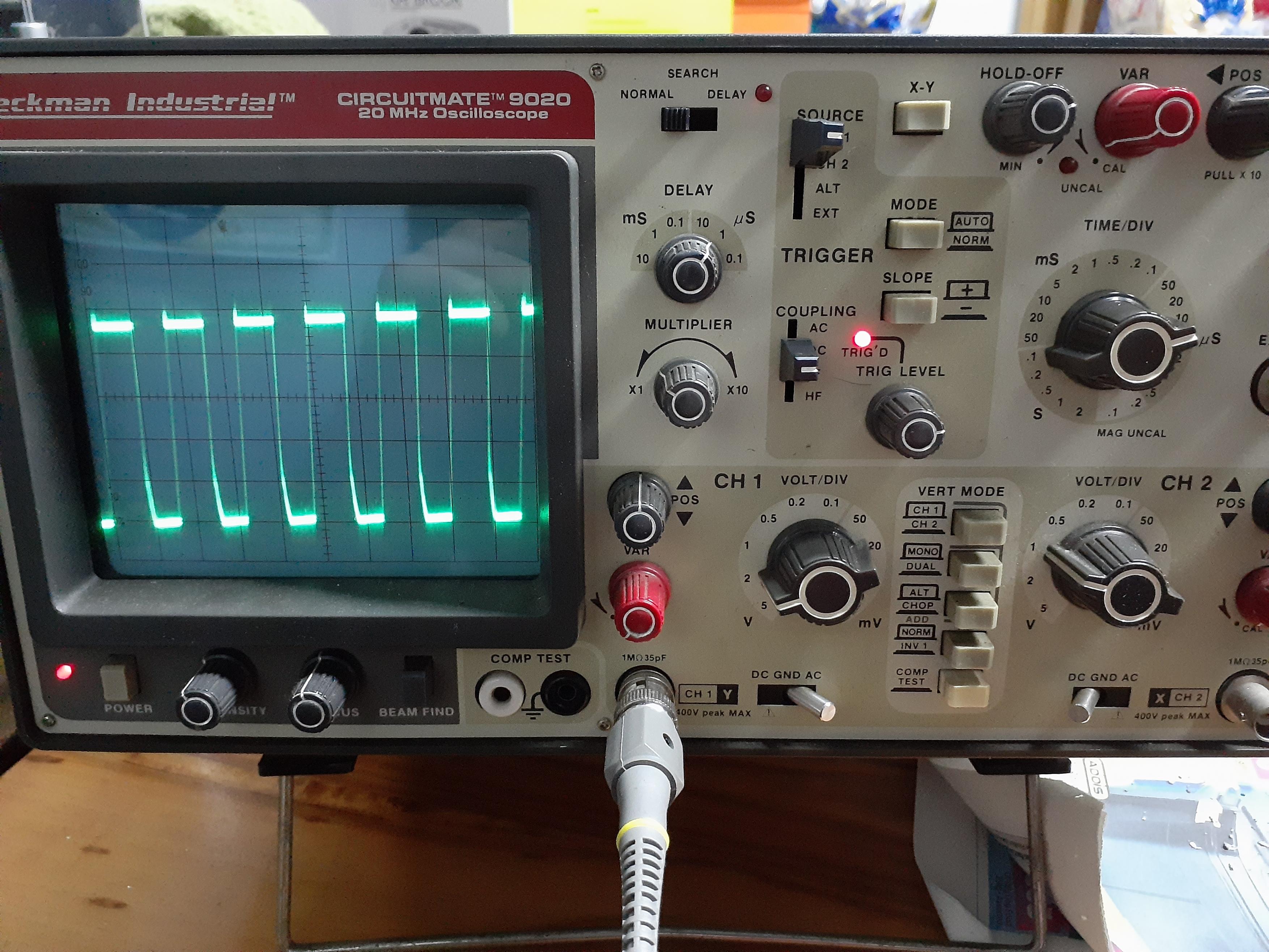

From the frequency, I can see that it's not an input signal This is a clocked class D amp.
The high-side appears to have a problem. Load the FET location that you're probing with something like a 0.010uf capacitor and repost the drive signals.
