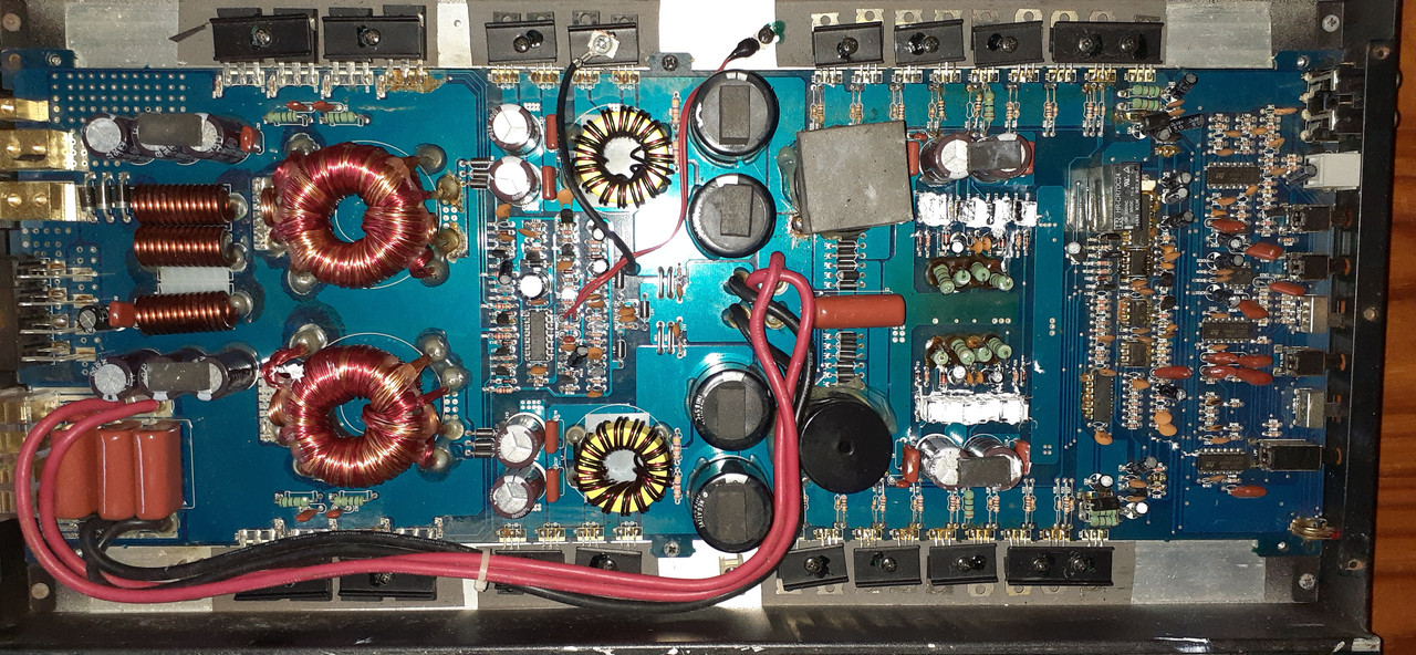

Which terminals of the regulators have DC (look with scope)?
Measure from those terminals to the secondary ground.
#81 should have been rectifiers, not regulators.
Are you saying that you have ±108v from the secondary ground to the rectifiers?
Which terminals of the rectifiers has the DC voltage (center or outside)?
No sorry, I got 108v to the voltage regulator... from secondary ground
the outside legs of the rectifiers have 35v dc
on the source pads of high and low sides I measured 71vdc and -71vdc from secondary ground.

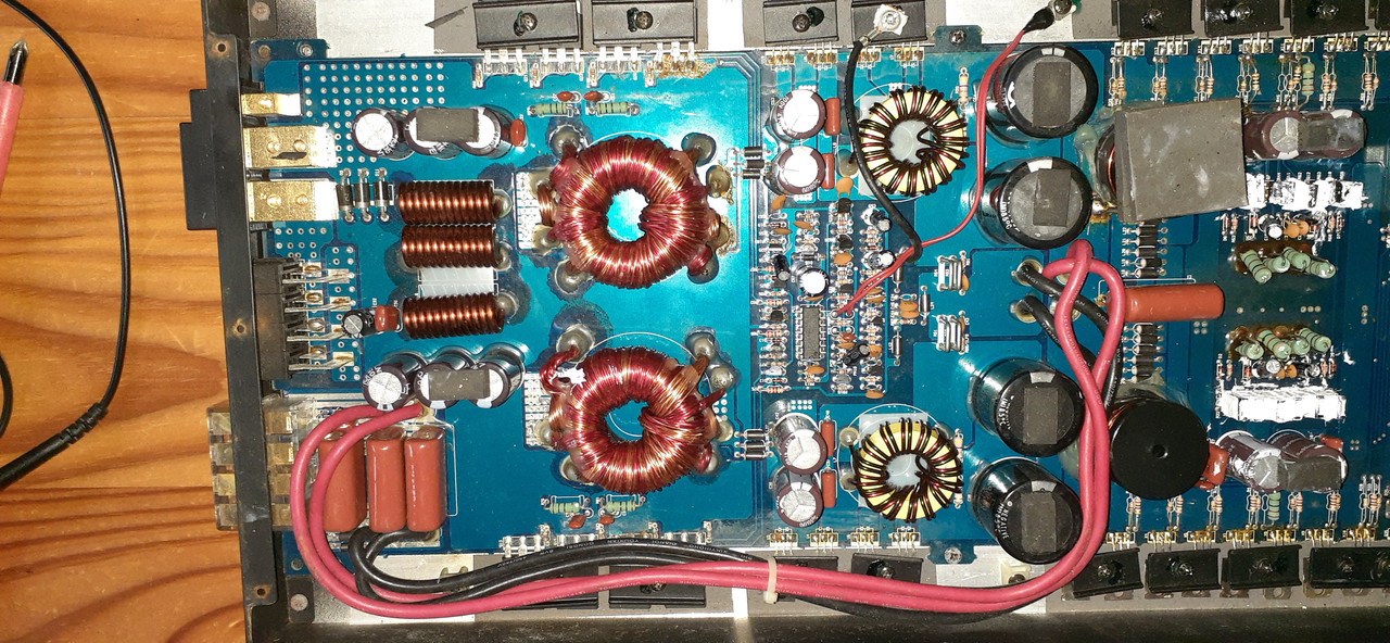

I don't know. For the remaining markings, do you see any other ICs in the amp with the same markings?
Post a photo of the bottom of the board for those components.
