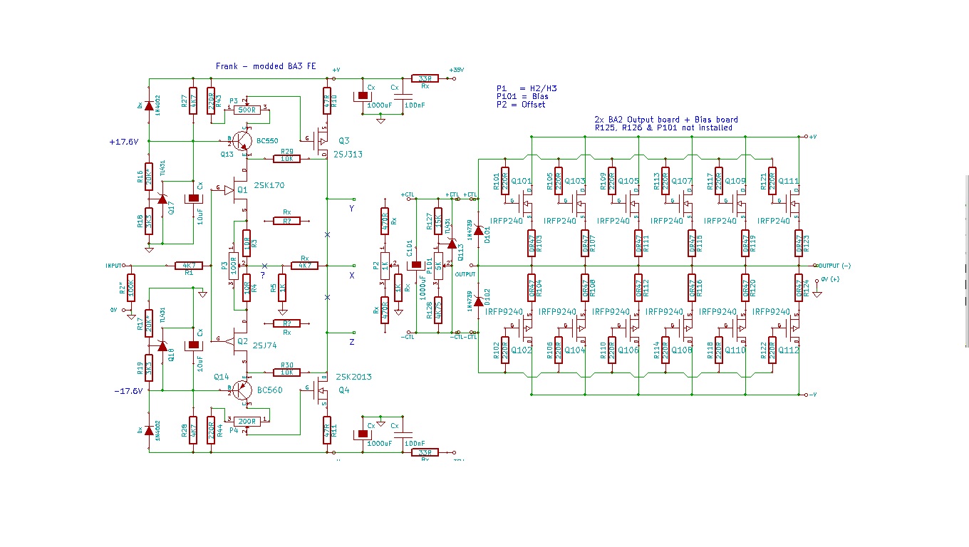

now - see enclosed pic , observe just upper JFets in input buffer ;
I had idea to act as Mighty Tailor Mickey , to swish few flies with one stroke , so decided to limit PSU voltage for little buggers
I chose something as +12V, that with chose Iq per one JFet (21mA/6pcs) is giving approx. 42mW per one , or 84mW per case (having two in parallel)
my general rails are in range of 22V5 (18Vac secondaries , mult. with 1.25)
so , decent BJT is good for that role , even if I could use IRF510 with same results
let's use old but trusty BD139
if I make voltage divider from rail to gnd , letting through approx. 1mA , I'll have enough current for divider itself and for bjt base current
calculating these resistors is hit and miss procedure , but with time one is more and more successful in doing that
so , from these and some other reasons I chose 8K2 up and 12K down
our voltage divider will have voltage level in middle point calculated as 22V5/(8K2+12K) x 12K=13V36
if we connect bjt base there , while we know that emiter of NPN bjt is always 0V65 (one diode drop) lower than base , so we'll have 13V36-0V65=12V74

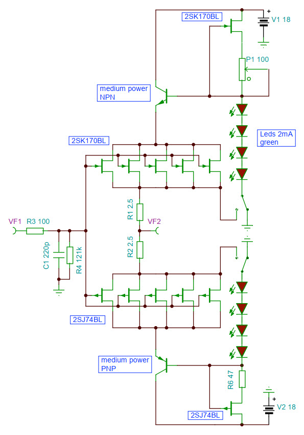

NB that proper and real cascode is actually having voltage divider/string/whatever connected to JFet's source , so shielded part is actually working in constant voltage mode ; that demands much more careful planning of currents involved ( in voltage biasing) , to prevent influence on current path of shielded device
this one is more like voltage divider , voltage umbrella or whatever it can be called , but action is pretty close to modulated cascode ...... even if sorta backwards . because jumping of gate-source end of JFet is actually shorting Uds for same amount
shoot if you need more
691797d1531601137-babelfish-m25-aka-m2-steroids-aka-m2-xa25-bstrd-schm-jpg
what I'm writing about in penultimate paragraph - see this schm , to be clearer
switches for plain voltage umbrella and proper cascode
some calling it Hawksford cascode , but origin is older than Hawksford articles , at least for my knowledge
that one (shielded device having real constant voltage modus operandi) you are going to use if you want to kill Herr Miller for good, which is obviously correct and actual only for stages having gain ........ as first stage of ONO, XONO, Pearl , etc.
