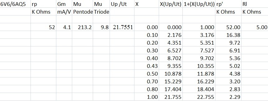

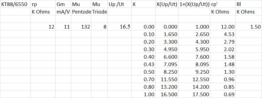

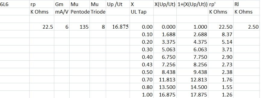

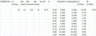

More data showing that the common 43% tap is not always the best. Rudolf Moers has more documentation on this that is even more detailed with lot of theory added but most of it is covered in these two documents. I found the results for the el84 interesting.

EL506,
Thank you for these excellent excerpts of mr. Moers book. They essentially answered my questions in post #9 nicely. This convinced me that I have to own it and I am going to buy it now. If I can just figure out where to get it. Looks like ordering it from the Netherlands?
I did not see mention of “Using a zener between the UL tap and screen changes matters” in the book excerpts as I quickly scanned them. Did I miss it? Could you please restate and explain about the effect of Zeners used in this manner, other than the obvious lowering of screen voltage and thus screen current?
