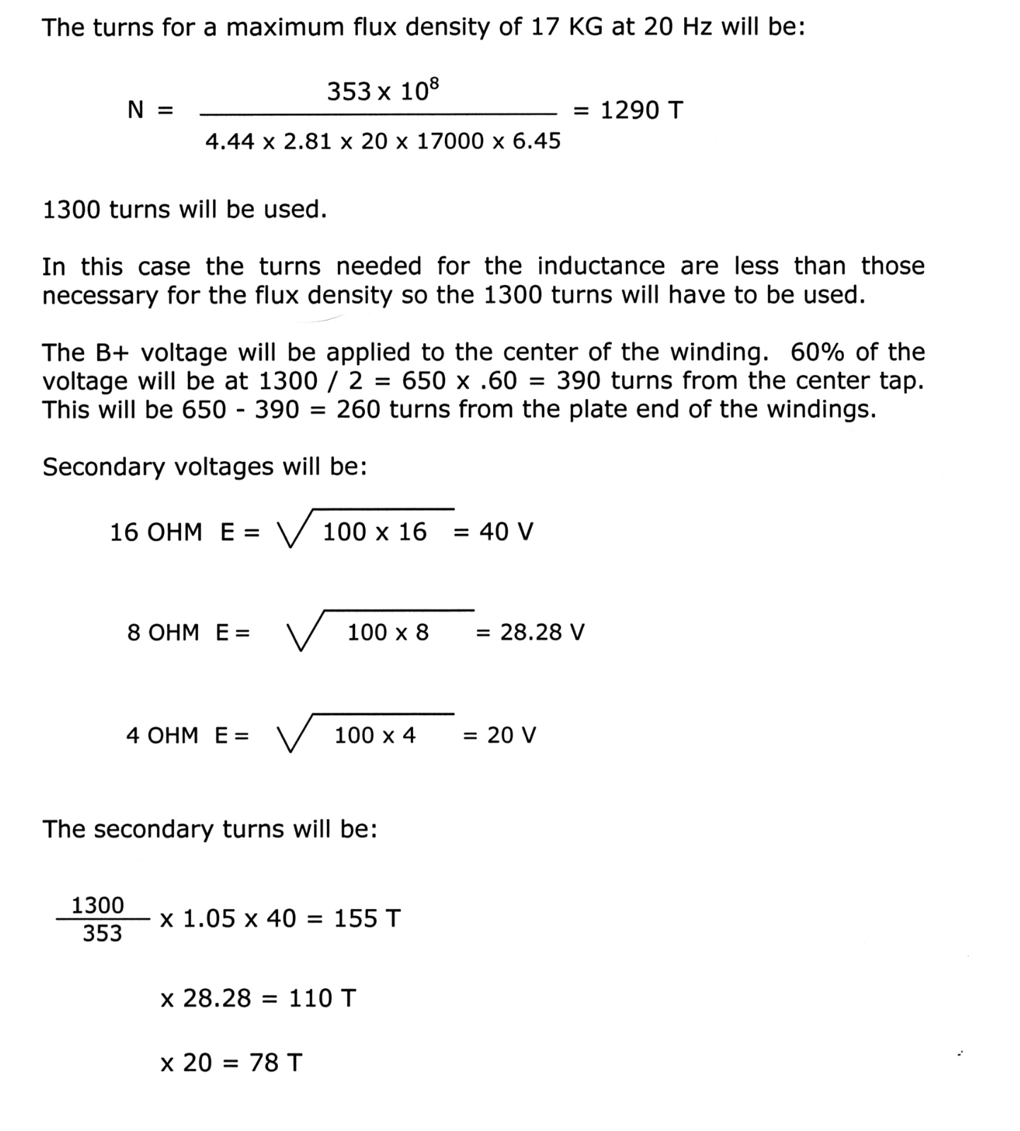

The voltage ratio in a transformer is related to turn ratio , not reflected impedance which is "virtual" and variable with secondary load , not a fixed resistor .
That would imply than if you use 4ohm speakers insted of 8 ohm you change the ultralinear ratio ...
1. Test your ultra linear transformers:
(unloaded)
SE transformer: Connect a signal generator from the plate to the B+, measure the plate to B+ voltage (V1), measure the B+ to screen voltage (V2). 100 x (V2/V1) = Ultra Linear Tap Percent.
Push pull transformer: Connect a signal generator from one plate to the center tap (V1), measure the plate to center tap voltage (V1), measure the center tap to screen voltage (V2). 100 x (V2/V1) = Ultra Linear Tap Percent.
Then, Repeat for plate #2, and screen #2.
Or, push pull transformer method two (quicker and easier):
Connect the generator from plate to plate (center tap not at DC ground, not at AC ground).
Measure plate to plate voltage (V1). Measure screen tap to screen tap voltage (V2).

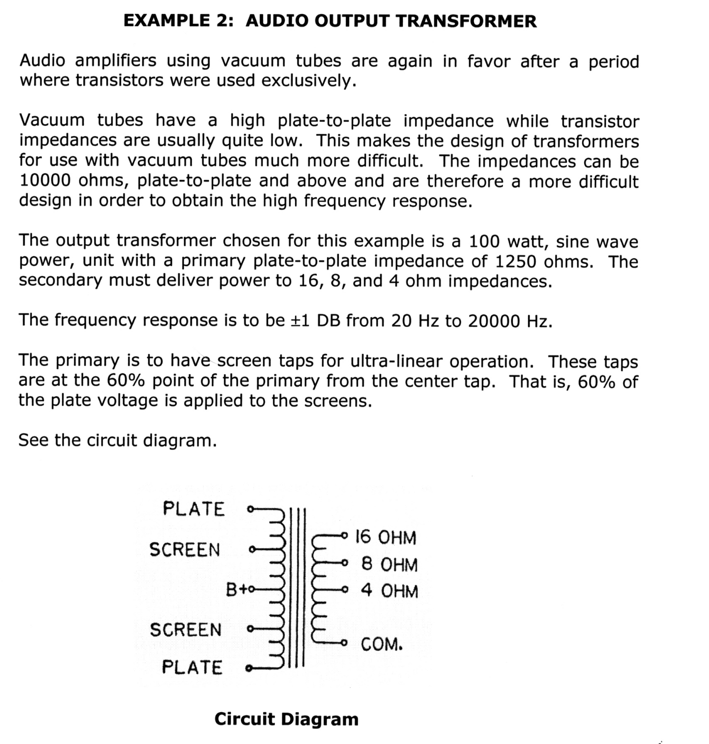

Turns Ratio is the key to the number of percent.
2. Ultra Linear has sometimes been called "Distributed Load". I consider this to be an optimist's view point.
Consider a 40% UL tap. 0.4 turns versus 1.0 turns = 16% impedance versus 100% impedance
50mA of plate signal current, versus 50mA of screen signal current (of course the screen signal current swing will not equal the plate current swing). More likely, the plate will vary by 50mA while the screen is varying by perhaps 30mA.
But even if the plate and screen signal current swings were able to be equal . . .
(50mA plate current swing squared) x 100% impedance has lots of power out.
(50mA screen current swing squared) x 16% impedance has very little power out.
Distributed load? . . . Yes, if you consider plate power to be more than 6 times the screen power that is delivered in Ultra Linear.
Just my opinion.

Most contributors in this thread wrote that "ultra linear ratio" is a turns/voltage ratio of the primary and some backed this up with (references to) literature.
If this is indeed the meaning of "ultra linear ratio" (which I believe it to be) than how can a change from 8 to 4 Ohm as the secondary load change the turns/voltage ratio of the primary? As far as I understand, the "ultra linear ratio" is the same for both the 8 Ohm and the 4 Ohm secondary load because there is no change of the turns/voltage ratio of the primary itself.
Pentode / Beam Power wired mode: 0% Tap
Ultra Linear wired mode: somewhere between 1% and 99% Tap
Triode wired mode: 100% Tap
