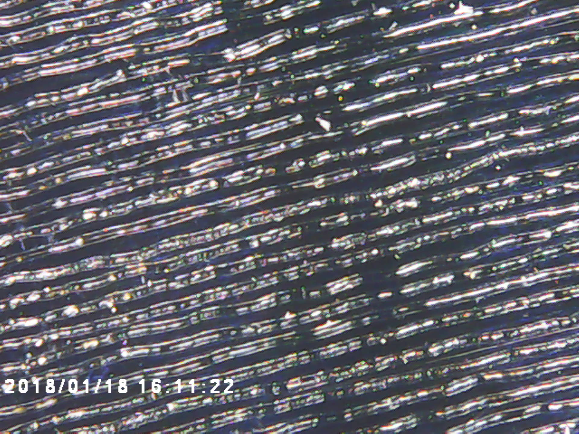

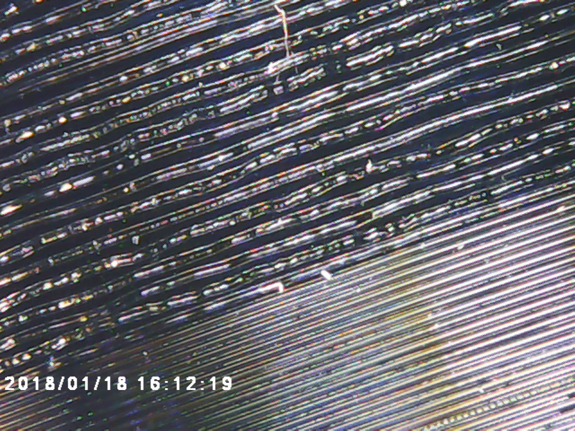

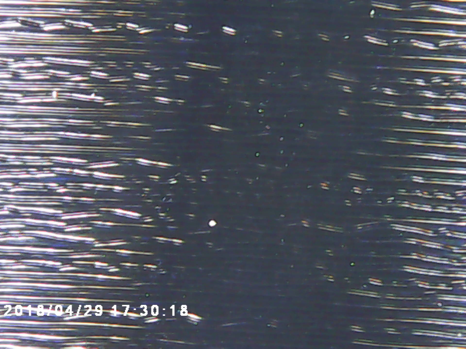

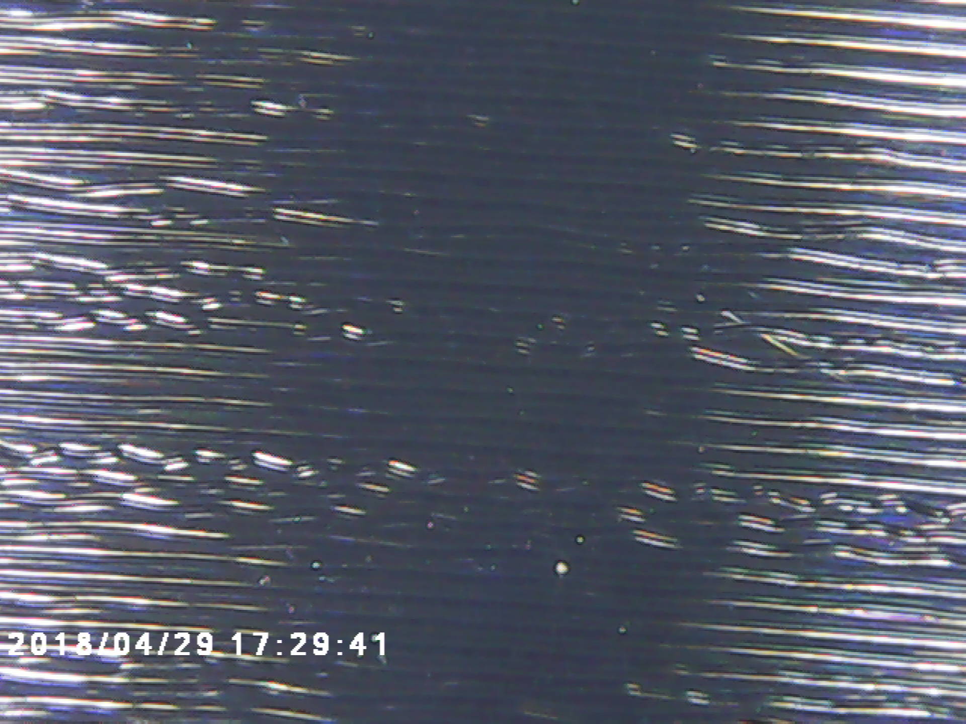

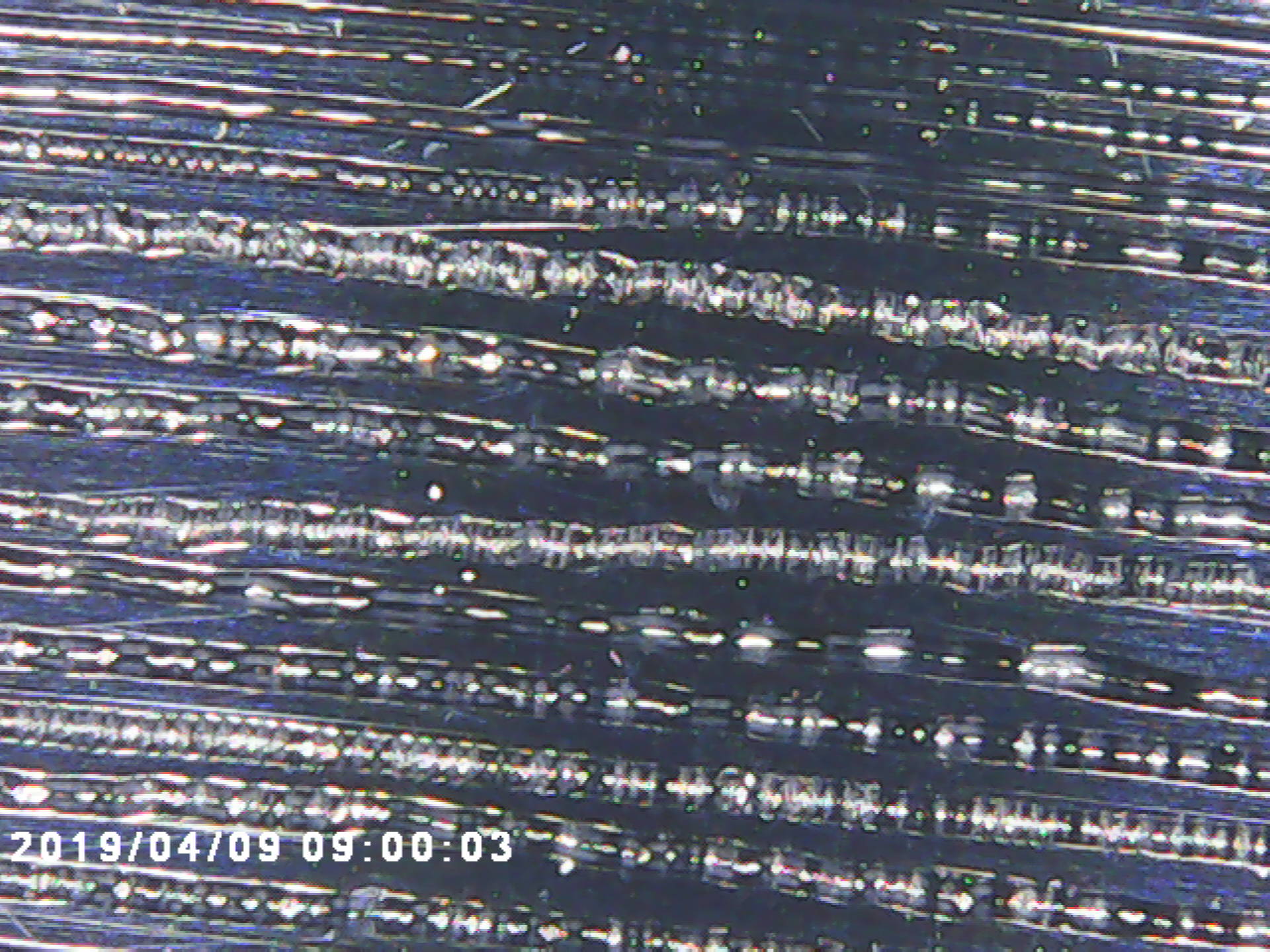

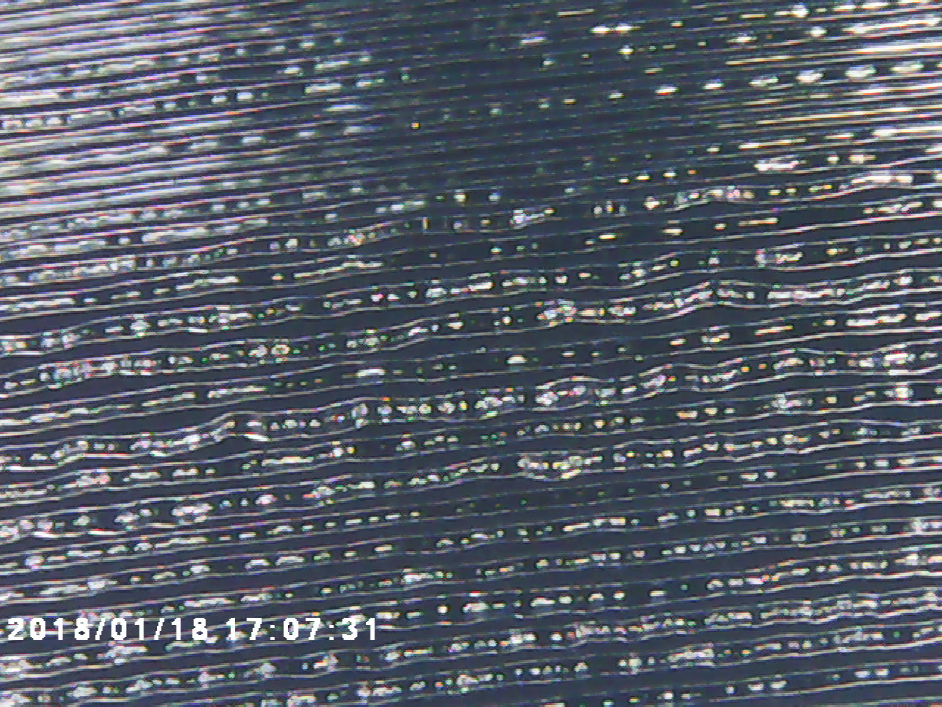

Increased noise with repeated cleaning

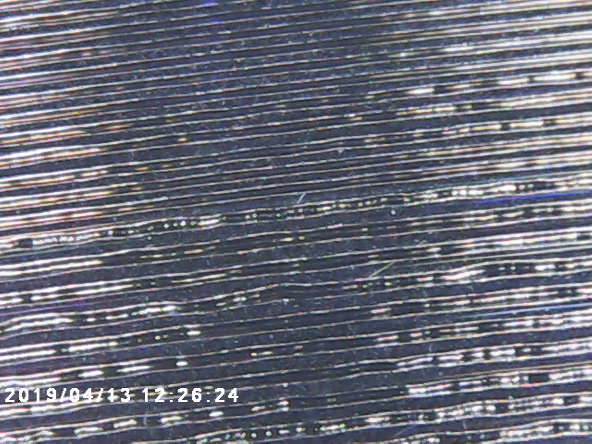

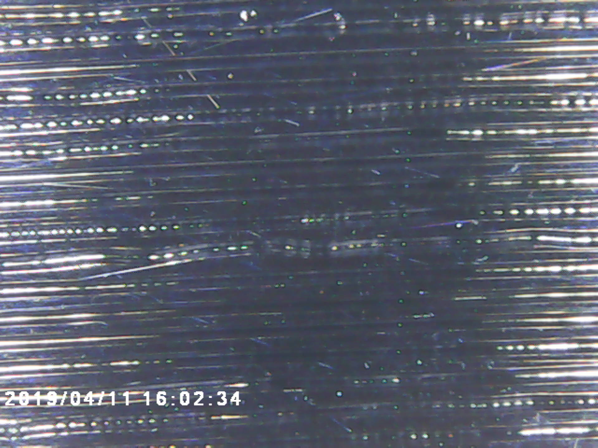

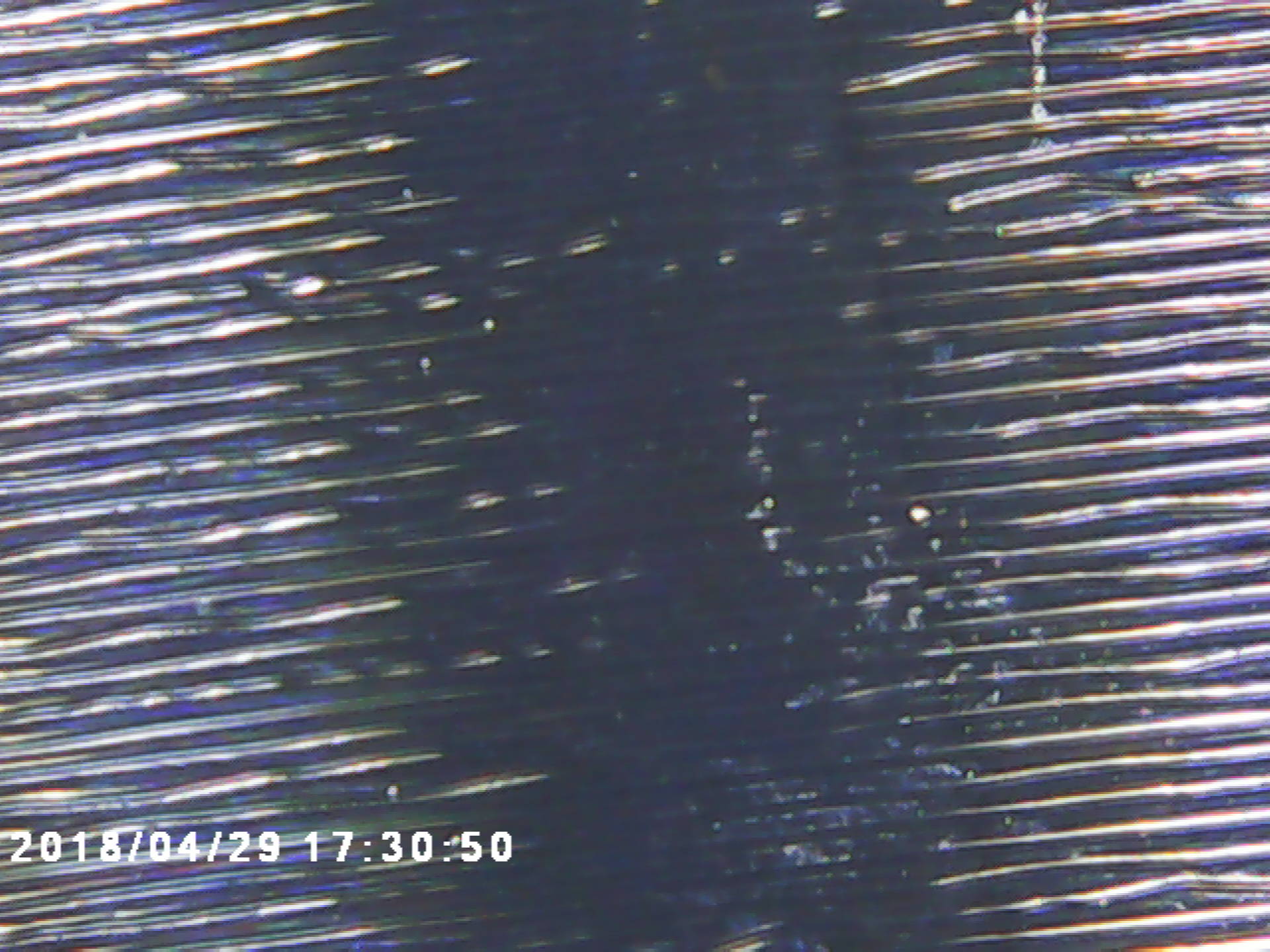

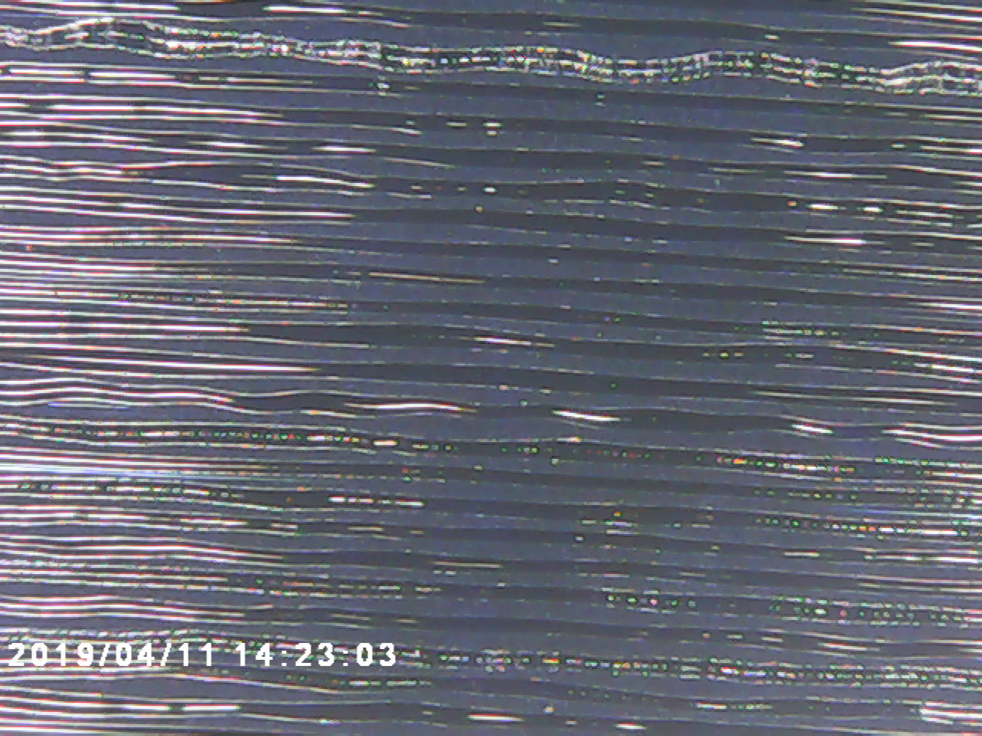

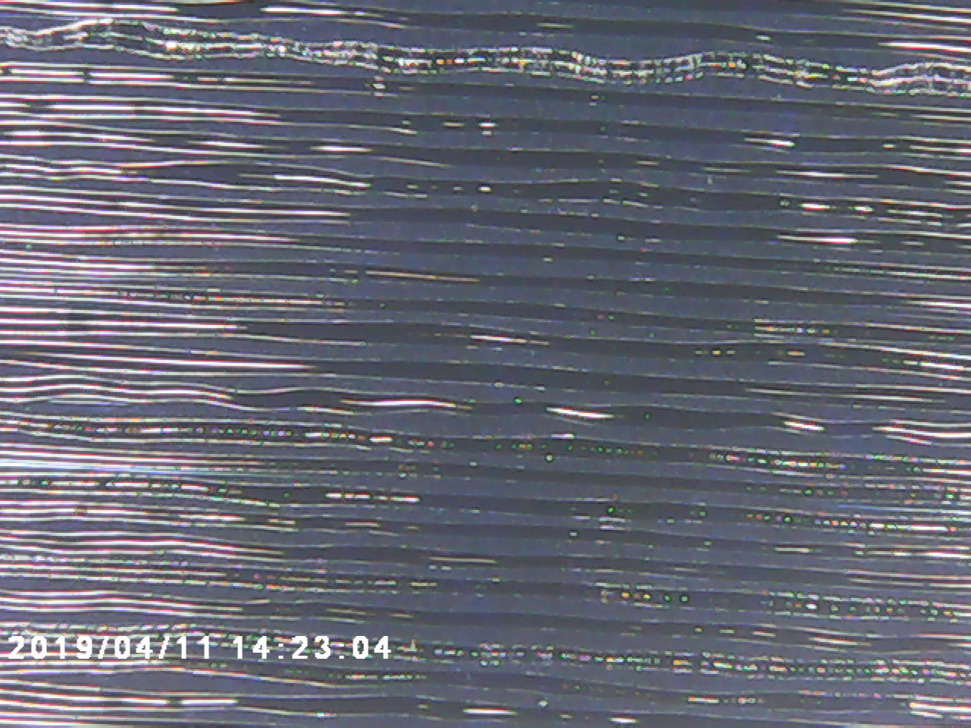

I have read the entire thread and there are a few comments concerning the risks of cleaning induced damage. I use an ultrasonic cleaner together with a vacuum RCM for final rinse and drying. The ultrasonic fluid is de-ionised water IPA 20% plus surfactant (Ilfotol). I have one LP that was recently purchased new. It is the first available pressing (2015) of a recording only previously available on CD (1990). It is 180 gm virgin vinyl from a reputable European label. This jazz recording has a wide dynamic range with some quiet passages and the LP was previously dead quiet but has now developed pops and clicks which appear to be getting worse with repeated cleaning cycles. I can't recall any of the '000's of LP's previously cleaned behaving this way. I don't have a microscope but the surface looks pristine. One factor that makes me suspicious is the inner sleeve is the original. I usually replace them with new thin polyethylene inner sleeves but the original was so nice I re-used it. It is a thicker grade but nice and smooth and the new LP showed no obvious contamination from the sleeve. I have since ditched it just in case there is some issue with it (reacting with nano-traces of the cleaning solution maybe?).
Any ideas what is going on?
