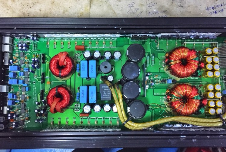

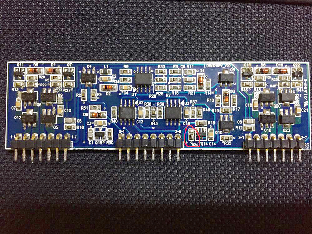

I am repairing a Cadence ZRS C1 mono car amp, i found out no signal to 1 bank of the amplifier section that is why the audio is very weak. Can you please provide the IC numbers of U2 and U3 in the picture of board driver of the mosfet in the amp. section. U1 chip is readable but U2 and U3 i believe was burnt out. Thank you in advance.

Hi Perry, i got the SMD parts, but i did not fixed it yet because i found out that R24 in the picture circled with red was blown also and the markings are erased. Can you please provide me the value of the resistor or mark in it. Thank very much as always with your help.

The Driver board and ouput mosfets (10 in each bank) where removed then I checked the rail voltage on the FETS, I was surprised, why am i getting no rail voltage on the Drains holes but i am getting positive rail voltage on the Gate and Source on the 5 FETs which i believe the HI side and Negative rail voltage on the Gate and Source on the other 5 FETs which i believe is the Lo side. But as far as i know correct me if im wrong, in the Hi side there should be no voltage on the Gate and Source but with positive rail voltage on the Drain and in the Lo side should be Negative rail voltage on the Gate and Source with no voltage on the Drain. But why i am not getting the positive rail voltage on the HI side drains? Does this amp have a different design ? Please enlightened me, I'm just confused.
