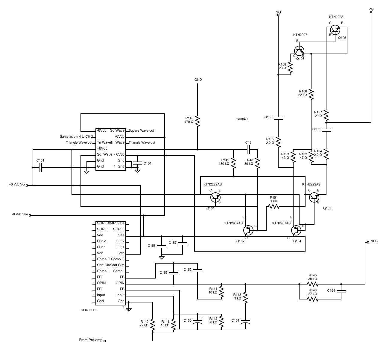

I have traced the components down on the driver board and attempted to place them in a schematic. My first attempt at drawing electrical schematics, so if anything does not look right let me know.
I am pretty sure the problem is that the 14 pin IC, "IC113" in the picture of post 1, is not generating the triangle wave at all on pin 5 and a poor square wave on pin 12 for channel 1. Pins 10 and 7 work fine for channel 2. Of course the markings are gone from the IC and I am having no luck finding an IC with the same pinout. It may be another proprietary IC made by DLogixs, I don't know. Does that IC look familiar to anybody? Any suggestions on something that might work in its place? Would a function generator or oscillator be the correct name for it?
I found the attached diagram after my last post in this thread. It's likely similar to yours.
When drawing a diagram, the components that are connected to the positive voltage sources are generally above the ones that are connected to ground or the negative supply. There's no reason to redo your diagram.

The DL201, IC2A and IC2B, in the schematic you provided appear to be the same pinout and function as the IC in question. Cadence has been of no help and DLogixs email on their website is not valid. I cannot find anything on a DL201 while searching.

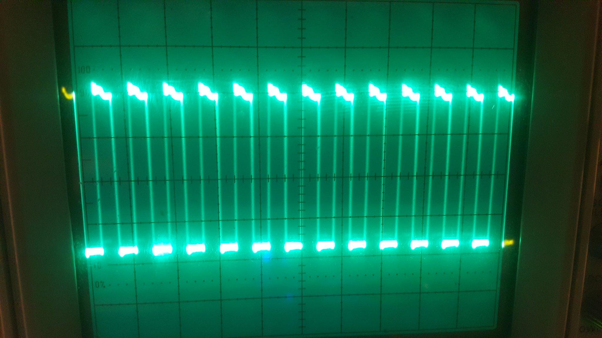

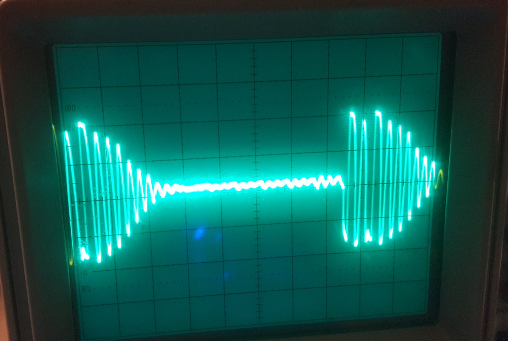

I am back at this one again. I am to the point of swapping parts/ICs, but before I do I thought I would post post a couple of pictures of the drive signal I am getting on the drain of the output FETs of the the bad channel left and good channel right. Hopefully this bad signal looks familiar to a problem someone else has had in the past.
I do not have a good triangle wave to be input to the comparator on the bad channel. Still not sure if the problem is one of the ICs (DLI4050B2 and DL201) or components in the drive or feedback circuits.
I have managed to get audio out of the bad channel but it is attenuated with respect to the other channels and has quite a bit of static on it.

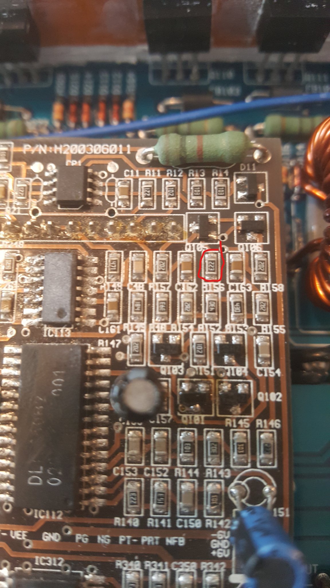

While poking around I found that when I put my finger across the 22k resistor the audio clears up. I then, with a current limiting bulb in series with b+, when I probe across the resistor with the leads of the dmm turned off the channel clears up. If I turn the meter on to check voltage across the resistor the amp draws excessive current. I took the current limiter out so that I could get an idea of the current it was drawing and now the amp is in protection mode with at least one output fet blown.
After I get the amp out of protection, what could be causing the channel to work while touching the resistor?

It is R156, circled in red in the picture.
It is located in the upper right hand portion of the drawing and connected to both emitters of Q105 and Q106.
It is in tolerance (22K), checked in circuit.
I checked all capacitors on that channel (on the driver board) and compared them to the corresponding caps on the other channels on the driver board. Checked with an ESR meter while in circuit. The majority of caps are surface mount with no marking as to values.
I'm guessing it's R24C.
Does the software you used have 'rubber bands' to allow you to reposition parts without breaking the connections?
If you lay tape over the resistor, does touching it through the tape make a difference?
If you tape off ALL of the other local components so you can ONLY touch that resistor, does it still change the way the amp functions when you touch the resistor?
I don't understand what is meant by R24C.
Are you referring to the software I used to draw the circuit diagram? If so I don't remember which one it was, it was a free one I found on the internet. I will look and see if I can figure out what the name of it was.
When I put the dmm probes across the resistor with it set to Vdc, the amp suddenly drew a lot of current and destroyed an output fet at the least and amp is now in protect and will not run. I will try and get it back running and then try the different steps using the tape.
I see, yes it looks like it corresponds to R24C. The surrounding resistor values in the EA4150D diagram are different than what is on the driver board that I have but there are defiantly similarities to the board I have.
When I drew it, It is obvious that I didn't know what I was doing, I just tried to have some way to keep up with all the connections and values. I drew it out in a way that mimics how the components are literally laid out on the board.
I will see if I can re draw it to better match the EA4150D diagram.
I was thinking if I can figure out the name of the program, I could then look it up and determine the features associated with it.
